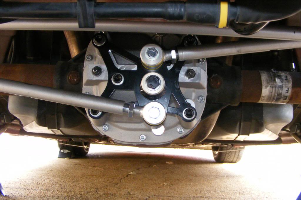

Panhard bars prevent side-to-side movement in leaf spring suspensions. There have been several companies that make custom setups for Lightnings over the years I've owned them. My Lightning currently has a BroncoBeater panhard bar on it. I could tell the difference after I mounted it. First pic is when I first installed it with stock shocks and diff. cover. Second is with QA-1 shocks and a TA cover on the differential. Third is with the recent Mag-Hytec cover.

While a panhard bar may not be necessary, after putting it on my L I could tell the difference the first time I took it around my favorite curvy road. And the amount of lateral movement isn't much, likely a half inch or less. Another nice thing is that on Lightnings, every one I've seen, the driver's side rear tire is tucked further under the fender than the passenger side. With a pan hard bar, I was able to adjust that so they are both equal. On Lightnings, the drive shaft is off center to the passenger side, as is the differential center. It's no big deal, I just never liked how far under the driver's side tire is compared to the other side. A little preload on the bar, and it's fixed. Now, if you think that's bad, on NASCAR vehicles, they adjust the bar while driving.

If you look at the traction bars on my Lightning in the pics above, the way they mount basically turns the rear suspension into a four link of sorts. The front and rear spring mounts are two, the front and rear of the long bars the other two.
