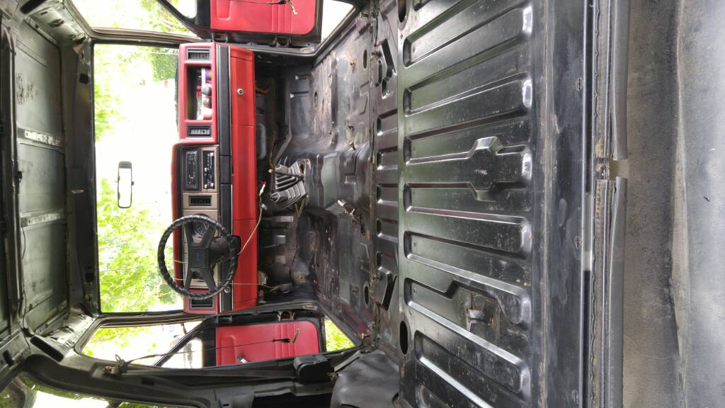

So I've torn apart the interior in the BII and getting ready to prime the bad spots before Fatmat goes in. Weather willing lol. Lots of rain here lately. Then new carpet, headliner and refurbished XLT interior trim.
Does anyone know if there should be plugs in this part of the flooring?
Sent from my LGLS991 using Tapatalk
Inside the first hole is another under the floor. Lots of dirt and road grime in there.

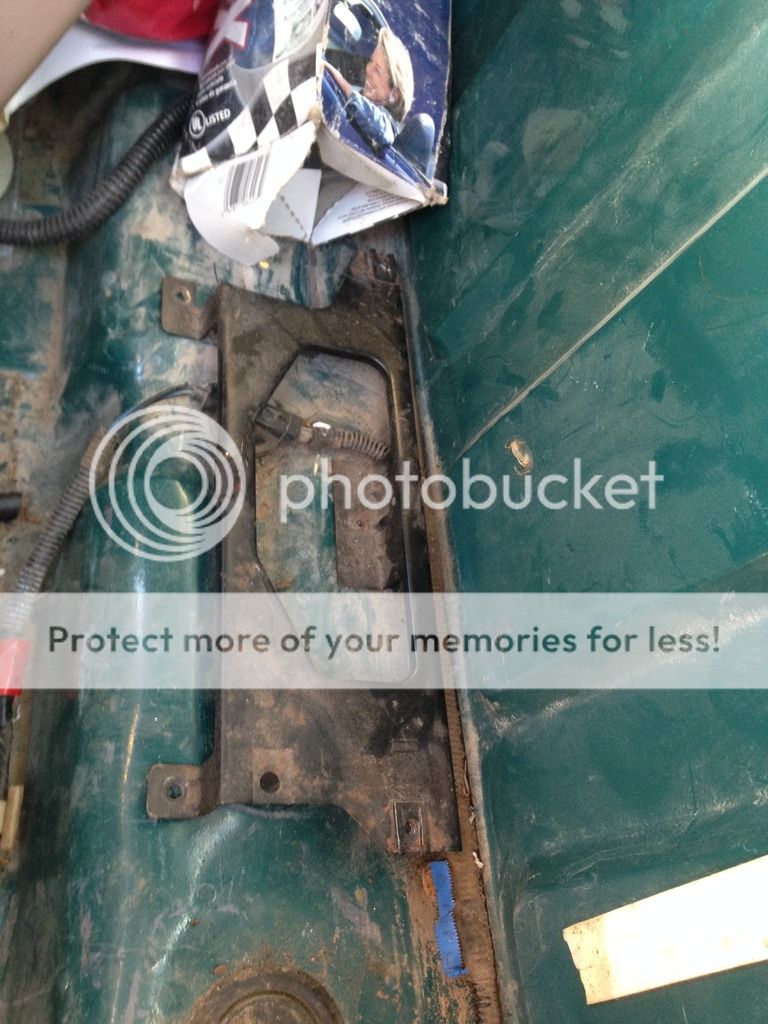

My Ranger has rubber plugs like that for where the cab mounts are. Not sure if BII's do too or not.
I don't have any specific pics of them, you can see one by happens chance in the bottom of these pics.
There's metal ones for under the carpet on the first hole . That's where the body mount bolts are. Didn't see any for the one under it. Might have to find something for it after I clean under the panel.
