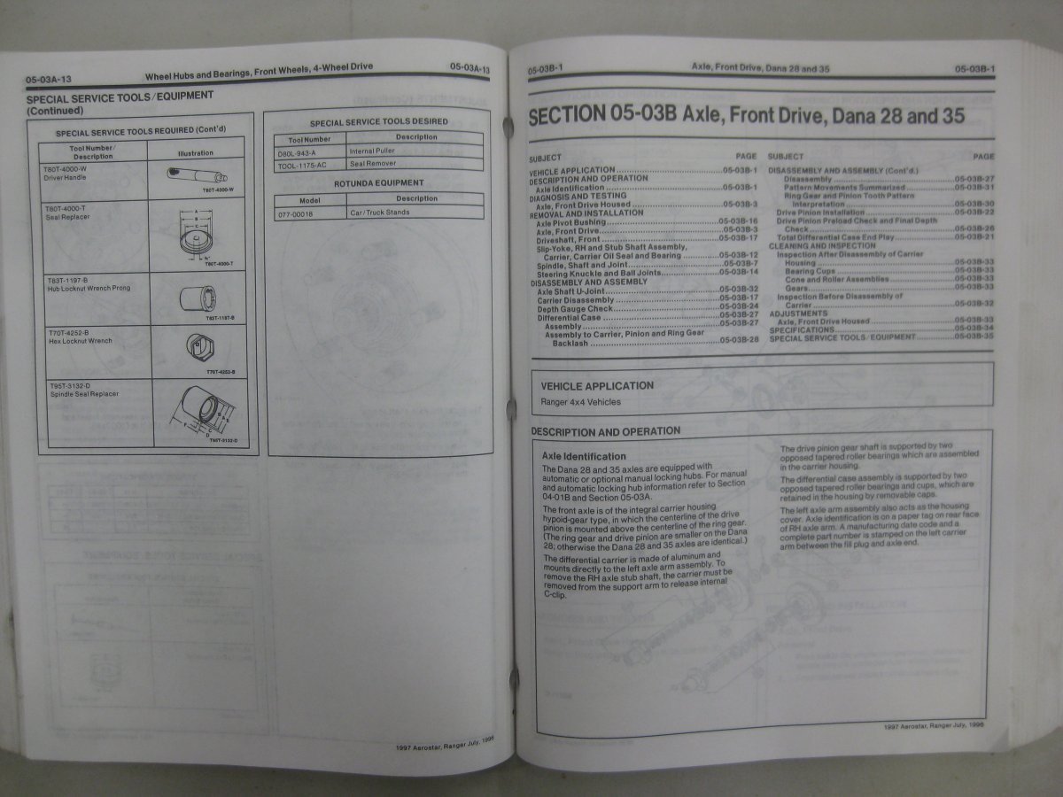

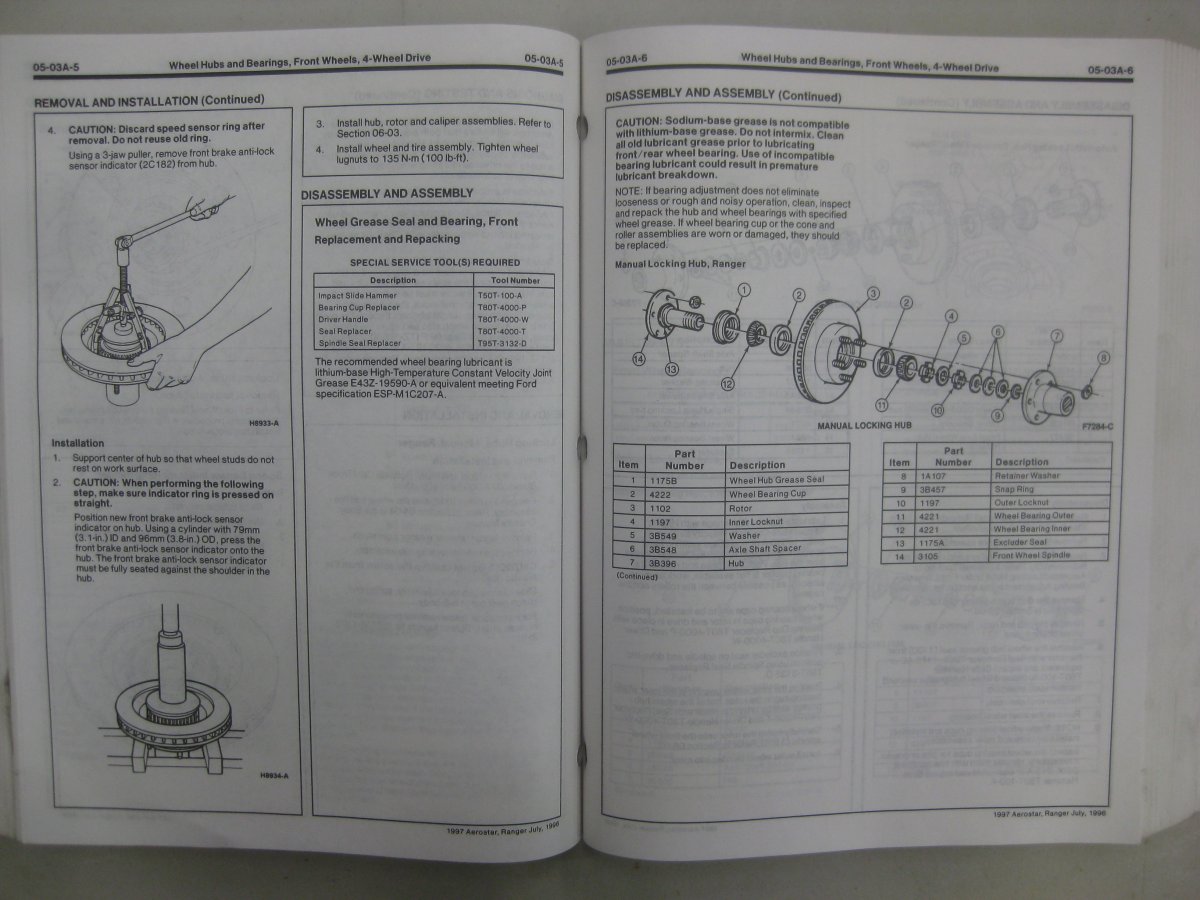

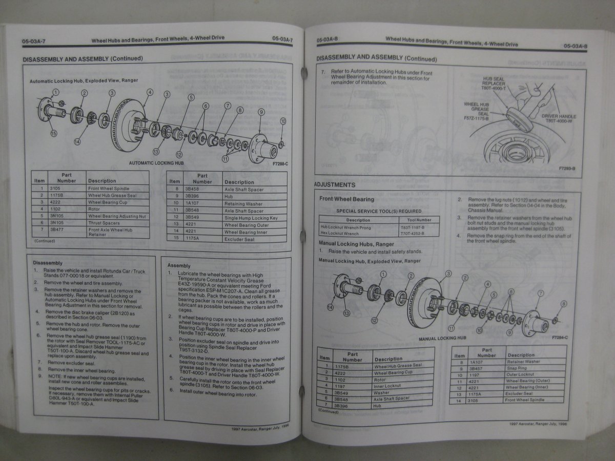

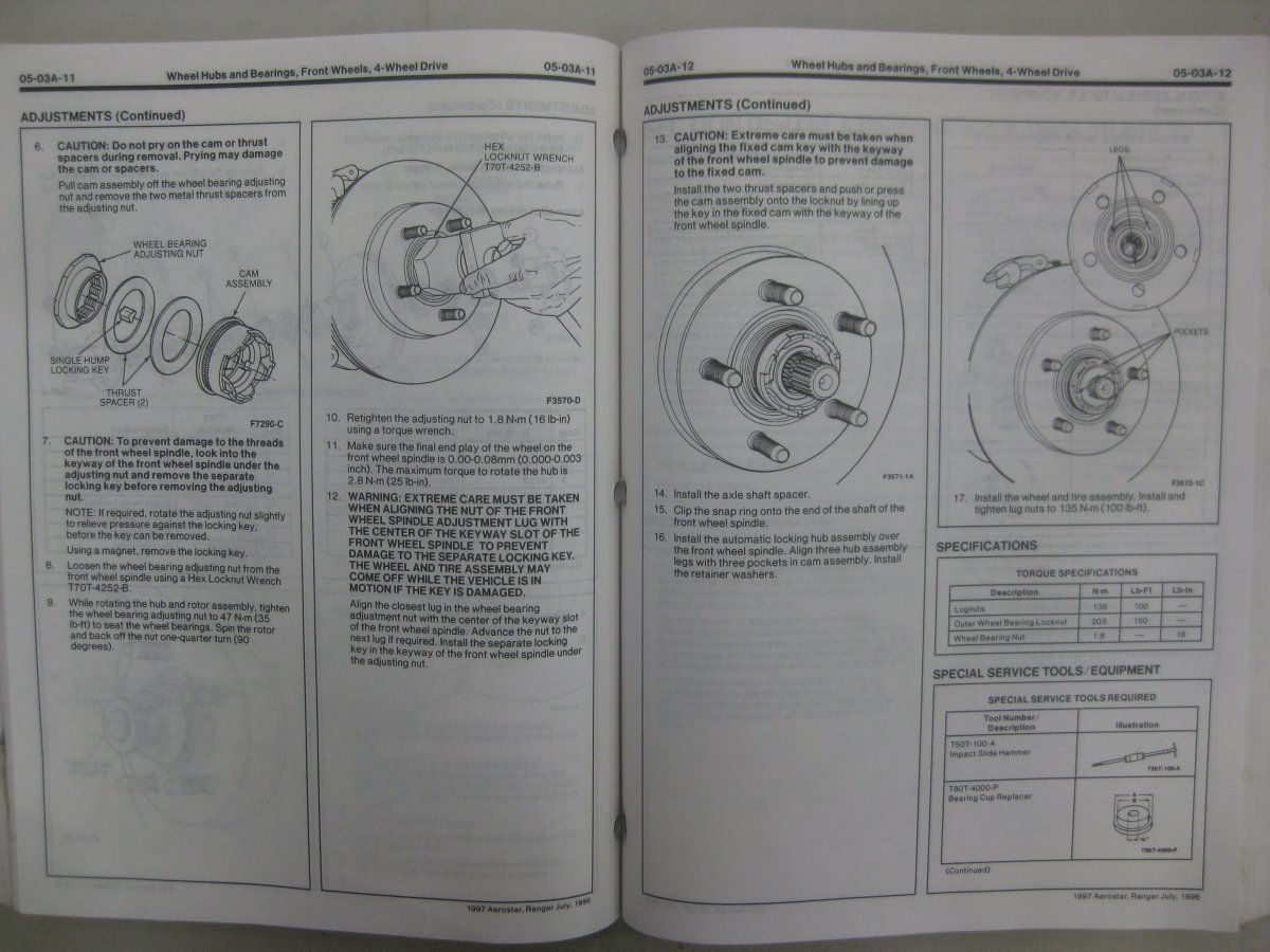

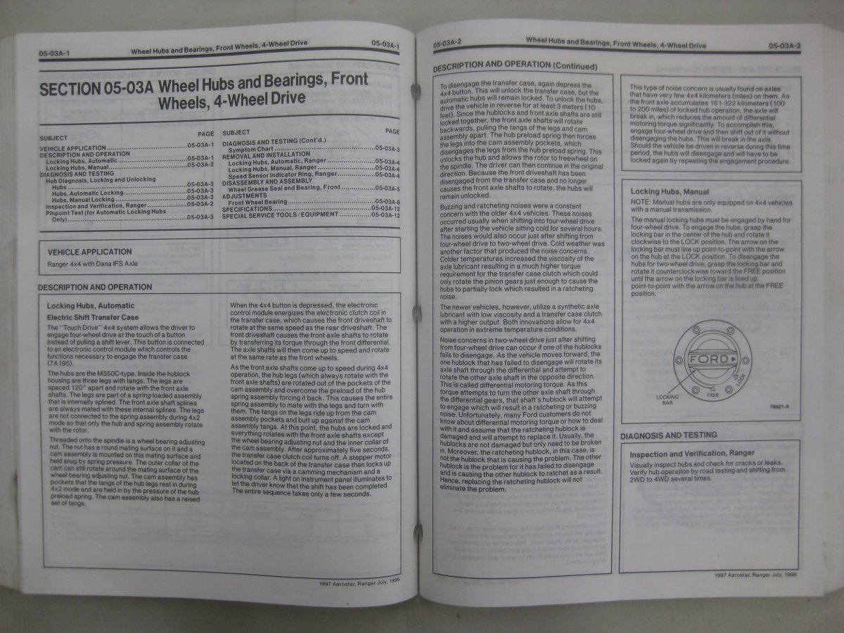

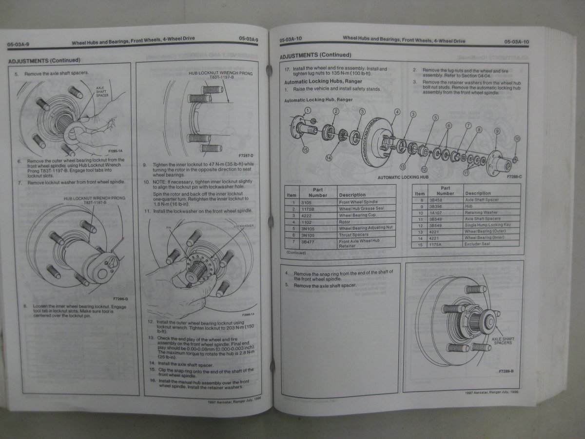

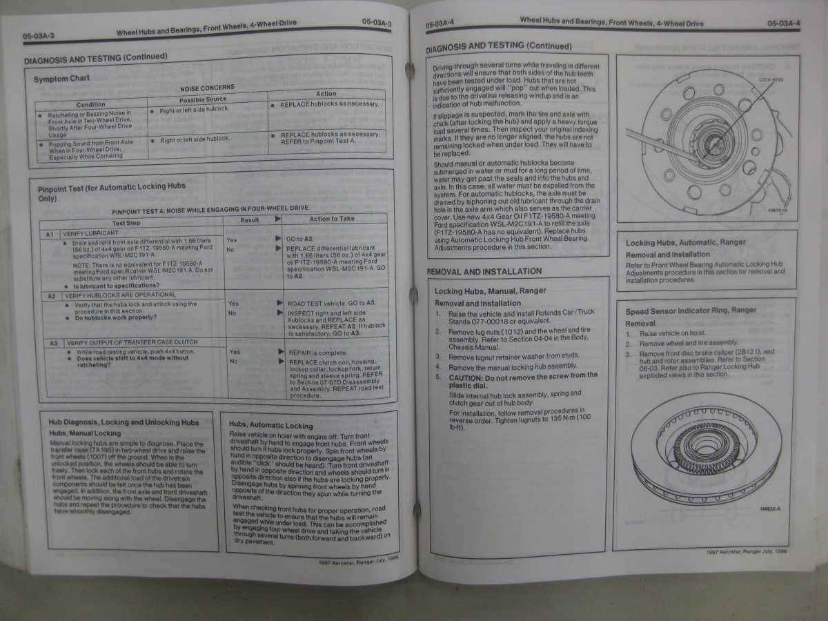

Toyo tires. Manual HUBS.
1997 Shop manual about the hubs and bearings
  • Toyo tires.  Manual HUBS.

I’ve never heard of a manual locking hub for a rear axle. That raises some questions in my mind.
I don't know if any came stock, But I do remember (20+ years ago) helping my neighbor converting his CJ5's rear end to locking hubs.
There was a kit that converted the stock rear end to a full floater, disc brake and locking hubs, we did it over the weekend
Manual hubs came stock that gen 97 anyway.
According to shop manual.
Rear end redo sounds really good. Do you have pics or writeup?
