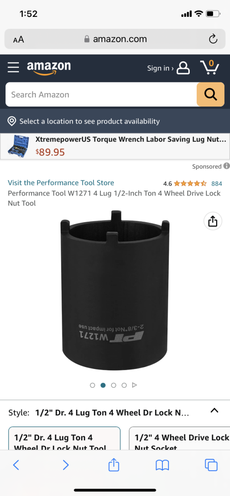

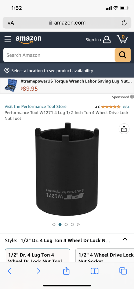

Need the hub tool. $13 to $40 depending what design. I think it's this one, right? Says it fits.
FORD Performance Tool W1269 Performance Tool Spindle Nut Wrenches | Summit Racing

I have a hub socket of that style. But I think I found it didn’t fit or was somehow harder to use. I use one that looks like this. I could get size measurement at home tonight.

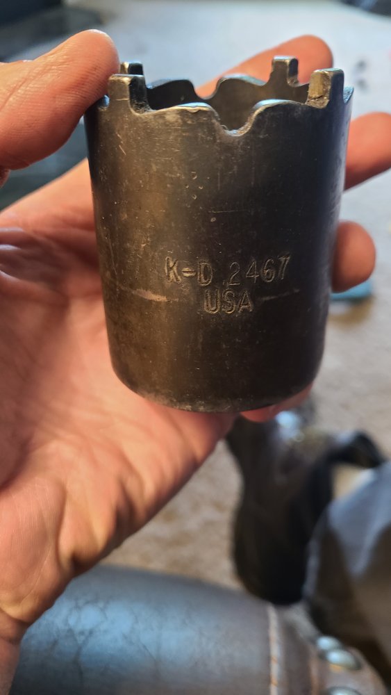

I promised more info. Here is the socket I actually use. 2" ID, almost 2 3/8" OD. You can see the brand and part # in the pic. This stays in the toolbox in the truck. I may have another in my junk yard tool bag.
Oh yeah that's the guy. That looks like a rugged one too. Thanks.
Not sure what the curly parts do if anything I don't see them on others.
Some, the pitons look kind of cheap. Some have the pitons inside the surround which would be rugged but they are way expensive.
