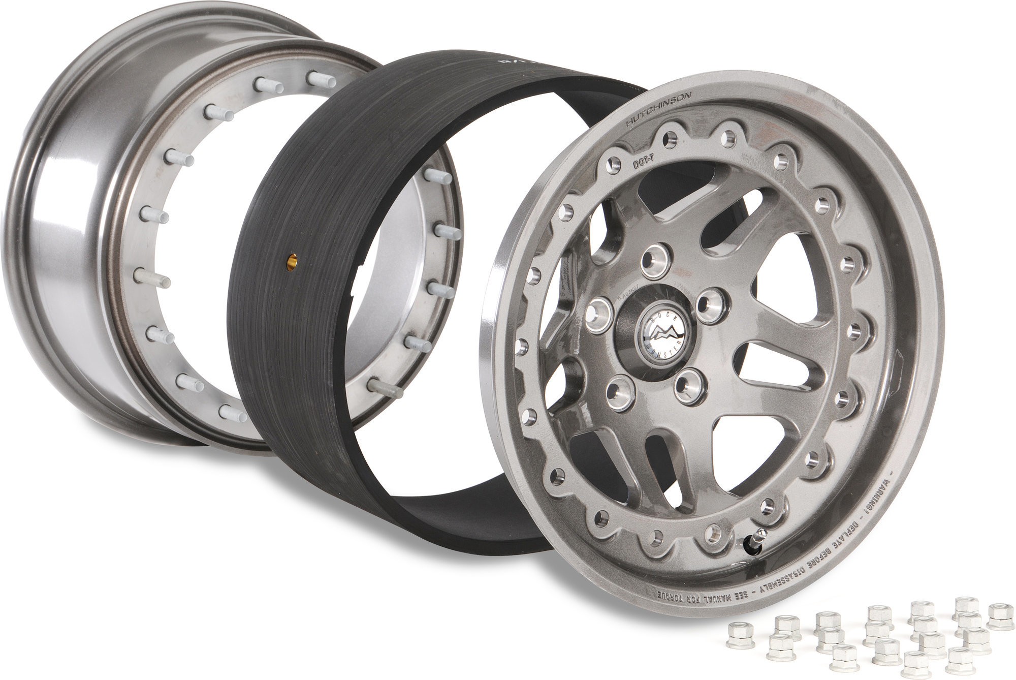

Bead-lock. Great. One more thing to learn about. Do I need them, who knows. Only if you build a prerunner I suppose.
You dont need beadlocks unless you are airing down so far you are afraid of the bead coming off or the wheel spinning in the tire.
For most people, fake beadlocks are fine
Fake doesn't turn me on. Form follows function. But that's me.
Seems like there's another ridiculous law. Wonder what is the thinking behind that.
good question
My guess is that it's because there are a bunch of different types of beadlocks, and most of them use a metal ring that's held on by about 30 little bolts that all have to be torqued down just right. A normal wheel has like a handful of failure points at most... beadlocks have a lot more.
The only people I know who run beadlocks are rock crawler guys with very large tires that get aired down to single digit pressure and some of the desert racing/mud racing crowd. I've run 35's for many years on 15x8 wheels with zero issues, even aired down to 10psi or lower. Wide tires and skinny wheels are a good combo, hard to lose a bead that way.
That said you do not need beadlocks, I have read a lot of your threads and they would serve no purpose for you.
Agreed. You can do an amazing amount of wheeling at12psi with no bead locks.
there are some DOT approved bead locks. But they are suuuuuper pricey. I’ll see if I can find the ones I had looked at.
Yeah beadlocks are totally not for me. Nice to know the story behind them though.
