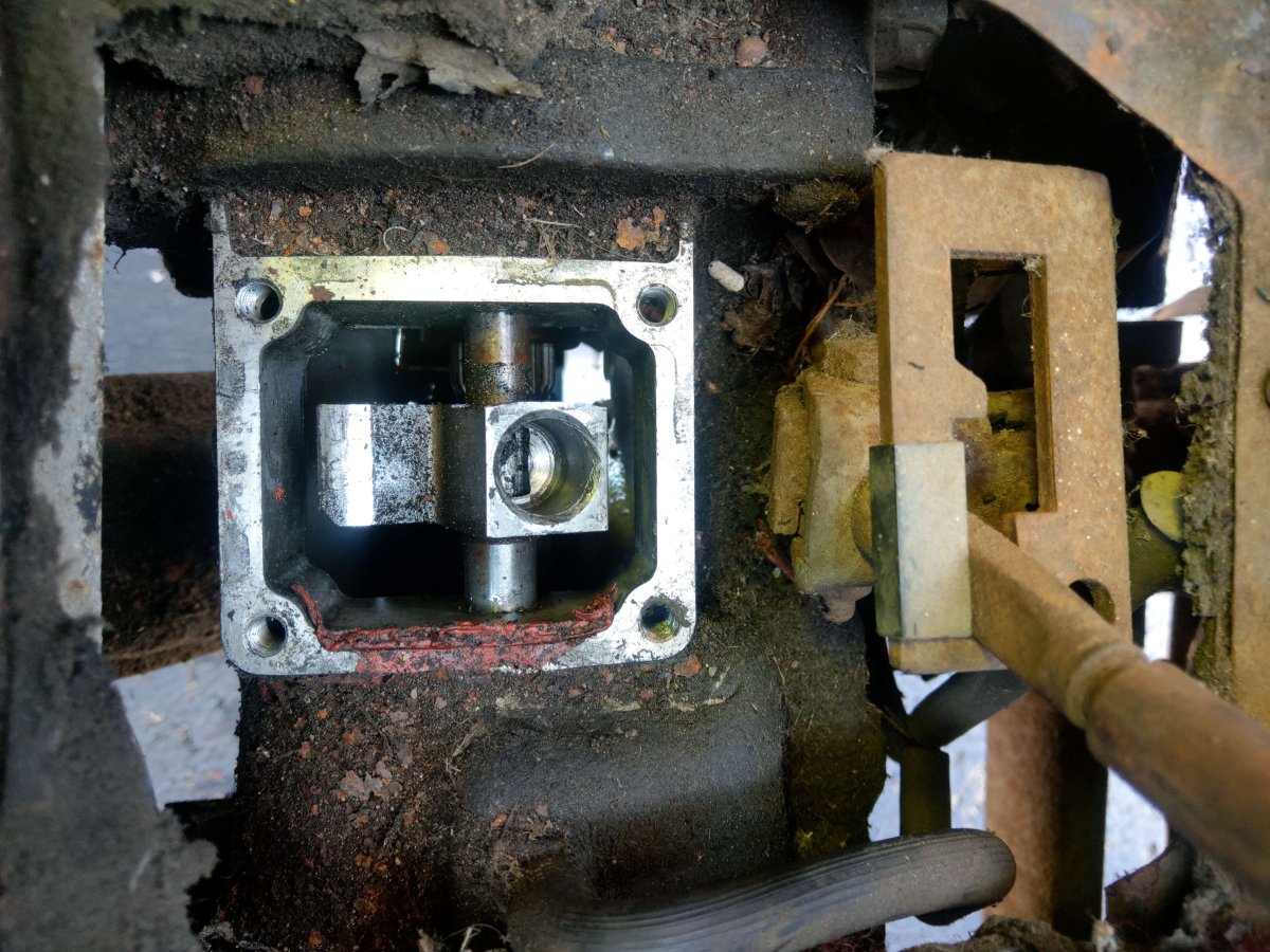

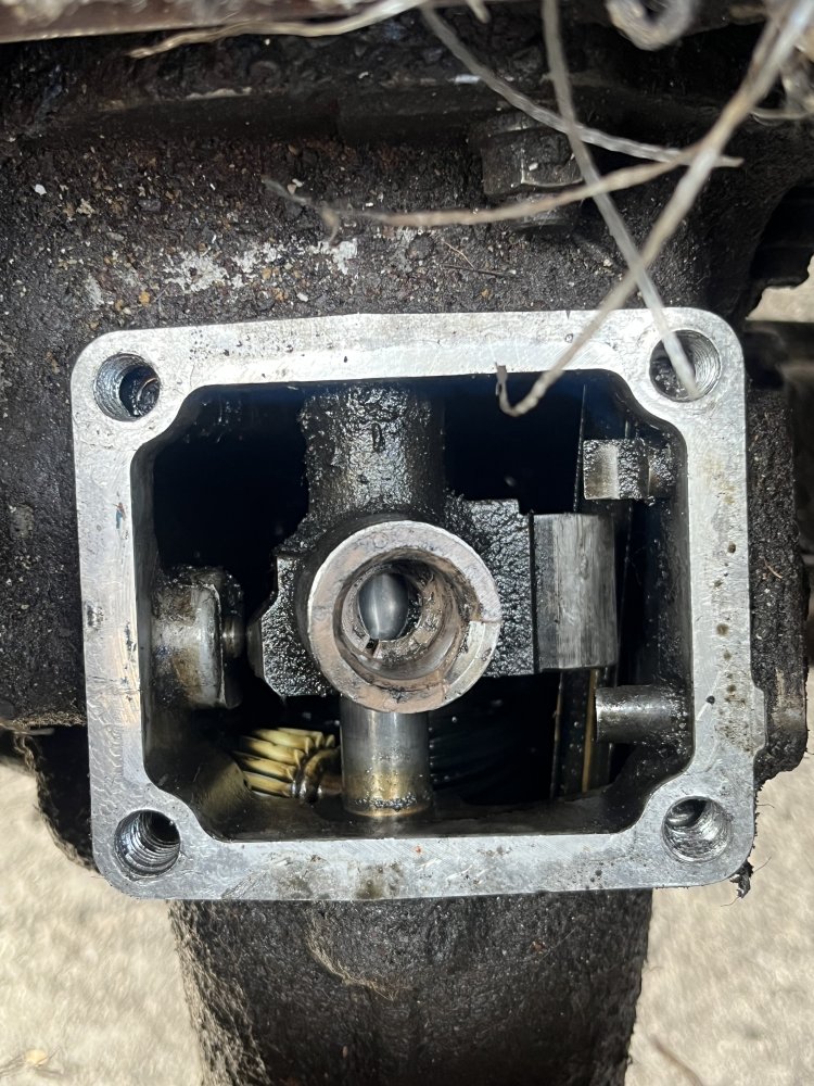

I have an 85 b2 with the Tk5 trans. It's got a lot of free play in the shifter just from the bearing, or whatever is in it is worn out. I can only find a rebuild kit for the Mazda M5OD trans shifter(which I have tried and it's completely different). If anyone has any input on where I can find a rebuild kit, convert it, or upgrade it please let me know. Photos for ref for the TK5
Contact them. Last time i directed someone there they said it was out of stock...for some reason though it didnt say that on my side.

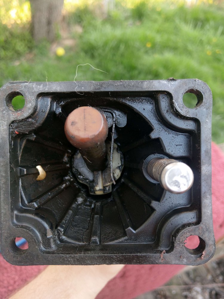

Yeah sure I’ll do 100 if that’s okay with you. thank you for the quick reply! Are you near NC? But before you waste $100, have you tried finding the bushing that sits in the receiver? It should look like this:
