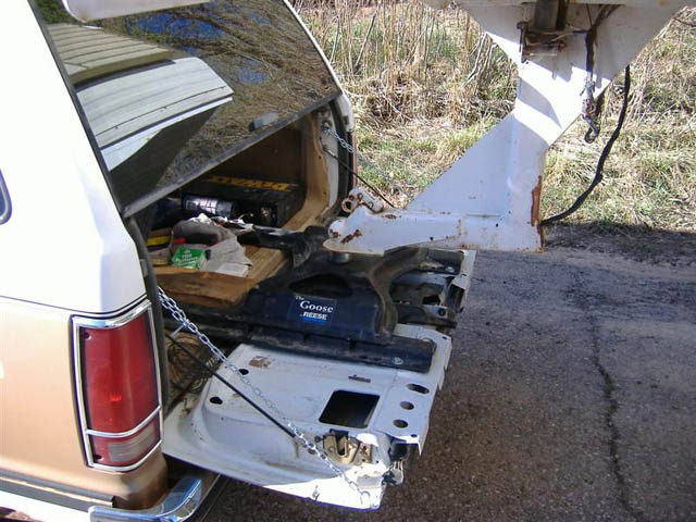

I think a big problem is the hitches on Rangers just aren't that strong. If you really wanna tow heavy loads you need a gooseneck hitch.
