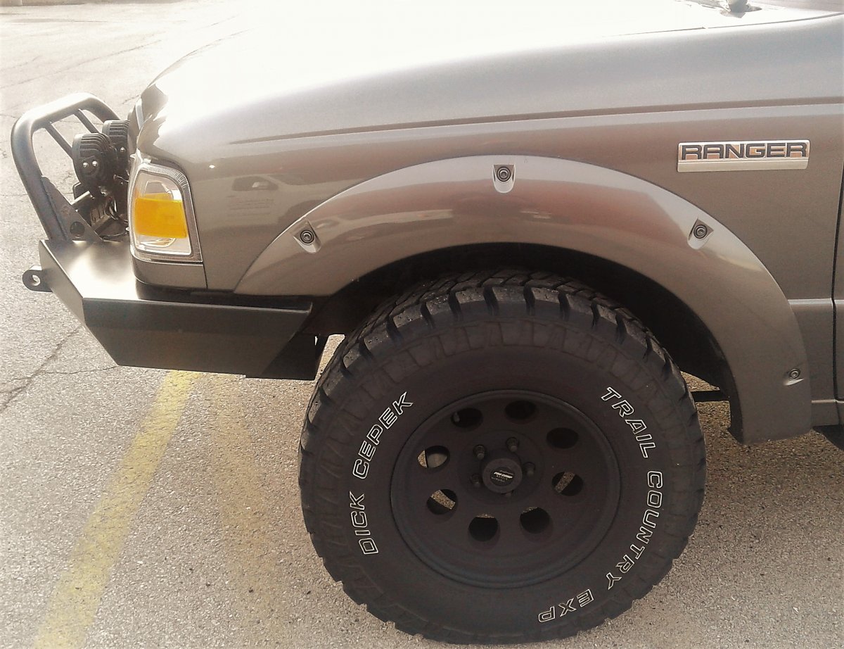

While not the cheapest option... I think it's the coolest one. Probably set you back a grand... but I don't regret buying them a bit. Another 180 bucks will get you the front skid plate also.

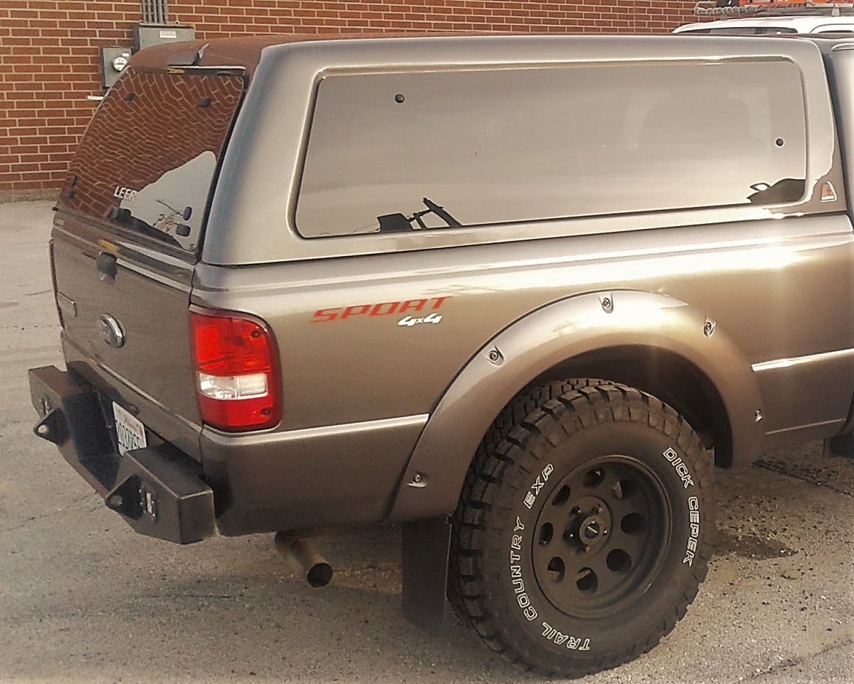

While not the cheapest option... I think it's the coolest one. Probably set you back a grand... but I don't regret buying them a bit. Another 180 bucks will get you the front skid plate also.View attachment 44257View attachment 44256
Those bumpers look great, too bad there's absolutely no aftermarket for the Bronco 2's :(. I'd love to get some aftermarket bumpers for my Bronco 2, especially a rear one to get that noisy rattling spare tire carrier off the rear quarter panel and liftgate.

A grand for BOTH or each end? Who's the manufacturer on those?
I'm not exactly sure of the current pricing... or exactly what I paid. But a grand for BOTH. I did have them build my rear bumper from 3/16" stock vs the base bumper which is 1/8"... a bit heavier... but it is pretty stout and will accept a tire carrier better with less flex. I did buy the skid plate too... not on yet... but it really protects the lower radiator.
I see now they have rock sliders... they replace the rockers... weld on. Not sure I'm ready to pull the trigger on those just yet.
In my humble opinion... these guys do great work and you won't be disappointed in what you receive. The TRS store has a front bumper listed. Buying through TRS doesn't cost any more... but it helps the site maintain itself. But to see their other offerings... Google... Affordable Off Road.

Awesome thanks!

They do have a front winch/non winch bumper for the BII... and I can't imagine that the rear bumper couldn't be fitted with a set of new mounting brackets.
