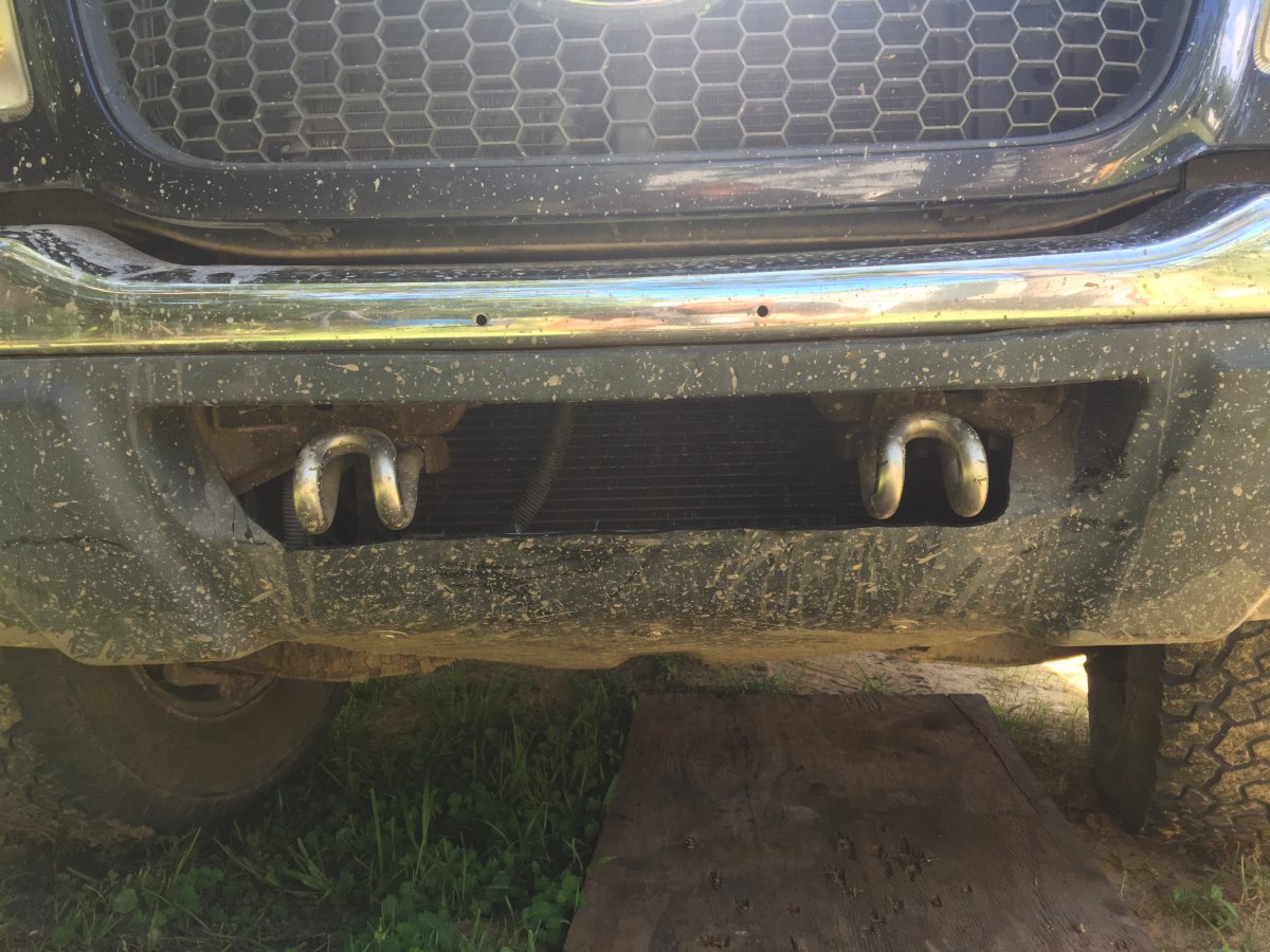

So did anyone end up finding information about a front hitch receiver. Curt advertises one but can't find much info on it. I am also wondering if one can be fabricated to use the connection points on my factory front recovery loops.

So did anyone end up finding information about a front hitch receiver. Curt advertises one but can't find much info on it. I am also wondering if one can be fabricated to use the connection points on my factory front recovery loops.View attachment 45657
If Curt advertises one for your truck and it's what your looking for id just get it. If it doesn't fit for whatever reason you'd get your money back and they'd probably even provide you with a return shipping label at their expense.
The lack of information on them im sure stems from the fact (assumption, really) that people who buy front receivers are 70 year old RV'ers that don't know how to internet.
As for getting one custom fabbed, nearly anything can be made to work with enough money.
Thanks for the replies so far. I had someone direct me to pictures of the one Curt offers and that will be a no go. The Curt one mounts pretty much under the bumper. It also appears it would not work with my factory skid plate. Just wanted to share that for anyone else wondering. Looks like fabrication is the best bet for me.
