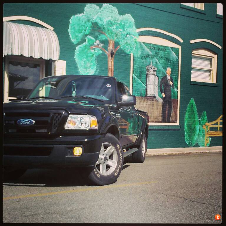

In the bag I'm going to do a lift block delete, but I'll want to keep my current stance angle, when I drop the lift block out I'm wanting the front dropped slightly more so I keep the look I got now, just with less wheel gap

You back is stock? Looks lower than stock in that pic, must be the angle. If all you want to do in the rear is remove the lift block then you have nothing to worry about as far as load capacity is concerned. If you want to go lower in the front, the next step is flipped keys whether they are stock or aftermarket. Regardless of the method, lowering any more will add more camber. You just have to adjust the camber out once you get it to the height you want. The only other way to get rid of wheel gap is to move to a taller wheel/tire combo, probably with a little less backspacing to make it look good.
