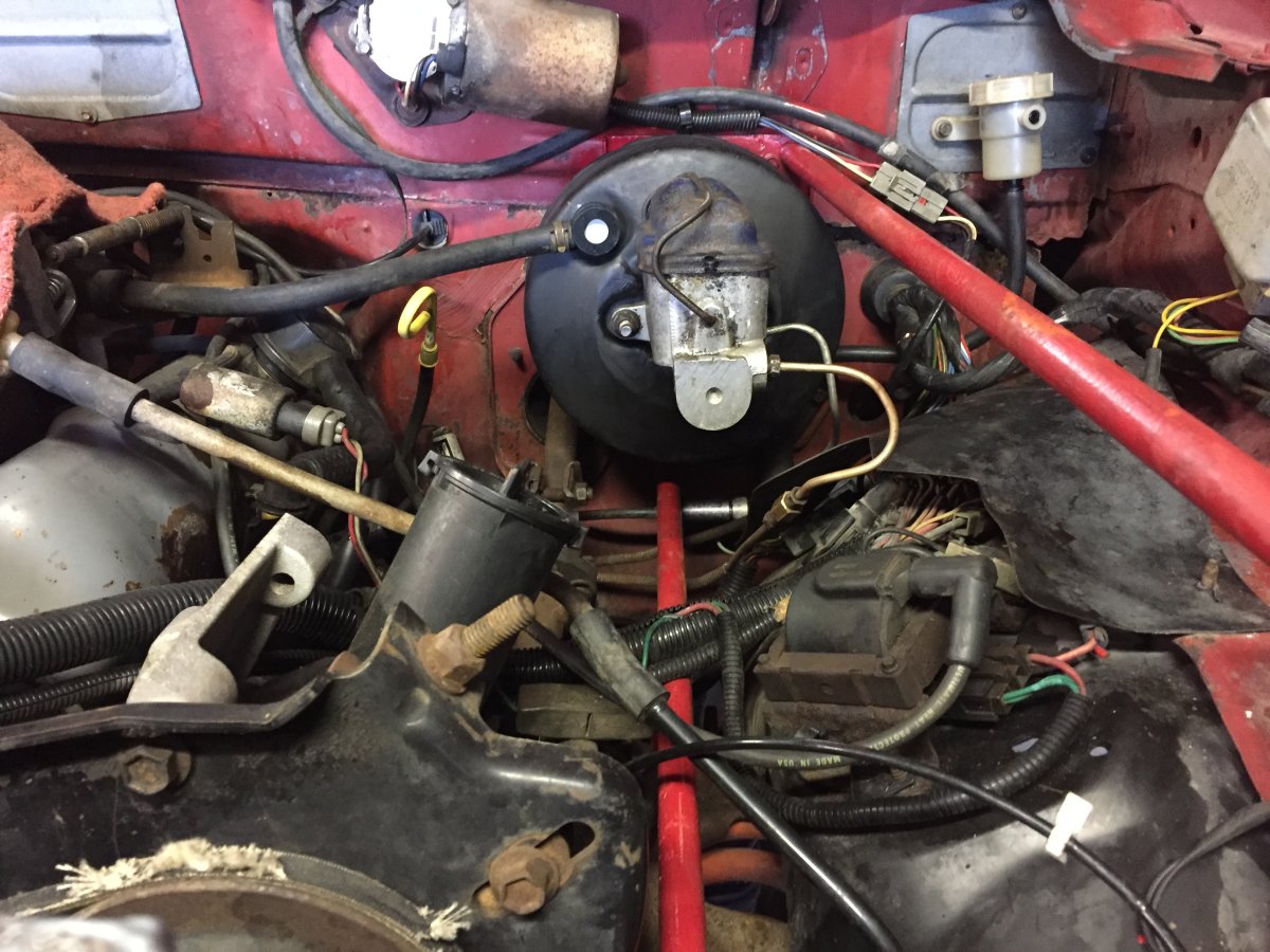

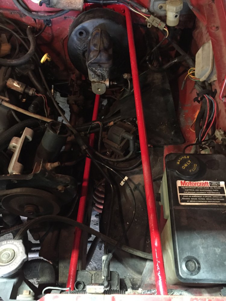

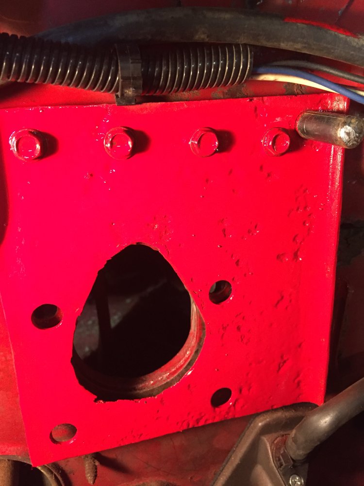

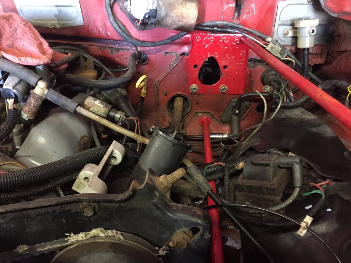

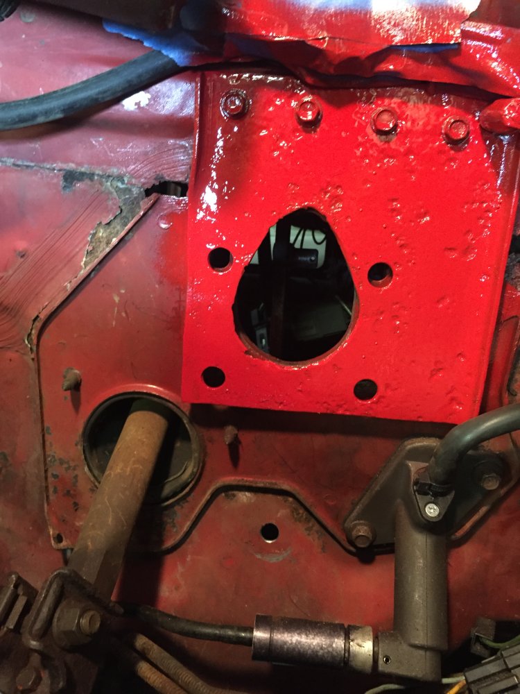

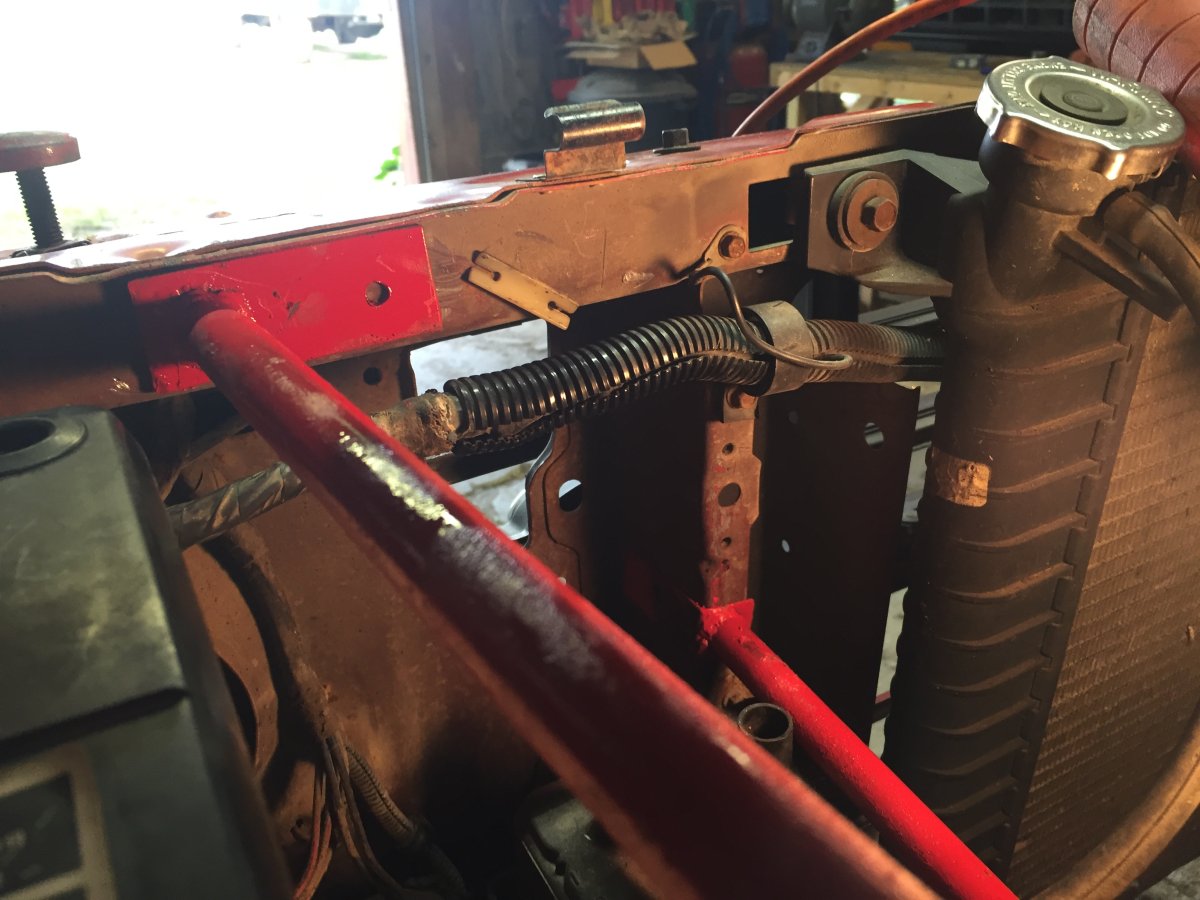

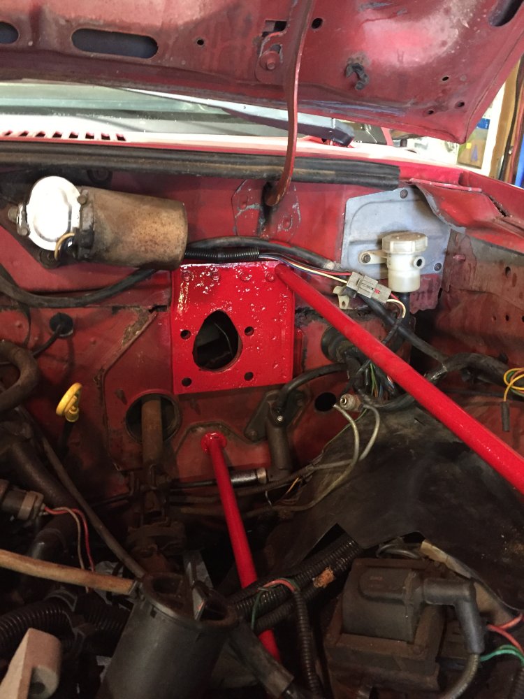

With the new braces in place the firewall appears to be stable. No movement when the clutch is pressed. Still don’t have a brake booster. But I’m expecting the same result.
However, I still have no usable clutch. Bleeds out fine. Pedal feels great. I can hear it give a small squeak when the throw out pushed on the pressure plate fingers but it won’t release the input and allow the trans to spin freely.
Took a couple days off to contemplate. I got nothin. Sooooo..... I yanked the trans back out and inspected the pressure plate. 4 of 6 bolts were only finger tight. There is my problem. All the clutch travel was used up pushing the pressure plate on the flywheel. Torqued it all down to spec and stuck the trans back in. All the fluid drained from the res to the slave. Hooked up the line and filled the res. It gurgled going down. I did not bleed. Pumped the pedal to set the throwout and I got great clutch. Releasing as it should. I should have seen it when I put the new slave in. A lesson in being thorough. I’ll button up what I got left tore apart and move on to the brakes. Progress.

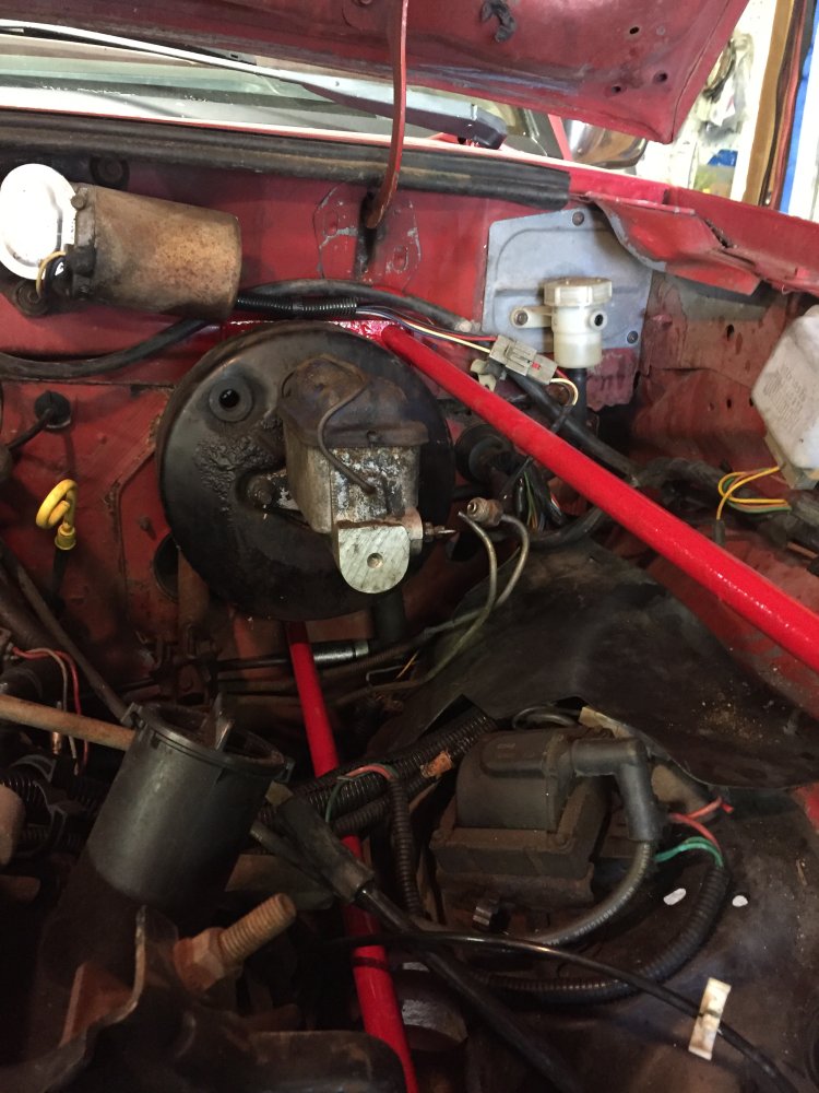

Started in on the brakes today. Ordered a new booster yesterday, came in this morning. Don’t know it I need a new brake master or not, but the booster was rusted solid.
I’m not mad about how the firewall braces turned out. I get no movement from applying either or both of the pedals. Good enough for a trail rig.
Everything went together well. Masters bad 😞. Rear res ( front brakes ) bench bleeds ok. Was full of yuck nasty. Front res ( rear brakes ) will not move any fluid. I suspected something would be amiss. I’ll get one ordered. I went ahead and mounted it so I could fix some line damage. Bled some nasty out of the front. Waiting on parts. Back in a few days.
Advances were achieved!
I had a few brake masters setting on the shelf so I went through all of them and they’re all junk so I ordered a new one and a new starter. While I waited I disassembled the other rear axle U bolt plate and got it spun around. Put a new adjuster cable on the rear brake. Parts arrived but I had a couple days of painting that damn cast iron master. Put it all together today. Bled the brakes. Threw in a battery and hit the key. Fired up great. Clutch worked as it should. Brakes worked as they should till I popped a rusty rear line testing them. The rods I made to stabilize the rusted firewall worked fantastic. No movement what so ever. Blocked off the rear brakes and we’re good for the day. She needs some fluids and fuel and she’ll be ready for a test ride on my ol’dirt road.

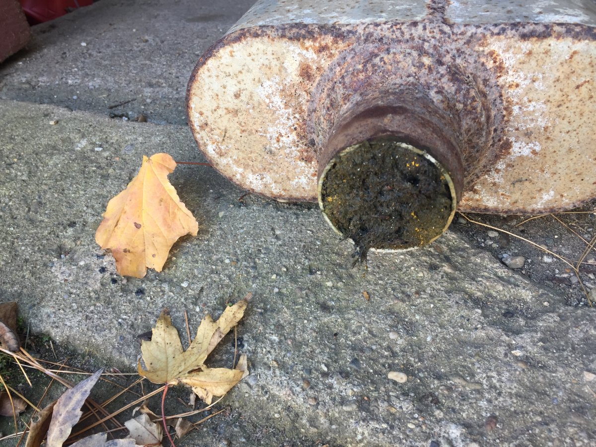

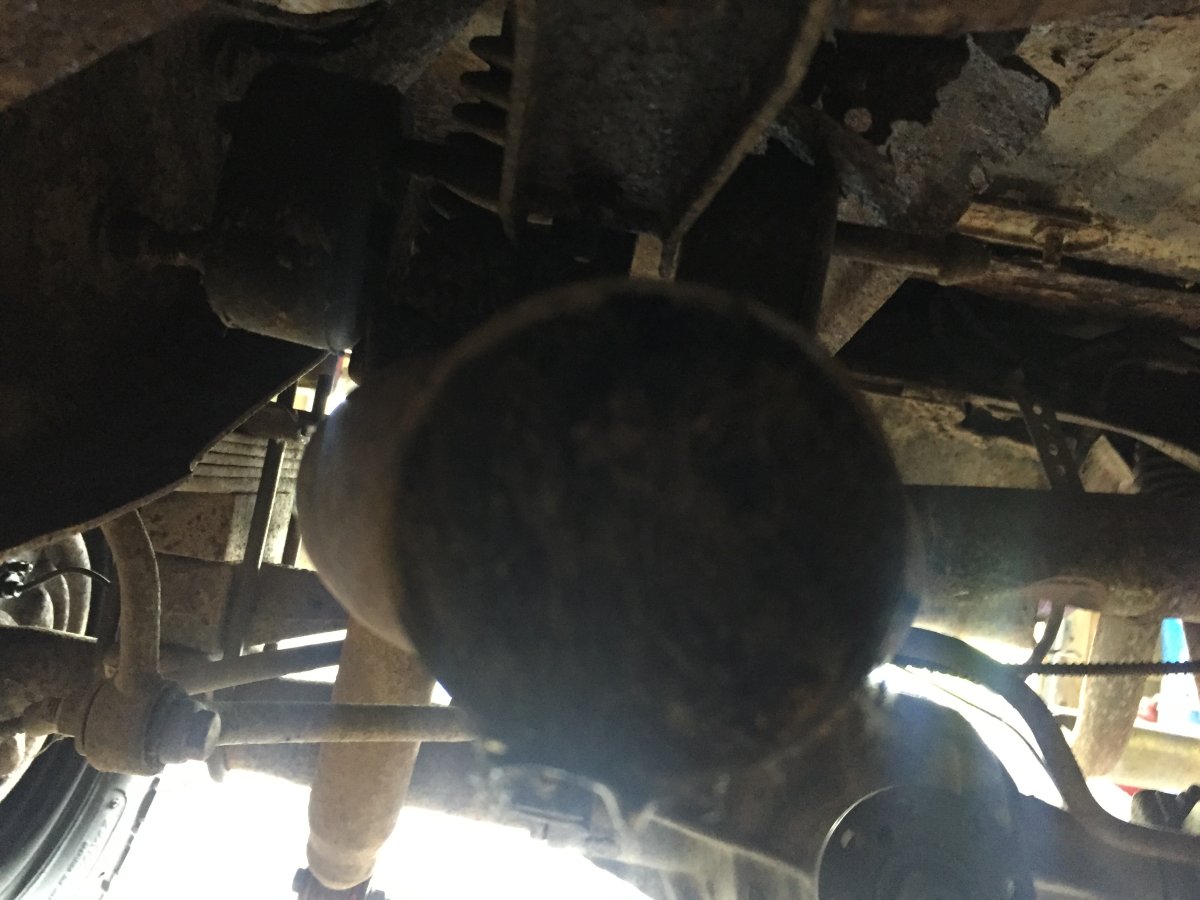

Topped off the fluid and pulled her outta the driveway. Running ok but she don’t wanna go. I suspect this god awful duel exhaust is plugged up. Back to the barn. Cut the pipe behind the muffler.
Now there is some nasty. I’ll get it cleaned out and get a turn down tomorrow
What is that in the exhaust? Looks like dog crap. Maybe someone played a joke on you?
I have no idea. Some looked to be carpet insulation drug in from mice. The truck sat for lord knows how many years.
To get that stuff out, you could try a wire coat hanger cut off. The end of the wire could get past the stuff, then you could pull it out at an angle to get as much out as you can.
I’ve blown mouse nests out of the exhaust of the Choptop twice now. Both times it was hard getting started and then suddenly it ran like a champ and there would be nesting blown 20’ behind it (pipe exits straight out the back). Hope a couple of the little bastards got blown out with the nest!
