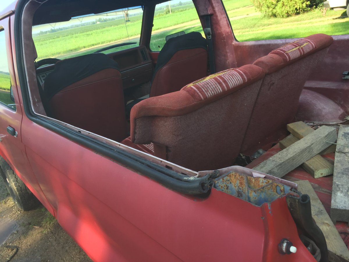

So my brother has an old Ranger. 1985. 4 banger 5 speed. He’s had it since Christ was a child. She’s about as weight reduced as she can get and still stay molecularly in one piece. Another feller accidentally dropped a tree on it. Feeling guilty the guy offered to repair it until he discovered how much was no longer there. ( Rust Belt Truck). He found this 85 Bronco II chop top and gifted it to my brother in place of repairing said rusted Ranger. So here it is. She didn’t run , wouldn’t roll, but somehow was dropped in the drive at my brothers house. Brother asked me to get her road worth so he can take the ball and chain out for ice cream. Ive worked on her a little bit this summer but not much. Somebody jacked this truck up. I decided its easier to work on it at my digs so today she came to the Bronco Ranch for a “freshening up”. Brother calls her Alma. I call her other things. I’m gonna record my progress on this thread. So if anybody’s out there, here goes nothing. Stay tuned.

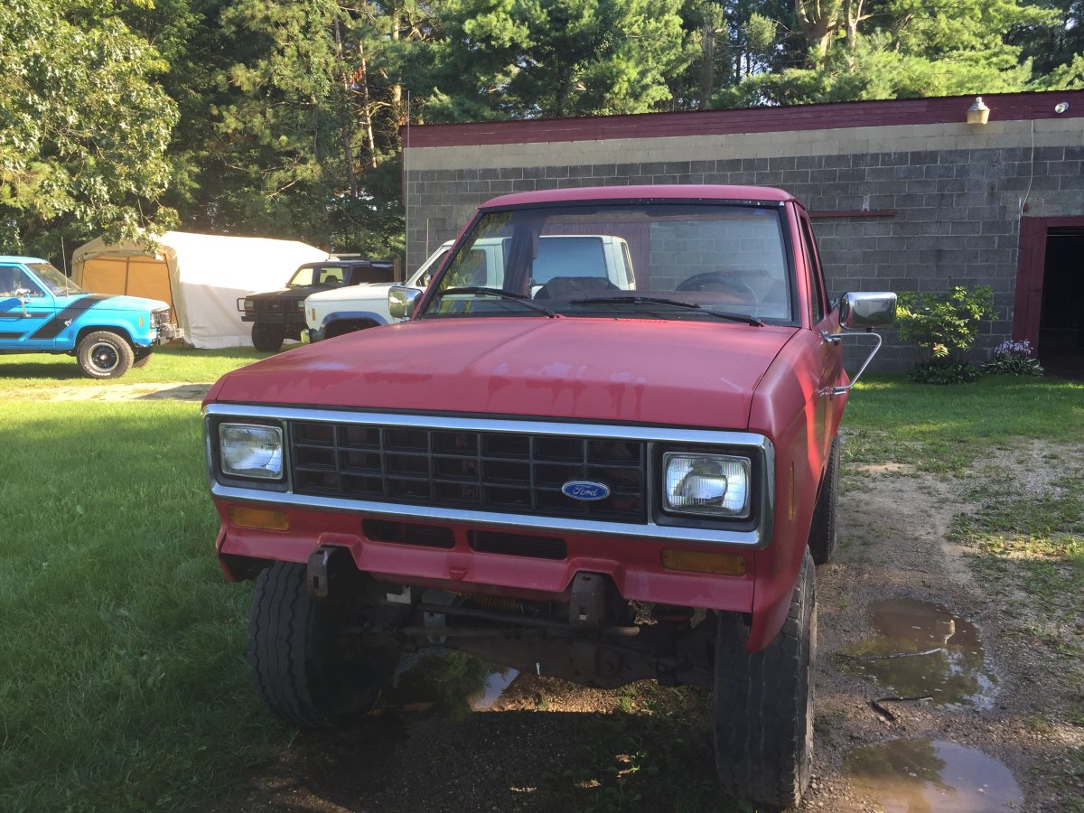

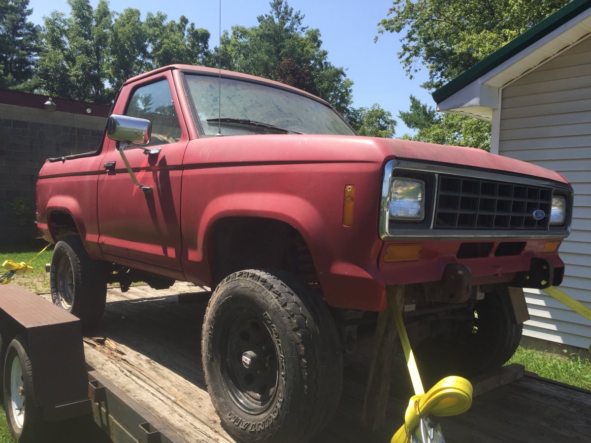

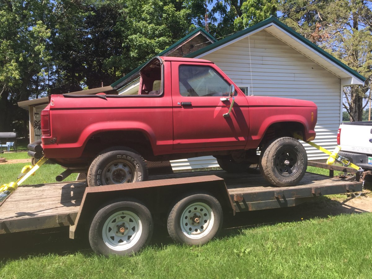

I believe it was fall 2021 my brother got the truck. We wrestled her for an hour tryin to get her in the barn. Once we got the hood up and looked around she looked mostly complete. 2.8 with all the crap still on it. Tossed in a battery, tapped the key and oh my god a grinding noise from the starter. Took at look see and well there was no index ring between the engine and transmission. WTF. Pulled the starter and looked around underneath her. Grenaded U joint on the left from axle. Shattered transfer case. Drive shaft extended with longer bolts and nut with lug nut spacers. Rear axle u bolt spring mount plates are turned sideways, cutting into the rear tire. 6” suspension lift with overloads and blocks in the rear. 1 set of 2” blocks and a set of bump stops from maybe a Ranger. No shims. This is nuts.

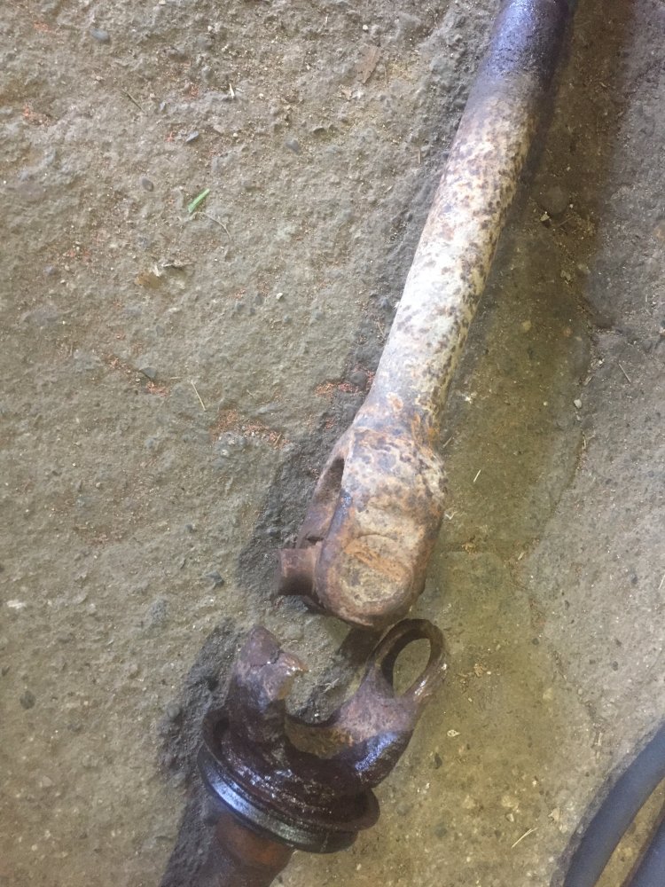

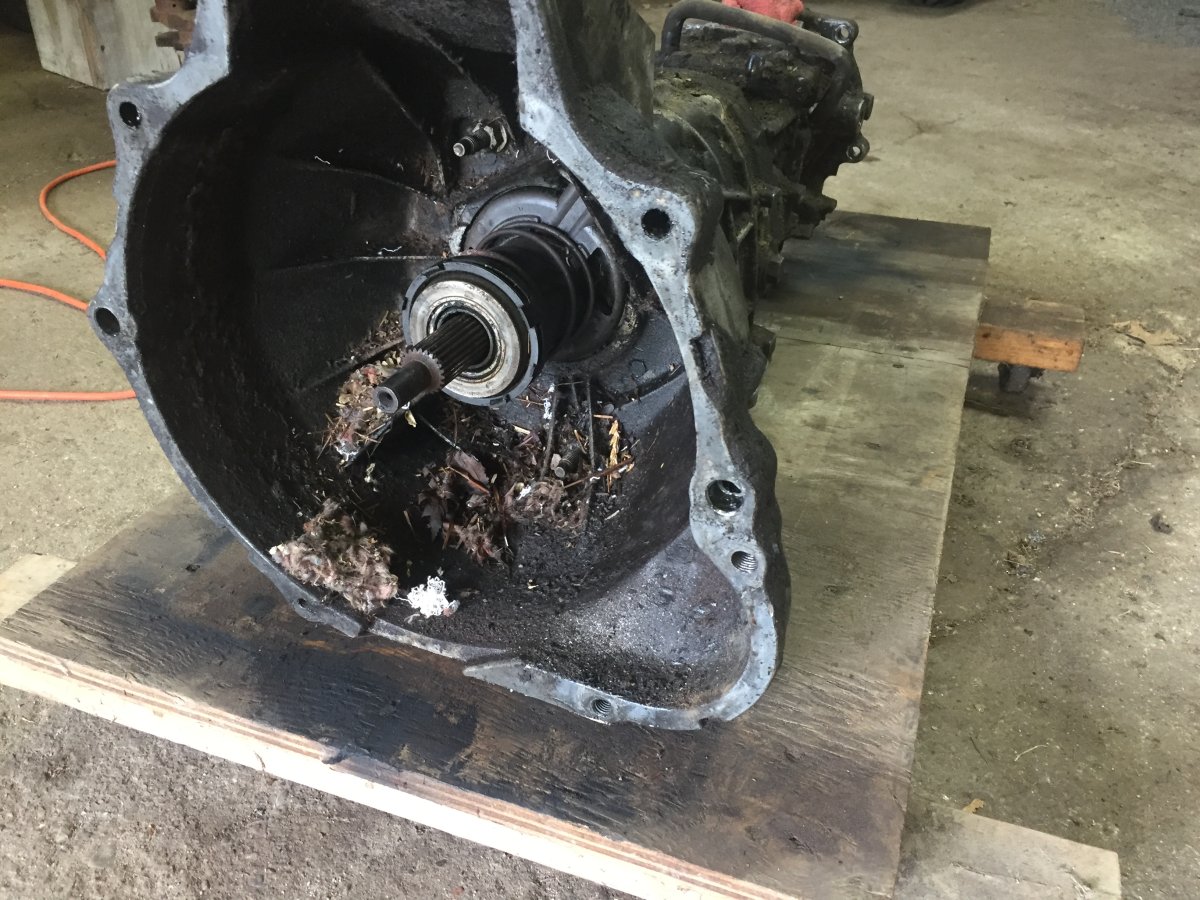

Searched the inner webs and found an index ring. Removed the driveshaft and dropped shattered transfer case in the dirt. Removed all the bell housing bolts and pulled the transmission back enough to squeeze in the index ring. Back on goes the bell housing bolts. Top starter mounting bolt hole is stripped. 🤦🏻‍♂️ Cleaned up the hole and use a bolt and nut. Called it a day and ain’t touched her again till this summer. Did a “ will she run” and got her to fire up but wouldn’t idle and rough running. Starter sounds like crap. I hope it’s not the flywheel. Pulled the carb off and did a total rebuild. Bolted her back on and hit the key. Fired up and ran like a champ. Next, see if she will roll. I need a transfer case. ( Hello tree crushed rusted ranger). Bonus, the ranger transfer case is the same manual shift but also has the double cardone joint at the rear, needed for suspension lifted BIIs. Removed, drained, cleaned, installed. Even fancied up the shifter.
I find it’s easier to see where you been when it’s clean and in good repair. Time for a break.
Borrowed the driveshaft off my BII as it has a 6” lift and installed it. She would move forward ok but did not wanna go in reverse. ???? Rocked her back and forth a few times and she started moving ok but the clutch was fading. Bleeding the clutch was futile. Between bleeding episodes the abused starter gave up the ghost. PO beat the hell out of it.
Looks new except for the hammered cover.

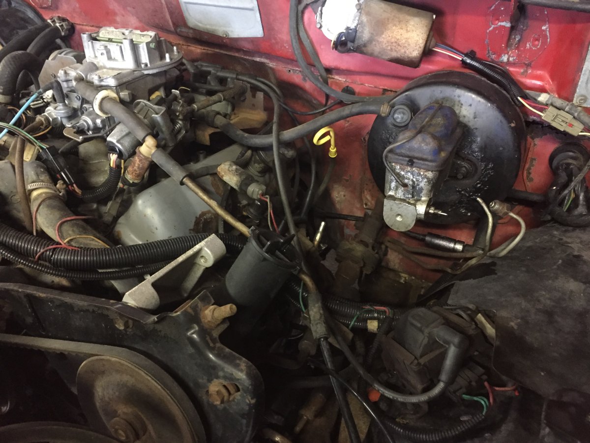

Tried the brakes and they were hard as a rock. Found the brake rod from peddle to booster was so rusted it wouldn’t move. Gonna need all new booster and master.

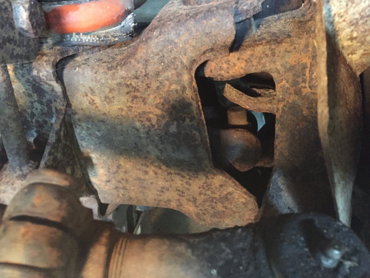

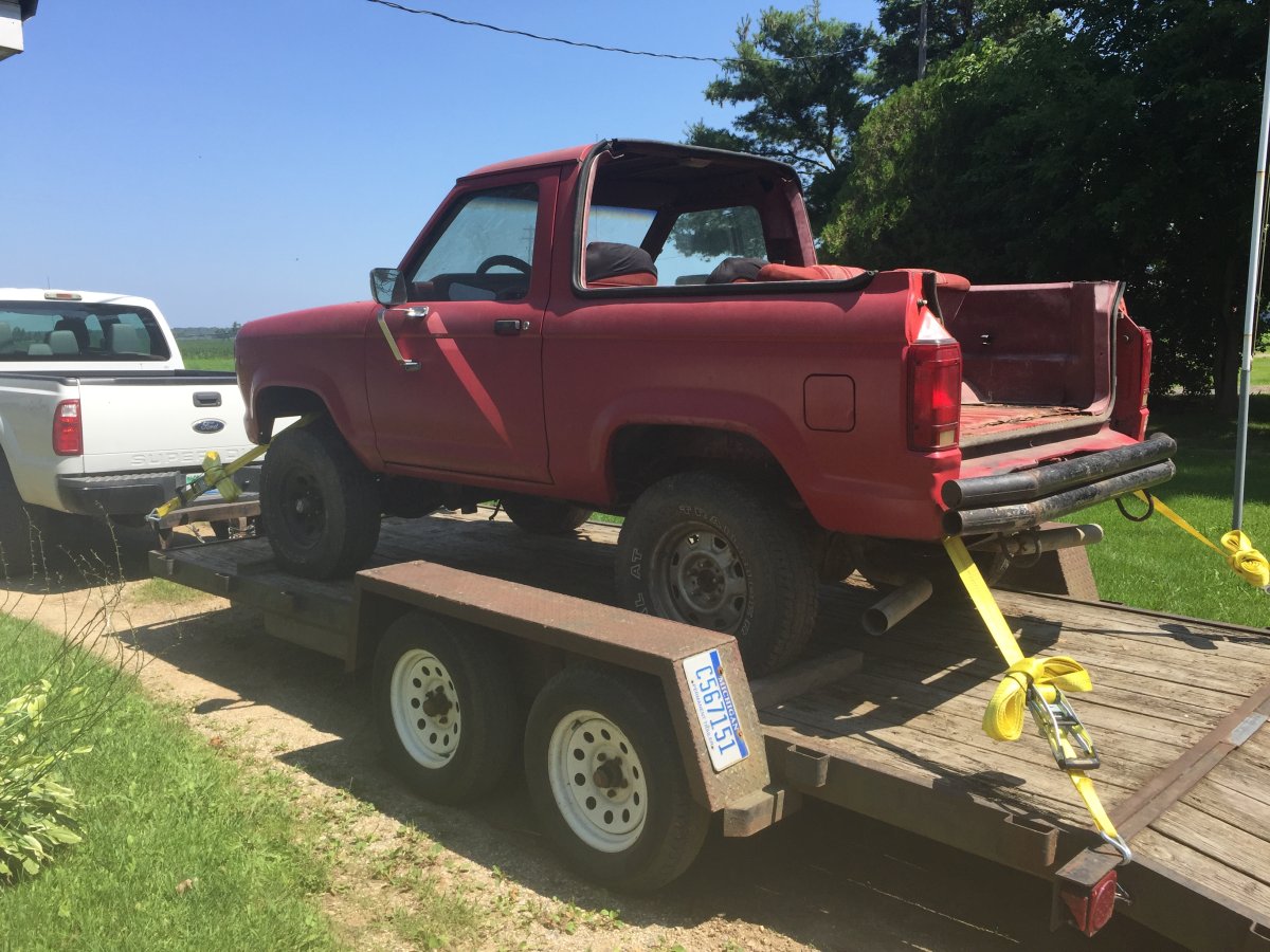

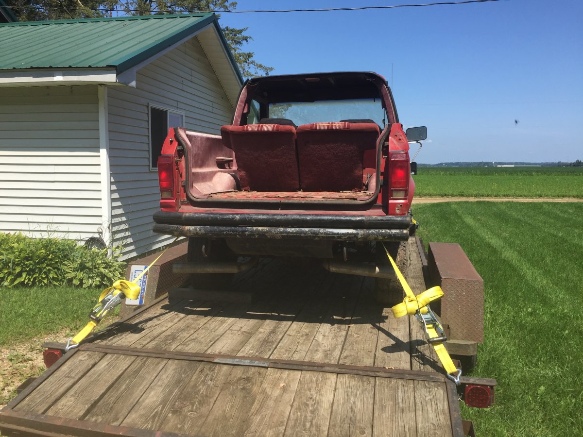

This is when I decided to bring her to the barn. Got her here alright. Loaded her on the trailer with a 4 wheeler and tow strap. Unloading was easy but because it was quiet with no 4 wheeler running I heard some disturbing sound. Crunch crunch crunch. Crap!!!! That sounds like rear diff gears. That explains why she didn’t wanna go in reverse. Door tag says 3.45 gears but I haven’t physically checked. Rusty ranger also has 3.45s so I think I can switch out axles but I don’t know if it’s a direct swap. I’ll have to take some measurements. BII has a different axle as one side is shorter than the other. I’ll have to investigate.

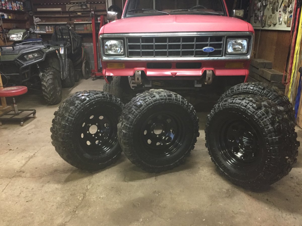

Shop rollers. I hate airing tires. Tires are super swampers TSL XS. 29 x 10.5 x 15. I bought them new a dozen years ago. Girl friend at the time had to have them as she already moved the driver seat and took over my rig. Sexy but noisy and rough riding. ( the tires not the girl friend )
Still have good tread and no dry rot. Rims are Cragar soft eights. 15x8 with 4”backspacing. They have never been on the road just used as rollers indoors. This setup will rub on my stock 85 when turning on anything but completely flat terrain. They would rub my 89 with 2” body lift on a steep departure angle while turning.

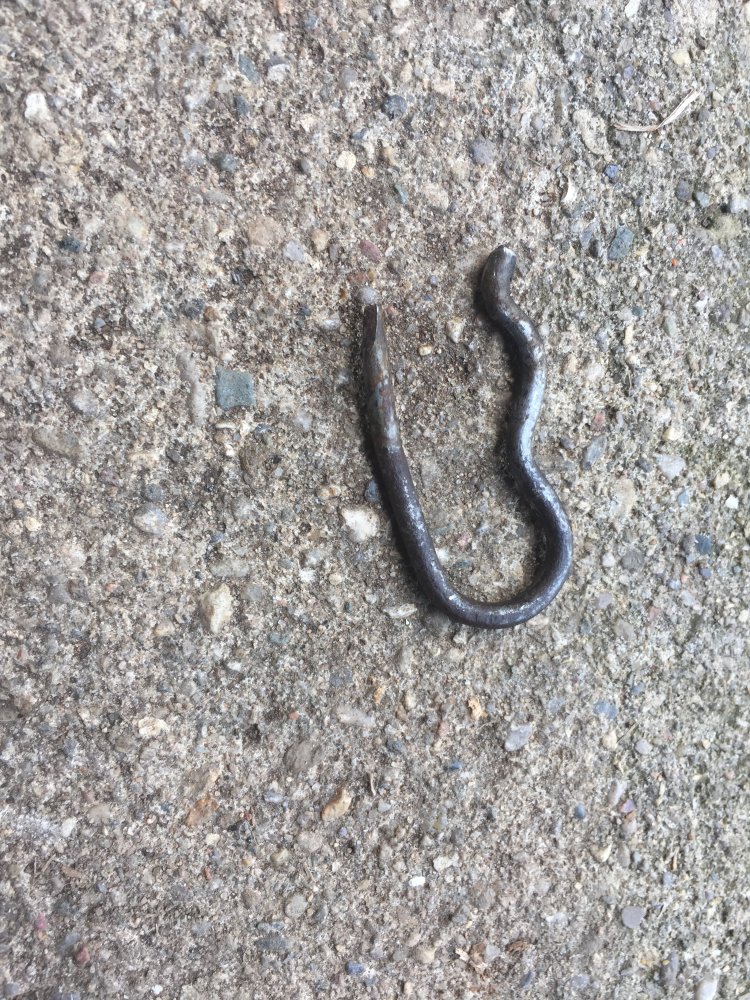

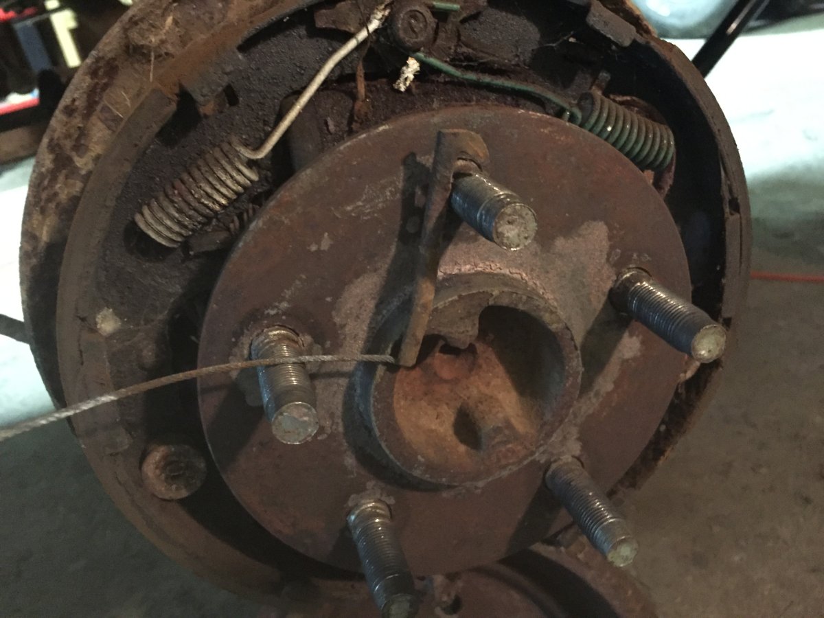

Got the rollers on. Found my grinding noise was left rear brake had broken the auto adjuster cable and it was tumbling around in there. Aside from that the brakes look new. Even all the hardware.

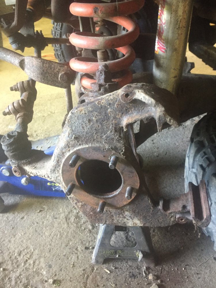

Want to move on to the clutch but I have no rear driveshaft and the front has a broke axle....... axle it is.
She didn’t put up much of a fight but I did use a big pry bar. Splines were not twisted. Stole the axle from the rusty ranger a few weeks ago knowing I would be needing one so I cleaned it up and put it back together. Spindle could use new bearing and seals but we will come back for those later.

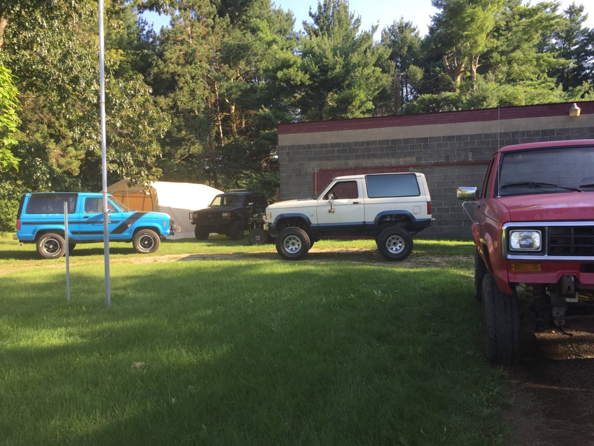

Thanks for the encouraging words. As you can tell I have a few of these old rigs. I daily drive one and the others mostly keep the dust off the ground. They never fail to draw attention when I take them out for a drive.
I’m not a trained mechanic, just an old dude with a love for old trucks and a need to stay busy. My facilities are modest and my tools are limited but it’s all for a good time and honest personal rewards.

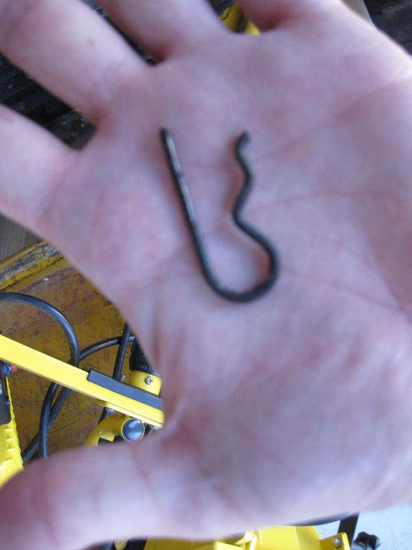

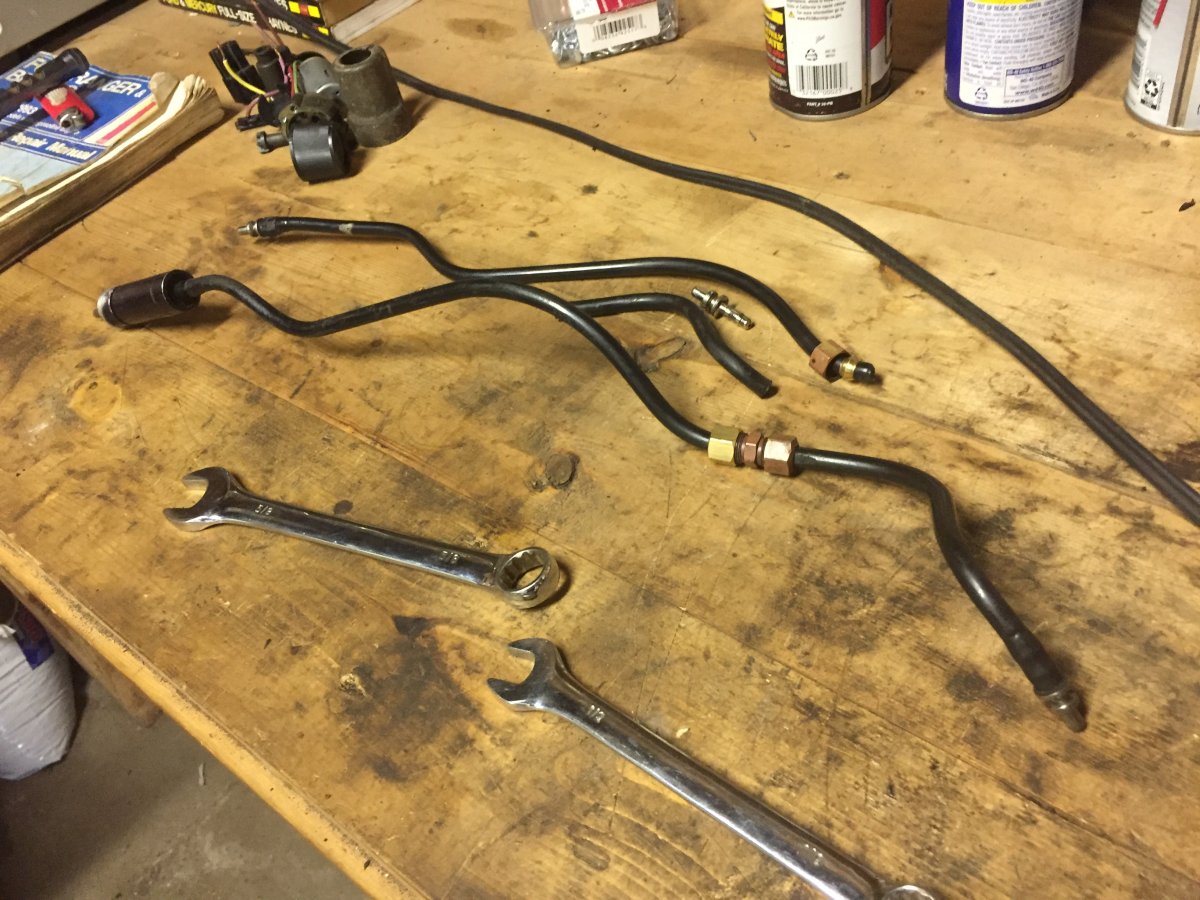

So that damn clutch is killin me. I’m convinced the master is bad. Leaking air from the peddle side. Anyway, trying to get the line off the slave. Pulled the pin but no joy. I think part of the pin broke off and is still holding the barb on the fitting. This is a FM145 with the grenade pin holding the line to the slave. A picture of the one I removed vs a picture of one I found in another thread.
Mine looks a bit shorter. No Es bueno. I think I’m gonna have to drop the transmission.
Pedal is still hooked up so I’ve got a board wedged against the seat holding the pedal down. Let it set overnight see if it pops loose. My hopefulness is waning
Upon further testing I don’t think there is any of the old pin in there. I can prob with a pick or drill bit and I can prob past the connection. Sooooo... crap. For fear of damaging something I think I’m gonna drop the transmission. Chances of it going smooth? I give it 50/50. I’ve had it loose to put on the index ring. Hope the y pipe come off. 🤦🏻‍♂️
As a testament to not giving up, I finally got the clutch line disconnected from the transmission. Removing the bleeder gave me a little more room to get on it with some lock pliers. I damaged the plastic hose but I have spare parts and can make one good set. Here it is ready to go in but sweet Moses it’s hot out there. 🥵 Break time in the A/C with a cold drink.

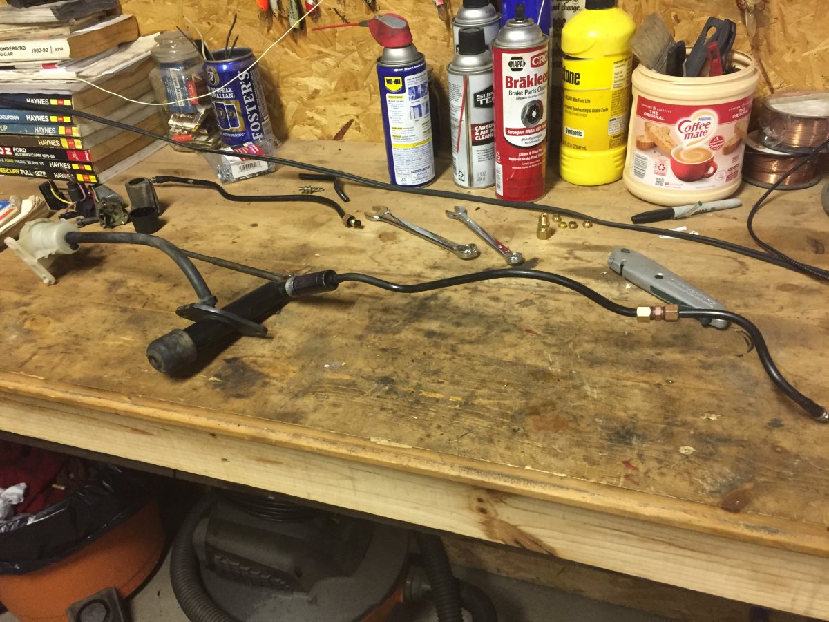

Master back in the truck. Bled it every conceivable way. Gravity, vacuum, forward, backward and upside down. I can get it to disengage the clutch once when I start it. It will go into gear if I keep clutch pedal in after I start. Put shifter in neutral and let off clutch, push it back in and it’s gone. I’m not leaking any fluid so I can’t figure out where the failure is.
I have now removed the transmission and it’s on a dolly in the middle of the barn. Pulled off the slave, it looks old. Says FoMoCo and USA. 🤔 does this mean it’s factree? New slave and master are on order so I hope to be reassembling later this week.

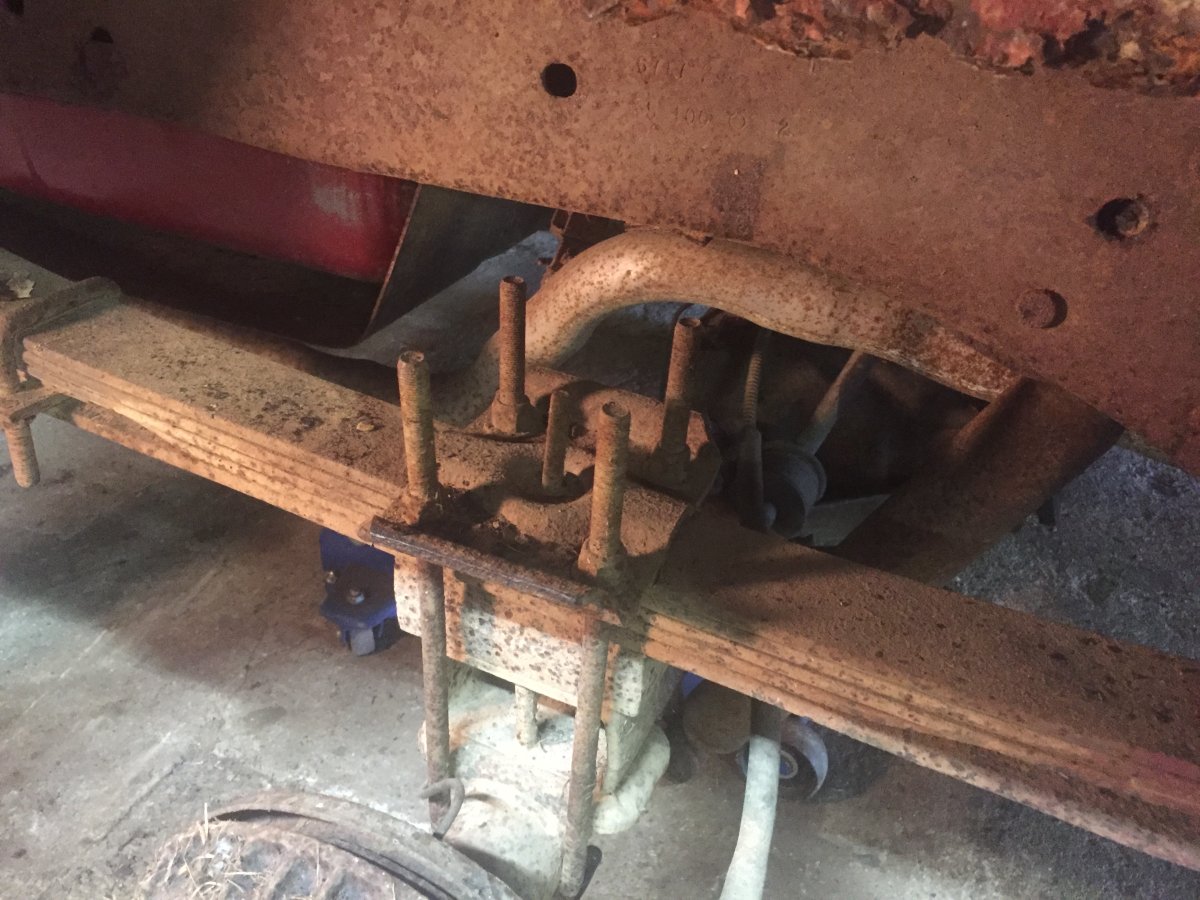

Spent some time getting the rear axle u bolt brackets turned to the correct orientation. Again common sense has left the job sight. Trimmed the u bolts enough to get a deep well socket on them. Got the bolts off and spun the plated 90 degrees. Whoever did this had to splay the bolts to fit in the bracket. You would think that would be a clue but 🤔 🤦🏻‍♂️ never mind

Finally got the correct slave and have put it on the trans and the trans on the engine. The new clutch master is a little different. It’s a cast metal piece not plastic. I think it’s aluminum. Nice. So it’s in and bled. I think I have a clutch but the firewall and floor are so weight reduced they won’t securely support the brake and clutch. I’ve tried talking my brother into giving up as she is so rusted but he doesn’t care. Just wants to bomb around on the farm and in the woods. Even if it’s never on the road again. So I will endeavor to persevere.

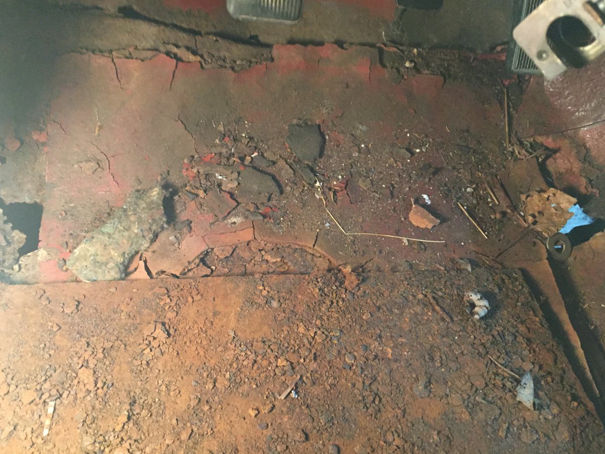

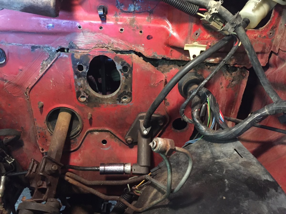

Here’s the firewall and floor.

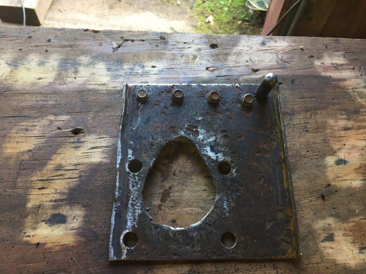

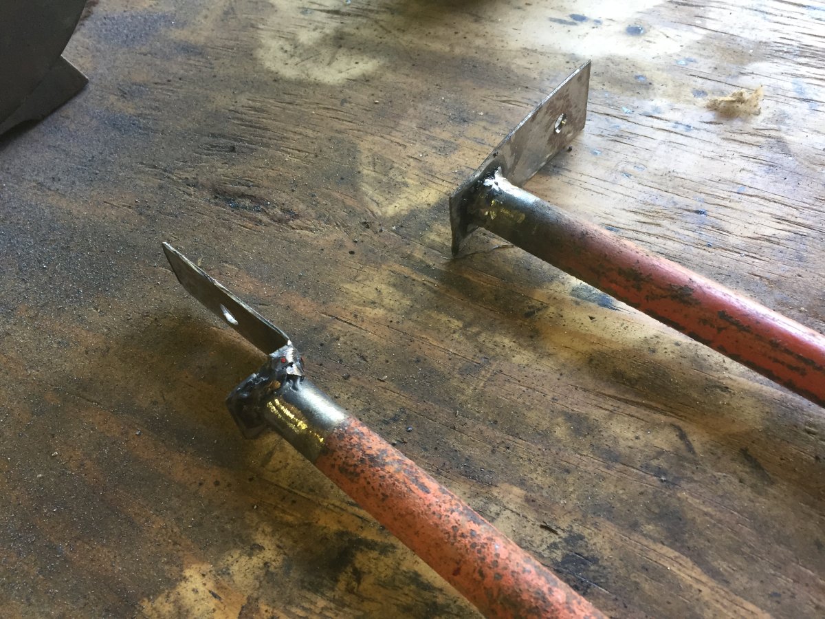

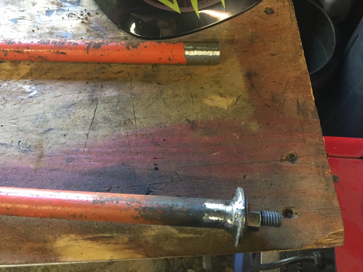

It pushes away when you apply the clutch pedal or the brake. Short of tearing everything out and cutting bending welding ect ect ect. The only fix I can think of is support rods holding it. Pulled out some scrap steel and started fabricating. I’m making a back plate and two rods from the firewall to the radiator core support. They need to be removable and avoid interference with other equipment. Here’s what I got.

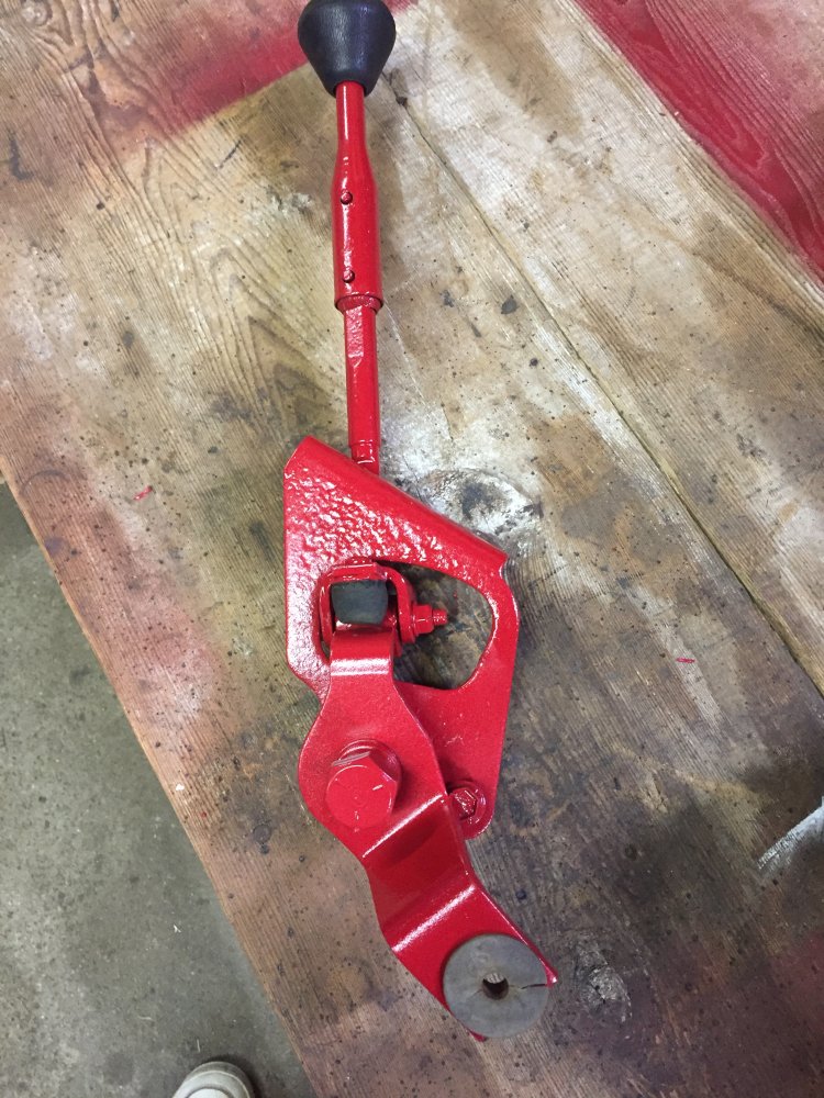

Parts are in the paint booth ( back yard on cardboard). I will post assemble when the dry.
