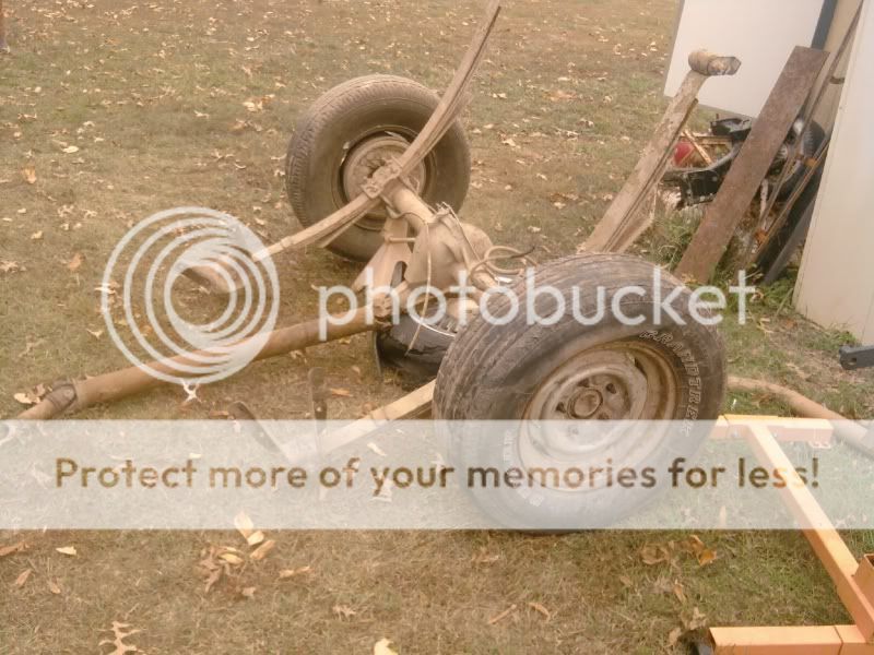

Pics of the 8.8 and a set of rims, so my trailer can have its wheels back, haha.

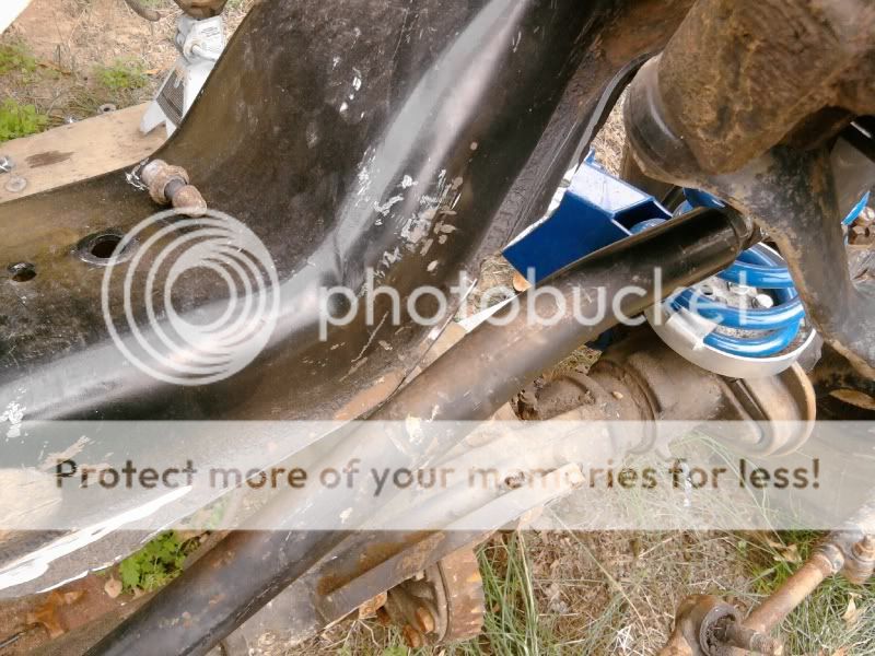

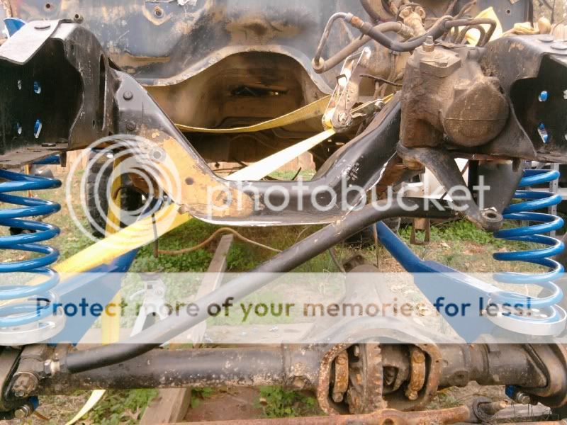

Mocking up the track bar mount
I’ll be running a brace from the track bar bracket to behind this crossmember, so I’m not too worried about losing structural integrity by trimming it down

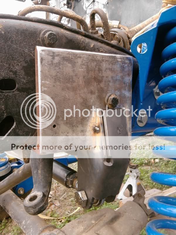

And the mount so far. I’ve got a big chunk of 3/8” angle that’s 4”x6”, finally found a use for some of it.
Not 100% sold on the curved track bar, might get a straight one….
Got the track bar mount installed. Right now it is bolted on in 3 places. 2 you can see, the other is underneath right behind the track bar
I haven’t made the brace from the mount to the crossmember yet, but I will when the right piece of steel falls in my lap

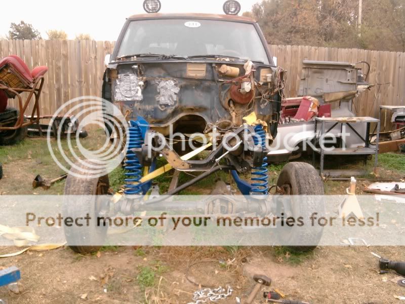

Picked up the motor and rolled the body underneath
Stopped there for the night. Going away for the weekend, but will resume on Tuesday night, weather permitting.
