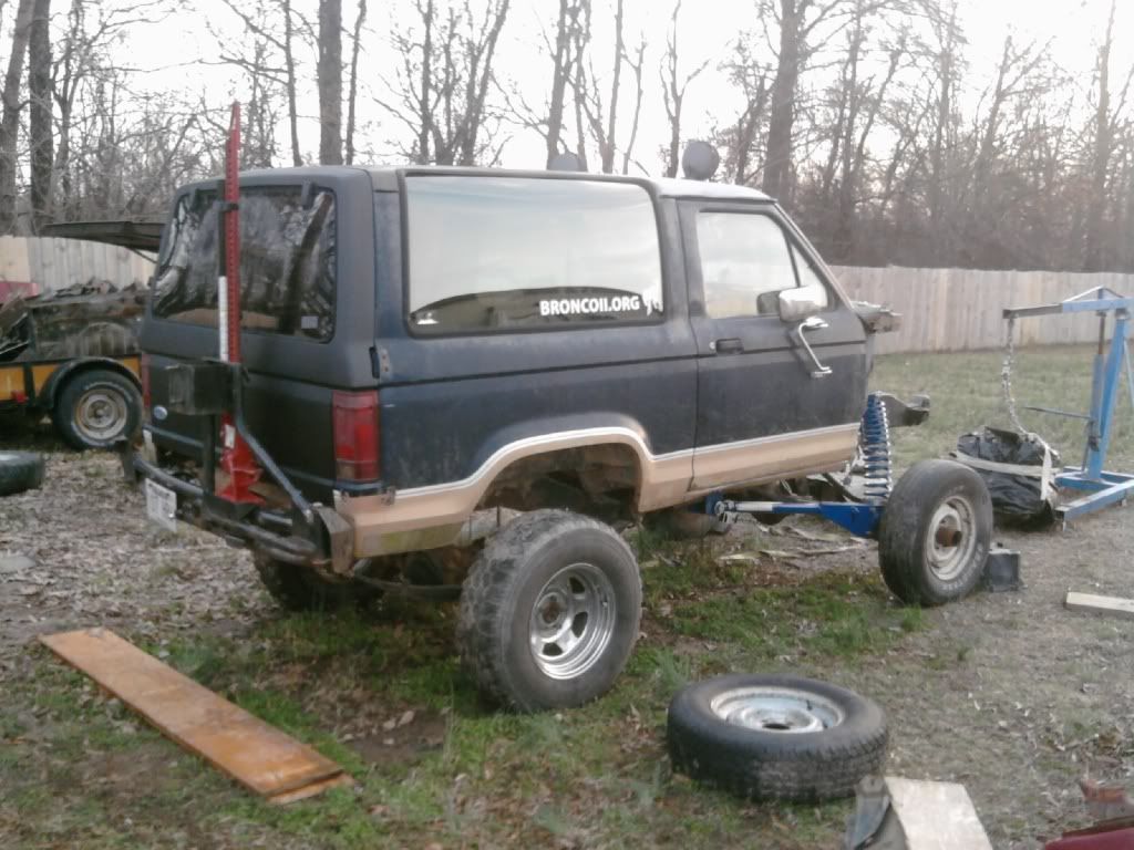

Today was a nice day, so I spent some time tearing apart whats left of the rigs that are going to the scrapper. Had to do something to my BII, so I threw on the belltech 6400 shackles I'd had sitting on the workbench for awhile
besides a "keeper" on one of the stock bolts breaking off, everything went relatively smoothly
*Take Note* the bolts on an 84 are thicker than later years. same size bolt and nut, but the shaft is thicker. just enough to not fit in the belltechs.
So I grabbed some bolts out of some later springs (that also still had the "keepers" on the nuts)
'84 on left, '87 on right
Before
After
