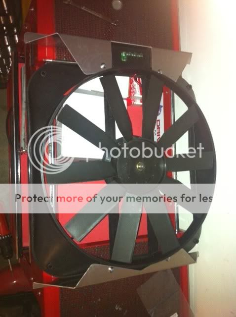

added a flex-a-lite electric fan.

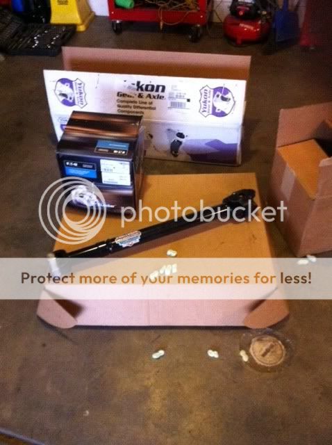

760x spicer u-joints, new ball joints, new hubs, riddler diff cover, front brakes

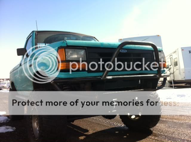

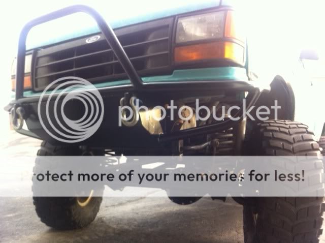

Good job on the Bumper!!!
Mounting the winch on top or behind the bumper?
It's actually going to sit in the bumper! A hole will be cut for the lead and I will have to remove the grill and lower panel to squeeze it in! Ordered a superwinch 10000.
good stuff :yahoo:
you will always be able to get out with that!!

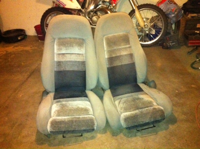

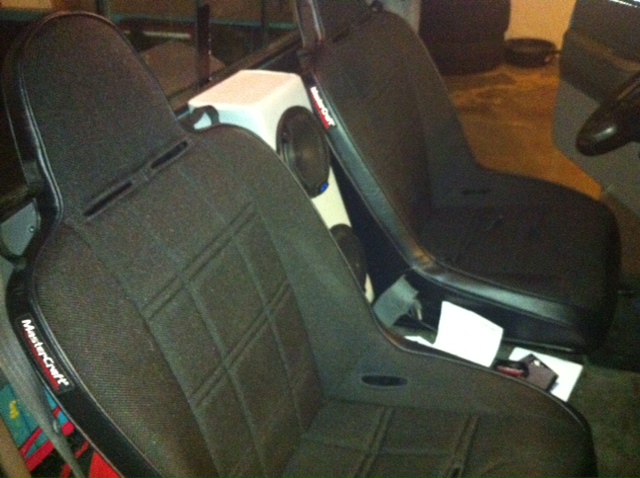

Old seats and new mastercraft rubicon seats. I also added a custom front drive shaft, new radiator, chromoly shafts and e-locker.
