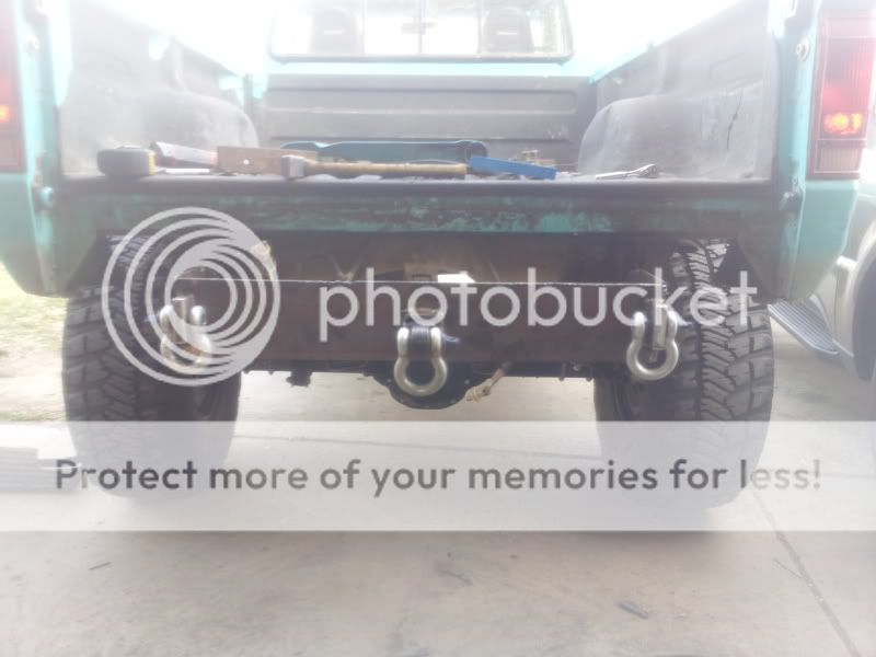

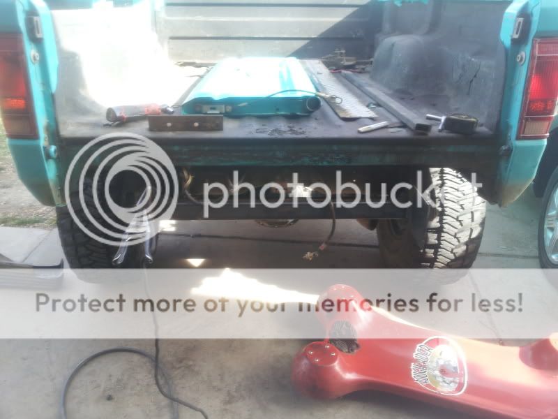

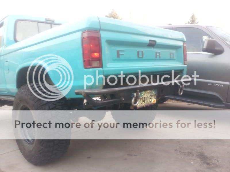

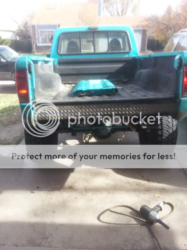

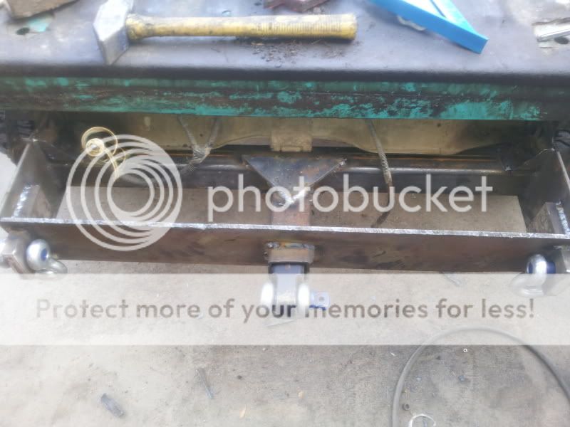

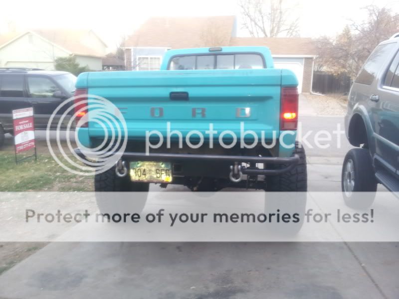

Worked on TNT rear bumper today.
Here are some pics...
Just need to pick up some round tube and finish up the rest hopefully next week.

I had forgot about it until you brought it up. First of the month is normally slow cause everyone is making there rent or house payment. Middle of the month I get swamped.
So I figured it was a good day to start it.
I agree, looks really good:icon_thumby::icon_thumby:
I just know if I had it, I would use it as an anchor on some tree around here:icon_rofl::icon_rofl:

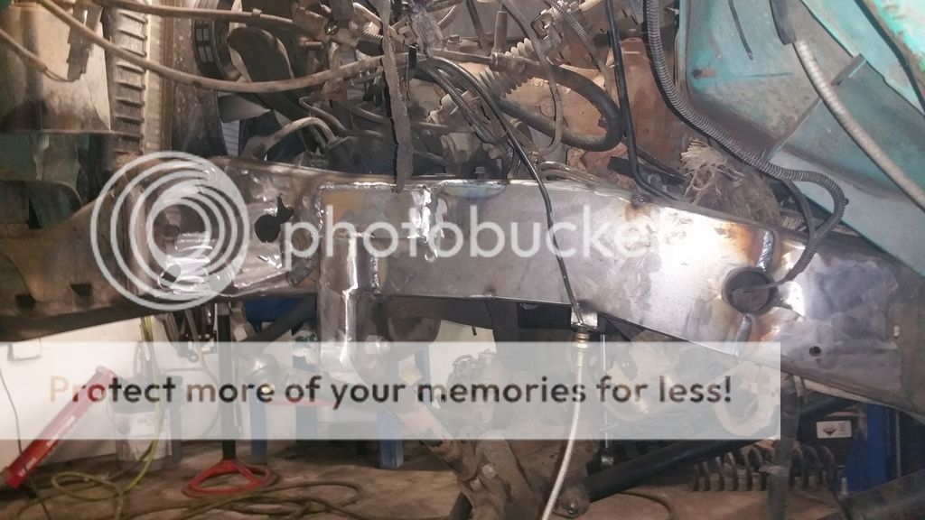

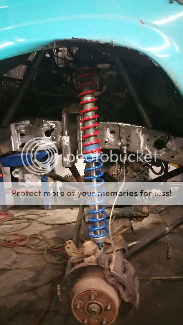

Well the time has come!! After years of wheeling on this set up it is time to revamp the ranger!! Only issue I ever had with the previous set up was the rear eaton elocker and it always breaking. First task at hand is to remove the spring and shock set up to replace it with 14" travel King coilovers. I'm plating the frame for strength and also the old shock hoop ripped off the frame. I also will be removing the gas tank and mounting a rci fuel cell in the bed to make room. Later this season I will be putting a full width hp44 and a 60 rear.
