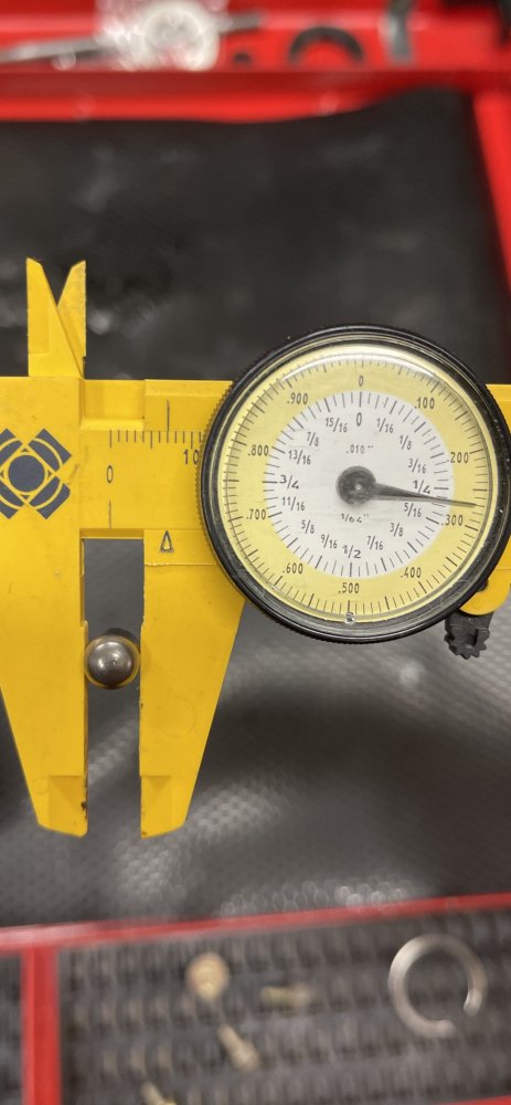

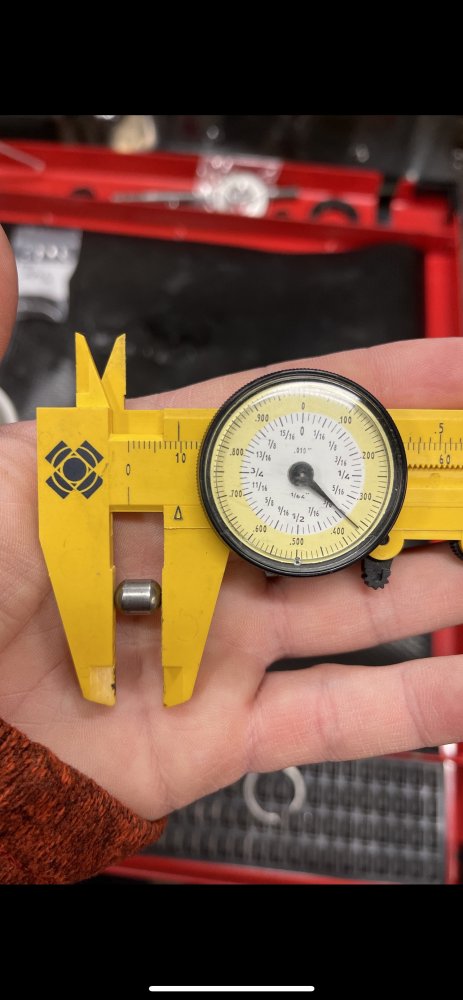

I'm in the process of overhauling my 1986 TK5 on the B2 and it's been a real trial getting parts. I'm putting it back together and at some point lost one of the shift rail interlock plungers. I've ordered a few different ones on EBAY and they've all been wrong. Does anyone have an idea of the part number? I'm desperate at this point!

Is the OD on the pin a standard size? You may have to get some rod and make them yourself. Whatever you do , don't leave them out. That's what happened to my Bronco II before I got it.

Interesting! Definitely waiting till I find one to reassemble- but the rod idea isn’t bad! Thank you for chiming in, great brainstorm
Here's a place that might sell something you can work with. Here are drill rods that are good metal that can be hardened after you make what you need.
Thanks. I got some rod. May have to make it myself as you suggested. I really can't believe I can't find any info on this stupid thing! Such a tiny piece has halted all my progress.

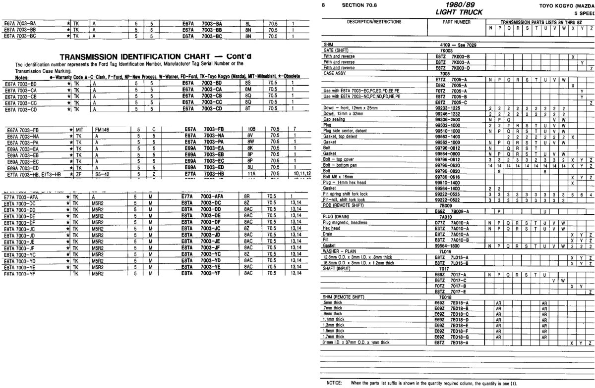

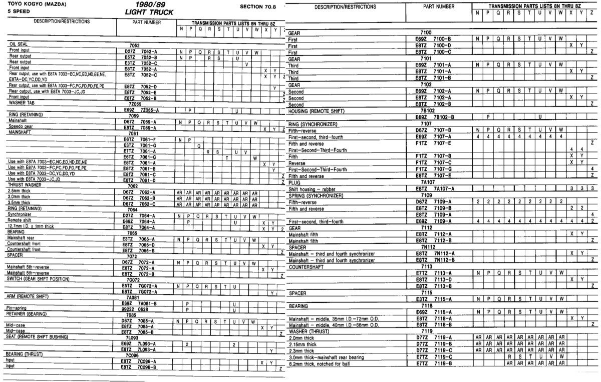

Update:
I don't like when people solve their problem and don't return to leave a record for the next poor sap lol
I finally found a parts list online.
https://docplayer.net/143013151-198...tarting-on-page-3-to-find-the-parts-list.html
From here I was able to match up the case marking with the proper parts list and found the number for the pin (hopefully).
I've attached the n-z parts list for the TK5 just in case the link is dead someday. If you need one of the other ones hopefully the link is working or you can reach out to me if I'm alive.
