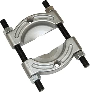

What I did was use a bearing splitter like the picture below.
I opened it up and compressed it behind the bearing snap ring. I didn't have any bolts laying around for the large threaded holes so I drill some smaller 3/8 threaded holes. I then threaded bolts in the two holes till they pressed against the front of the trans, and then kept going. I was afraid I would damage the front of the trans but it didn't.
The bearing moved some till the snap ring bent. I was replacing the bearing, so I welded two nuts to the bearing and put the separator behind those. It moved some till it broke the corner off the bearing race. So I welded the nuts on again and kept going. About 3 tries and it finally worked it off.
If you want to do this right, you need some special tools. You can see in the link above he made a very long socket out of a piece of pipe for a nut at the rear of the trans,
