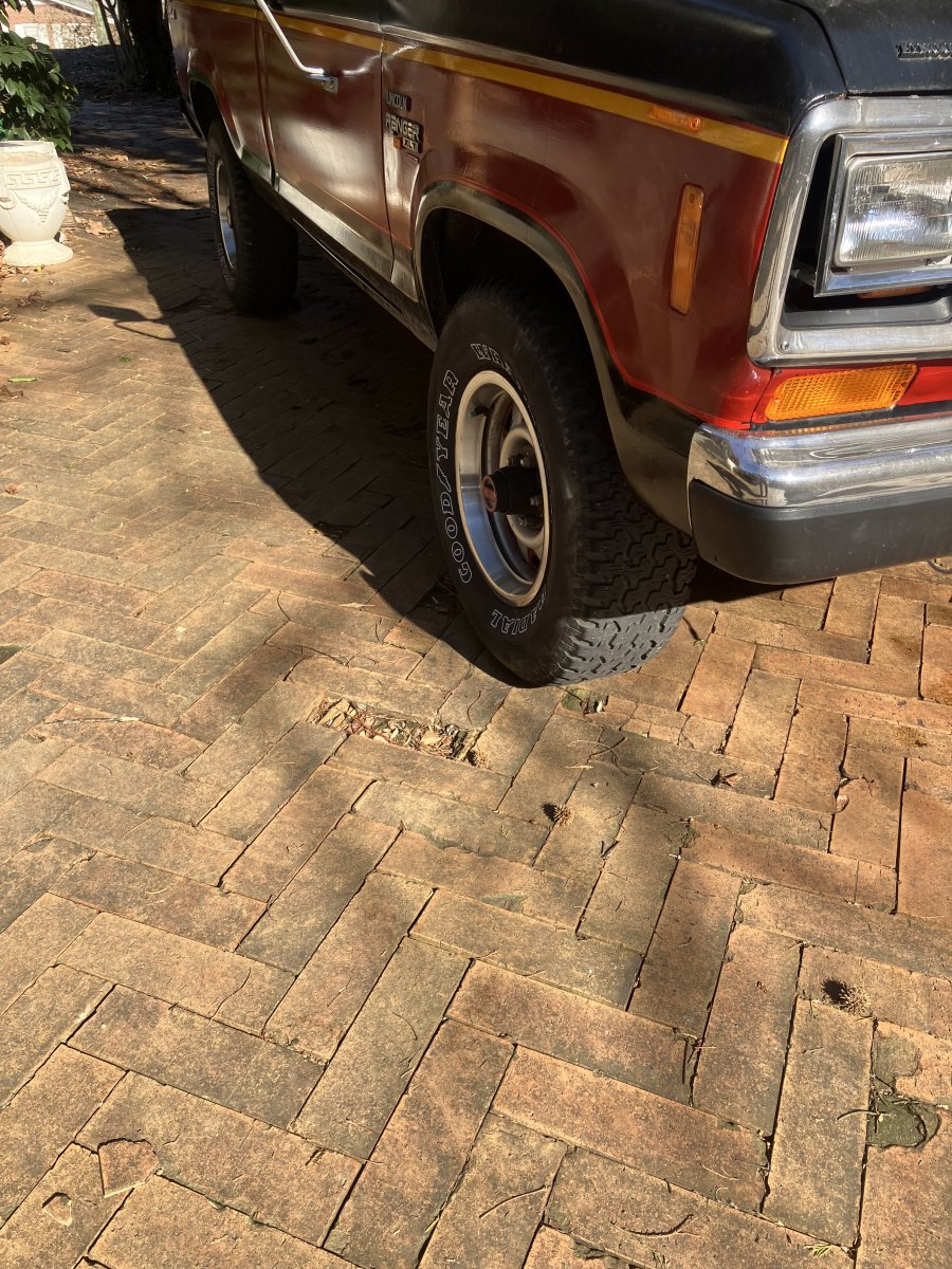

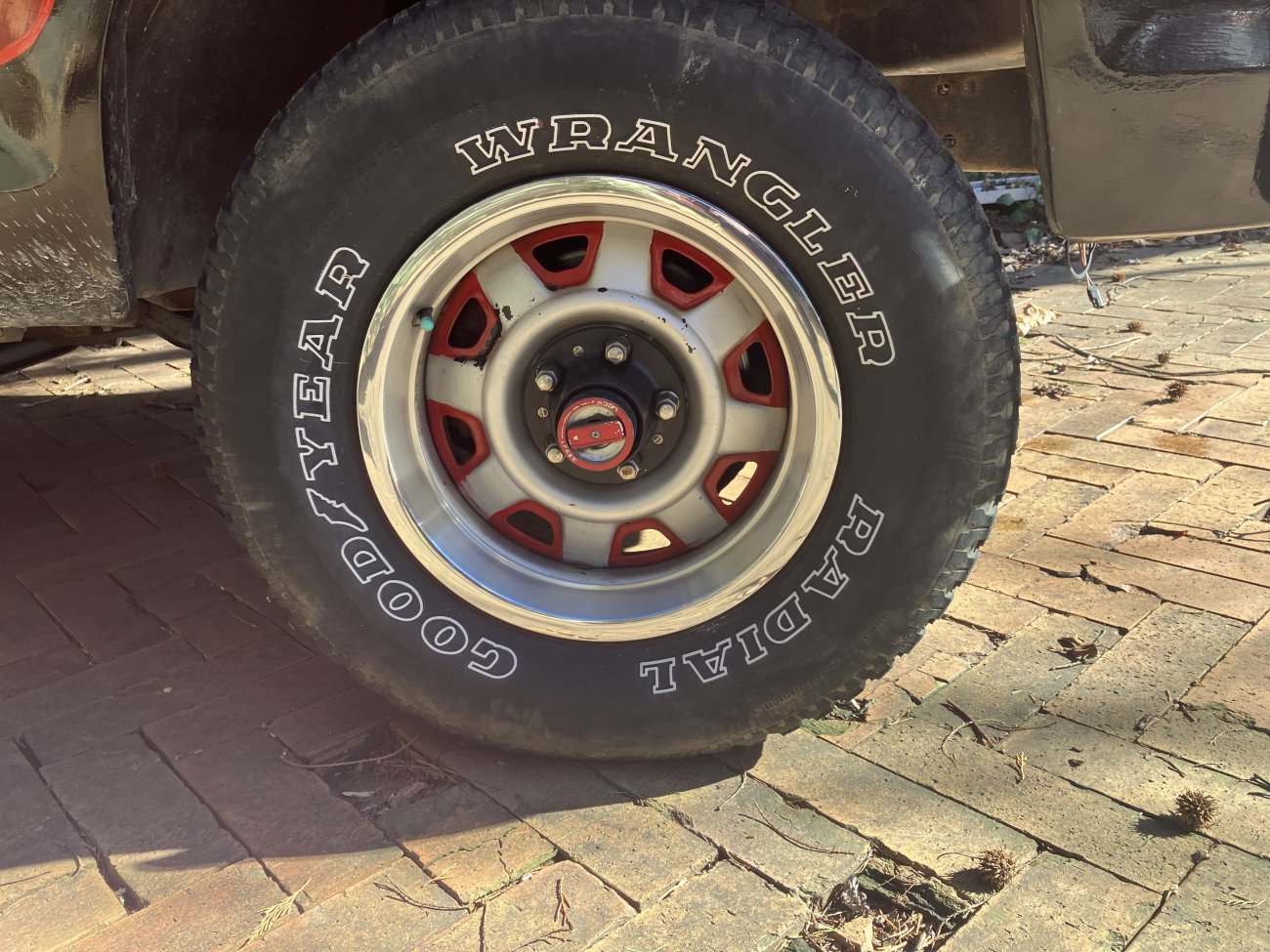

My 1987 short cab short bed 4WD 2.9 stick, the Missing Linc, 2.5-3” lift, has 235/75/15 all-terrain tires. Goodyear Wrangler Radial

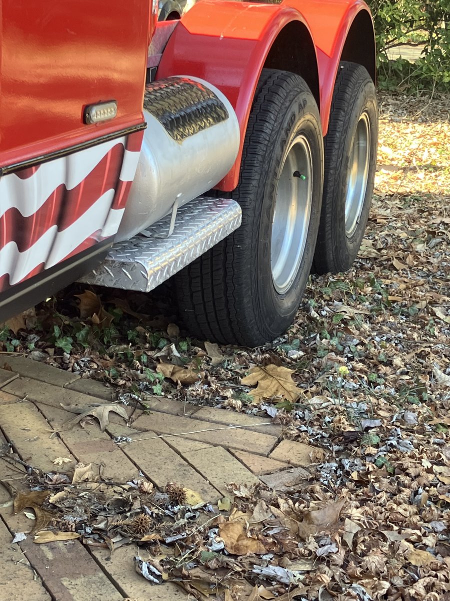

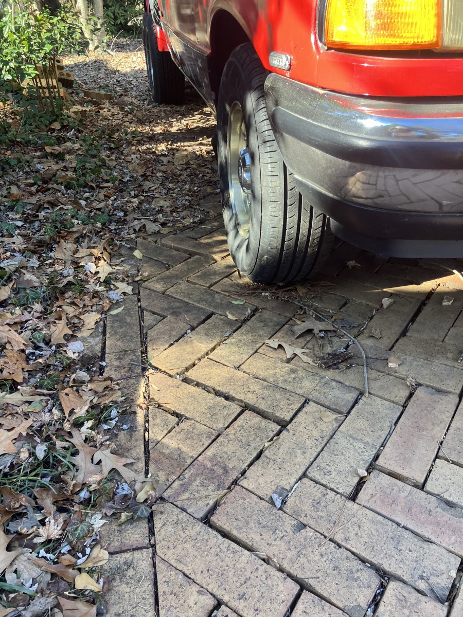

My 1997 4.0 2WD, stick, with added axle, the Road Ranger, has 235/75/15 all around. Lion Sport GP in the front (never heard of them until I got them) and the back four are Milestars
The all-terrain tires on my 87 came with the 97 when I bought it. The 97 front has tractor trailer style tires in the sense that it has circumferential cuts around the tire as opposed to any kind of complicated geometric tread pattern. The four Milestar in the back look wider, but they’re actually almost exactly the same size and profile. They look wider because they are on aftermarket 15 x 8 rims, that are also offset towards the outside.
I love them all, and they all ride great. That size has a little bit of a beefy, masculine look. Trucks should be masculine. They don’t cross that line to off-road big tires, but they do fine in all conditions.“ I haven’t been disappointed. They are reasonably priced because there’s a lot of them around, and frankly, all of mine on both trucks were used when I got them.
An important thought, something to check. If you ask the 50,000 people in this forum, what’s the correct tread pattern, you’ll get 50,000 answers. When you’re looking at the tires, don’t just look at them from the side profile and the size. Look directly at the tread pattern and see if you like it, and also look at the profile, like you were looking at the tire from the rear of the vehicle.
Generally, the Milestars have a relatively squared off line of drive shape. The contact area of the tread is almost as wide as the wide part of the tire. Ditto with my all terrains. You can buy tires the same size with a much narrower tread, or a wider tread. With a tiny bit of study, you can look at different tread patterns, and analyze which patterns are best for where you actually drive.
