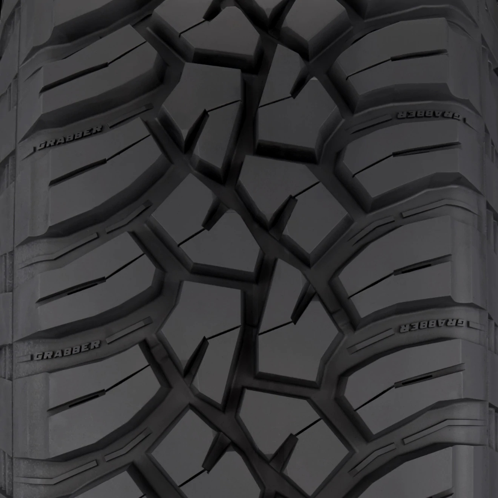

General Grabber X3 (more a mud tire I think)
General Grabber A/TX

@James Morse - all of the Generals I have ever had would either cup the inside edge or the outside edge, no matter how the vehicle was aligned.
The General Grabbers mostly have tread that is a knockoff of the K02, but with fewer sipes and bigger blocks, so they have less traction and are noisier compared to the K02.
Granted my BFGs are on my F250 and the Grabbers on my ranger but honestly i think the grabbers actually do better in certain terrains over the BFGs.
The grabbers seem to win in mud for sure. They will sling mud about like a mud tire. The BFGs cake up unless you really hammer on it.
The little bit of sand ive had them both in the BFG's seem better. Snow its hard to tell because my 250 just sucks in it compared to the ranger anyways, but best i can tell there about even in snow. The BFGs seem a bit better on hardpacked snow/ice but the grabbers better in deep stuff. Athough both do more then fine.
Street...BFG all the way. The grabbers are louder for sure and seem a bit less willing on wet pavement. Cant speak for wear on the grabbers as i havent put many miles on them...but my last set of BFs on my 250 went 50k and never got rotated. I coulda ran them further but the rear tires wore the middle of the tire cause i kept them inflated to 80psi all the time.
Both are great tires, but i think the BFG is overall a better tire...slightly.
