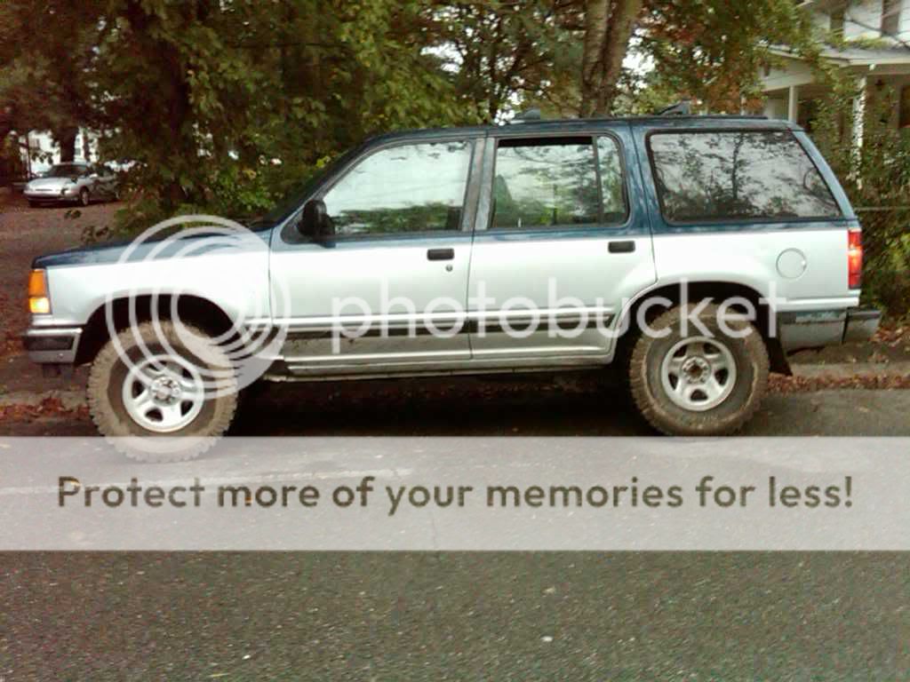

My Explorer with NO LIFT and 32" BFG A/Ts

Are those 32"s on the stock wheels?

Those are stock Jeep Cherokee wheels in the picture. Only rubbing was the inner rear wheelwell at full stuff.

I even put up a picture of my own Explorer so that you could see I knew what I was talking about. Never once did I bad mouth you or anyone for that matter. Since I could tell you were not that mechanically inclined, I even came back in a second post and explained the mods to you damn near step by step so that you could pick which one you may want to tackle. I'm the kind of person that usually only takes advice from someone that has actually done what they are telling me. There are some on here that tend to trow out ideas even though they have never done what they are suggesting you do.

Ok well sometimes things on forums can get misconstrued. I do appreciate the info u sent. What size wheels do u have on ur ex? Those tires r freakin awesome looking. Do u have any rubbing on the fenders at turning the front wheels to full left or right? Any speedometer issues? How r the stock gears with the tires?
In that picture I had stock Jeep Cherokee wheels that are a 15x7 with about 5" of backspacing. The tires were a 32x11.50 BF Goodrich All-Terrain. No rubbing in the front due to the different offset, the rear rubbed the inner fender at the top when the tire was fully stuffed. Speedo was off by about 5 mph and the stock gears were ok but 4.10 would have been much better.
