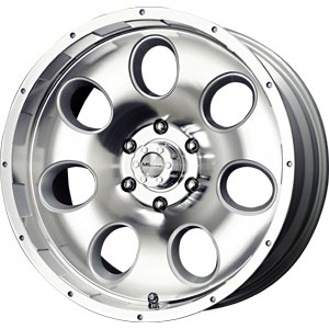

My friend ordered his wheels today thru tires.com. He got these wheels:
I also can't seem to find info on the width and offset on these wheels. They're made by MB Motoring, and are called the Razor. It's a brand exclusive to Discount Tire/tires.com/America's Tire.
I went to the website and the rims are 15x8 with a -19 offset.(5-4.5 bolt pattern) They'll fit a Ranger fine. Not sure if the 31x10.50 will fit under a stock 2wd Ranger?

Maybe the offset of the wheel will keep it out far enough away from the suspension in there and what not.
i work at discount tire and thats the exact fitment (15x8 -19) i have on my 4wd and they rubbed just a tiny bit at full lock before i cranked the t bars, he will definitely get some rubbing on a 2wd.
