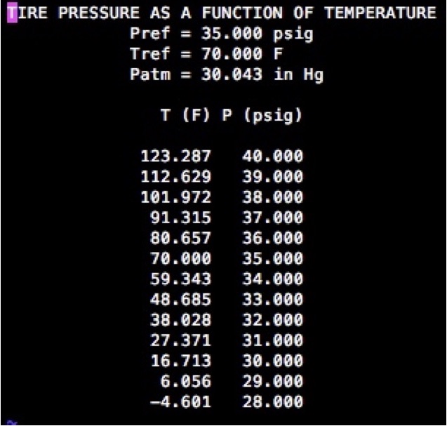

I use this table generated for 35 psig tire pressure at 70 deg F and assuming a tire, near full, to be of constant volume.
