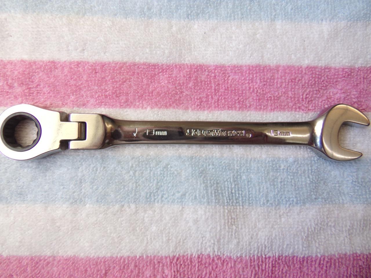

You need this wrench:
p-00947899000P
and you need to access them from the top, with at least two other bell bolts in place, and the engine/trans level as if the cross member is still in place.
I do them from below with a long extension and a swivel socket but the crossmember has to be out and the trans drooped down as far as possible. I've also done them from above like ADSM suggested - flex gearwrench or a flex head ratchet is an absolute necessity.
