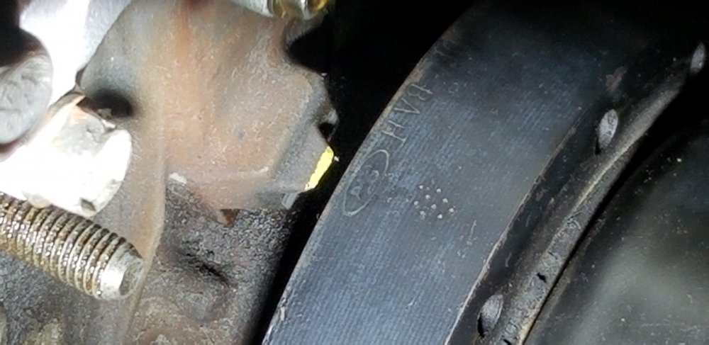

I'm about to go insane trying to set the timing right on my 1994 B3000. Can someone who has owned one please verify if what I took a picture of is the timing mark? If so, how do I read it? I thought tonight that I put cylinder 1 at 10 degrees BTDC and lined the dizzy up but the truck won't start.
So I never was able to find out if there is a specific mark in the yellow area that I painted in the pic. However the issue with my timing was that my harmonic balancer outer ring has slipped so the timing marks are effectively useless at the moment.
The timing mark should go all the way across the balancer. I really don't know much about those but found this in my Ford manual on the 3.0 distributor ignition

I am familiar. However the timing marks don't even stretch across 90 degrees of the balancer. They run from 0 (TDC) to I think 35 BTDC. That's it. It's rare but the outer ring of a balancer can separate from the rubber layer between the iron rings and slip. Eventually I will replace the balancer but for now the truck's timing is dialed in and I have other battles to fight with it. Such as replacing freeze plugs...
Maybe the US assembled Rangers have a different balancer than the Japan assembled Mazda.
I found that to be the case in my 93 Ranger donor tranny from a 94 Mazda. I knew well ever bolt on the Ranger, but they were all different pulling the Mazda.
I came to believe the assembly line being in different countries was the reason for this.
Not sure if a Ford engine ships with the balancer in place or not but they could be a little different
