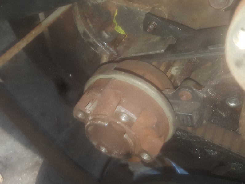

I got the cylinder head all finished and I went to start and it just turns but doesn't start which make me think timing is still off. I cant find any mark on the crankshaft anywhere i'm sure that's the one out of sync also i don't have a triangle or diamond on my cylinder head sprocket just an indent I will include photos. Can anyone spread some insight

NVM all I've got her running!! 5 months project taught myself how to do a cylinder head and work on trucks! whoo whoo!!!
You oughta buy a camera or a gadget that will take a clear picture. All so far are fuzzy at least on my computer screen.
Why would you scribble in red all over any sort of mark you are trying to show people? At least let them see what you see instead of hiding it.
The crankshaft will be at TDC for #1 and #4(they move in unison), when the keyway in the crankshaft is at 12:00 o'clock.
