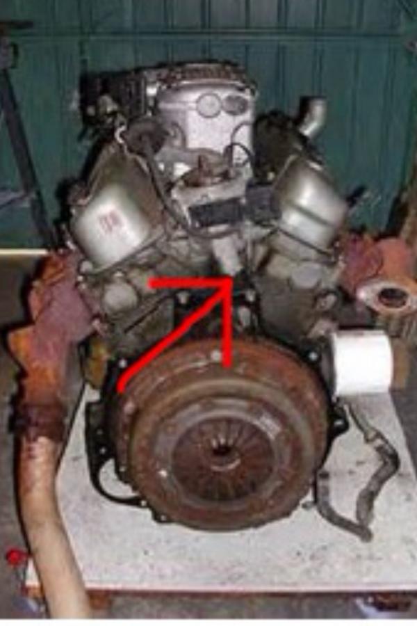

There's a bolt there. Is it buried in oily dirt and grime? Scrape it out then use a air gun to clean it up. It will be either 1/2" or 9/16ths.
Or 13mm as this is a Metric engine. It is very hard to see that hold down bolt; especially if it is dirty.
Check the timing FIRST - you rarely have to move the distributor once it is set, even after a tune-up.
Check this site for timing instructions.
Feel down the distributor as far as you can. It will be at the base of the distributor. You'll have to feel for it cuz I don't think you can see it.
Why are you adjusting the timing did you check it first by disconnecting the spout wire. There are six wires coming out of the side of the distributor. One of the wires has a connector just unplug the connector and it should be at 10 degrees BTDC. Use the pointer and not the round thing you may need to clean the pully marks it is best to do it from underneath and put a white mark one line back from the 12 on the pully. You must disconnect the spout wire to obtain base timing. The bolt is 13mm and under the crossover tube in the back of the block. It is hard to see and even harder to get a long wrench on, a stubby 13mm box end wrench works the best. Normally the timing will not change unless the cam gear on the dizzy gets worn down. The cam and crank are gear driven and rarely if ever go bad.
