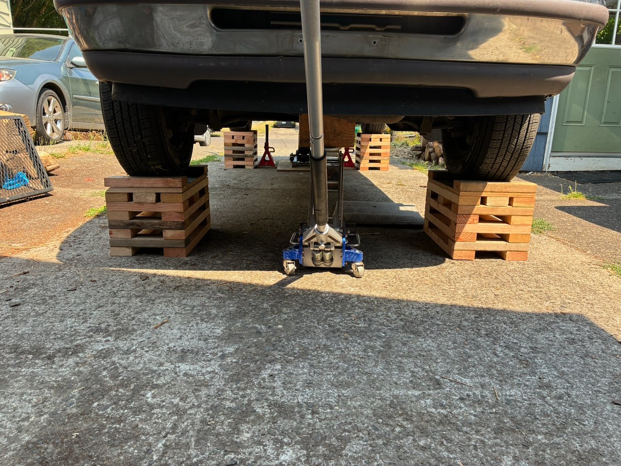

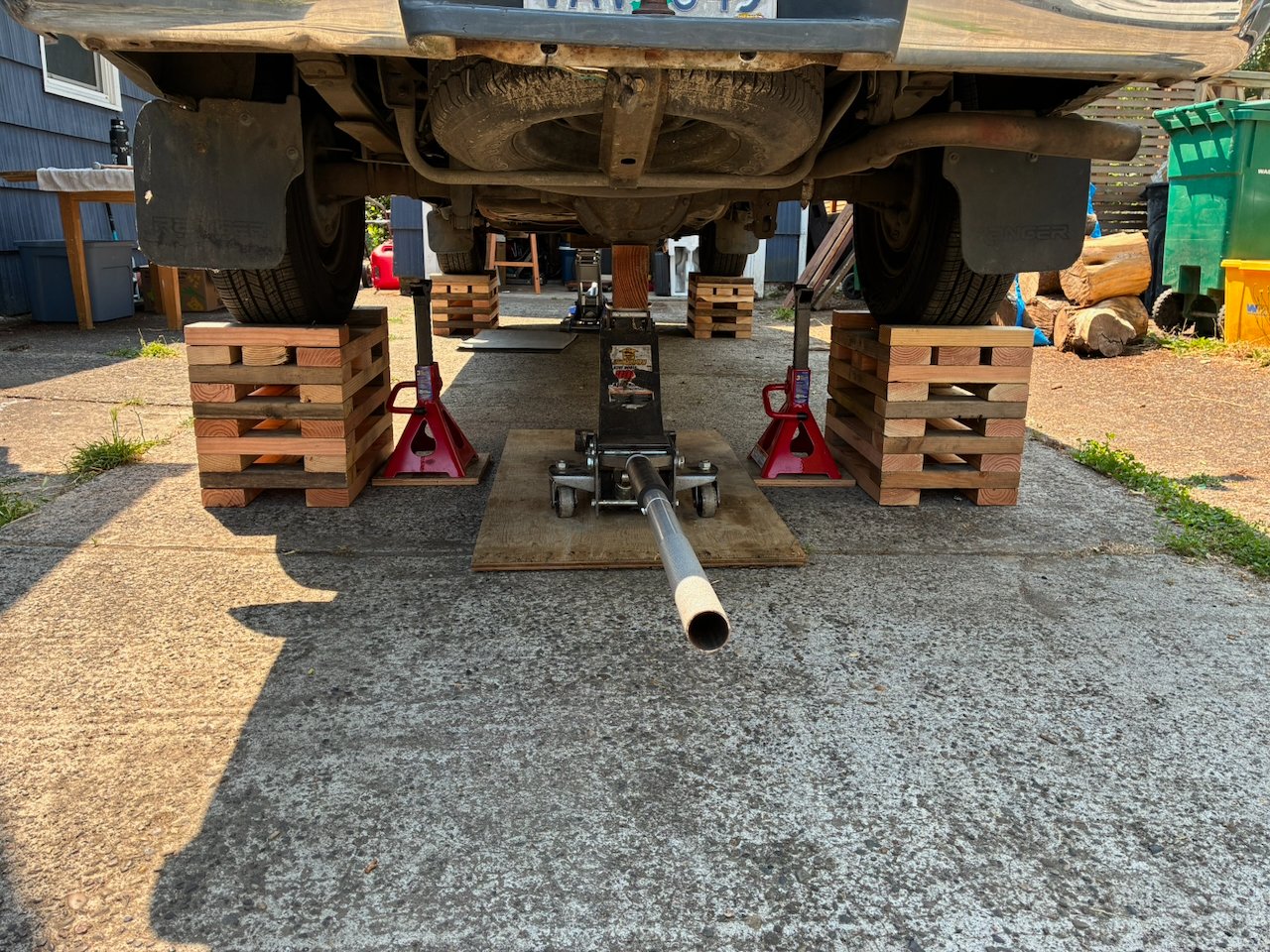

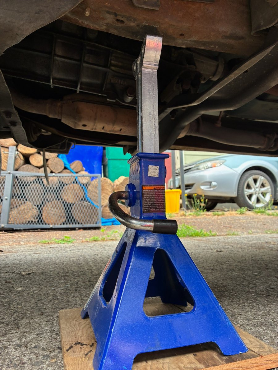

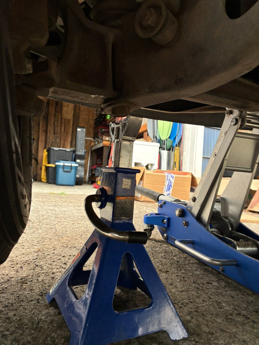

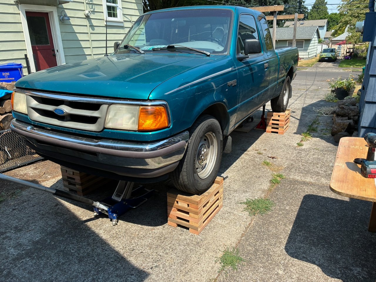

Getting to the clutch today. I've got the rear jacked up nicely and secure. Not sure of the best spots for the front jacks.
First pic uses suspension and is most out of the way but I'll lose quite a bit of clearance. Second pics uses the frame and keep clearance but seems really in the way.
Recommended location for clutch job?

They're ALWAYS in the way... I usually put them under the I beams because that's the most stable... but also why I was suggesting ramps up front backward... easiest to just jack up the axle from the beam and set the ramps under the tires...
If you had some cribbing or something to get them up higher going to the frame in front of the front suspension is much less in the way...

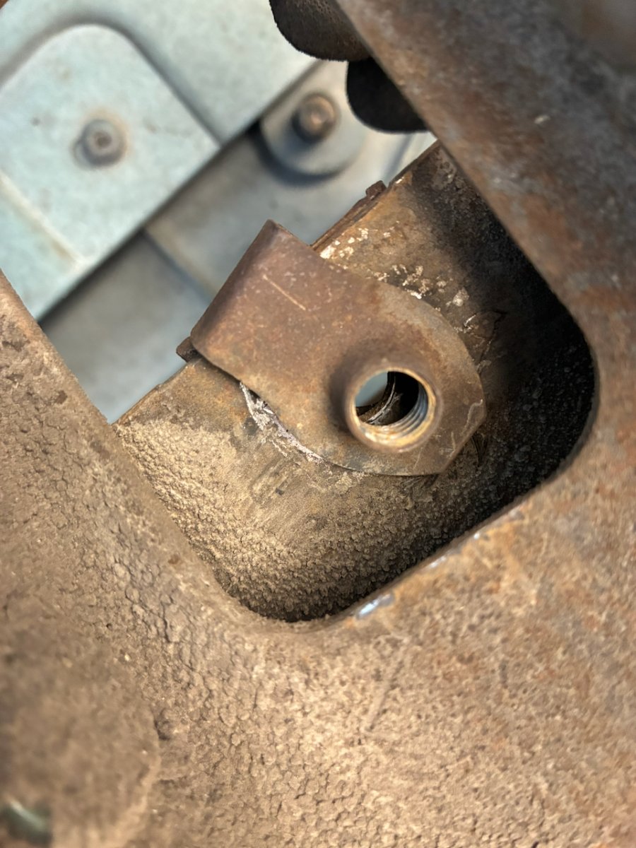

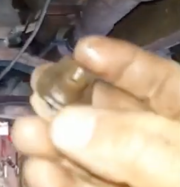

I'm stuck at trying to remove the center support for drive shaft. I have the bolts out but I can't see how to get the clips out. I found this video that has the same clips at the 16 min mark and he is putting the clips on the opposite way that mine are installed. The clips are quite loose but I just can't slide them off.
I assume there is some part down into the hole?

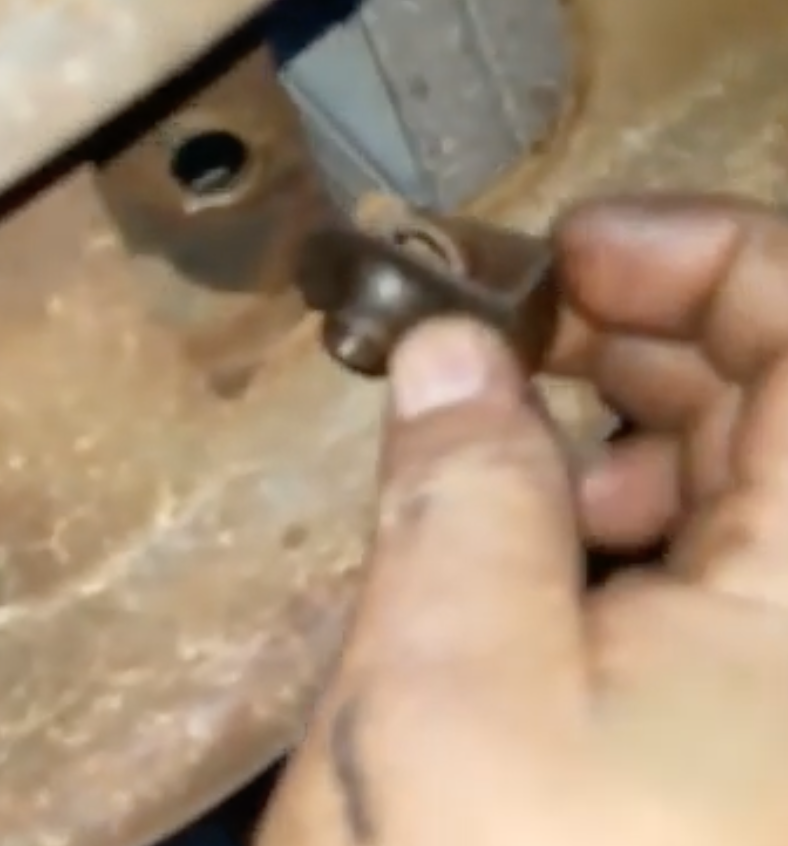

It's not a good pic but here is the clip

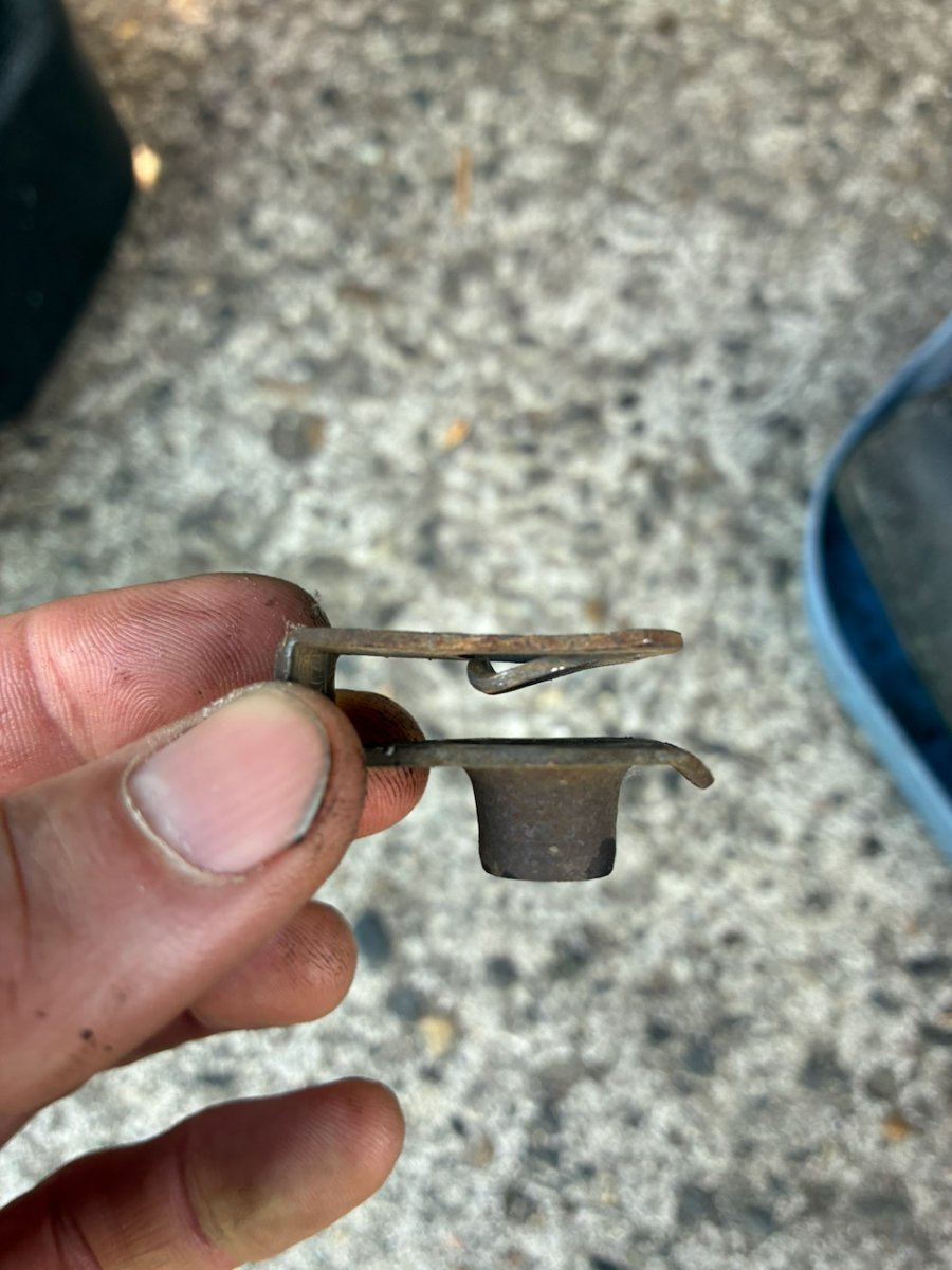

I got it eventually. Here is a close up of the clip. Is there any reason the bolt has to be threaded down from the top instead of up from the bottom? Looks like it can go either way and it was a very long time getting them out. I had to cut one because there is no room to swing the tool with the bolt head so close to the gas tank.

Unfortunately I haven't even looked at that crossmember on my '97 but there has to be a way for the fasteners in a usable direction...
i agree. i see no advantage to installing with bolt head on top side and every reason not to.
Guess I’ll be flipping those over while the tank is out and the bed is off…
