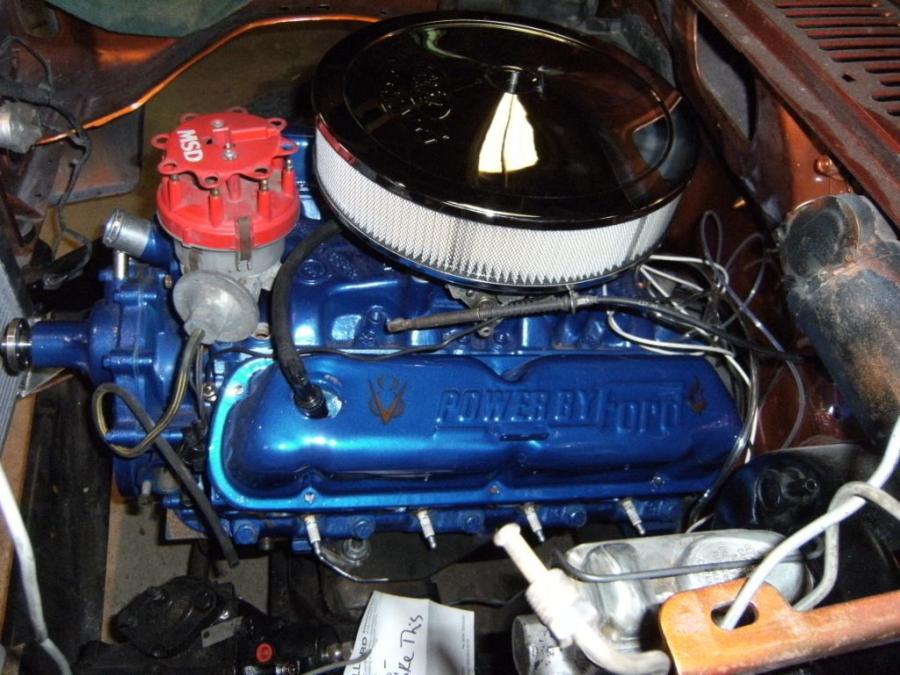

Hi guys,
here is a mocked up picture of what the engine will look like when complete, used an older dizzy for the pic, have a billet new one to put in when time comes.
the carb is an edelbrock 600, on offy intake.
the problem i am seeing is the length of the throttle cable is 3 or so inches too long to hook up to the stock 2.8 linkage.
How have you guys run your throttle cables and is there a kit I can look into getting?
thanks

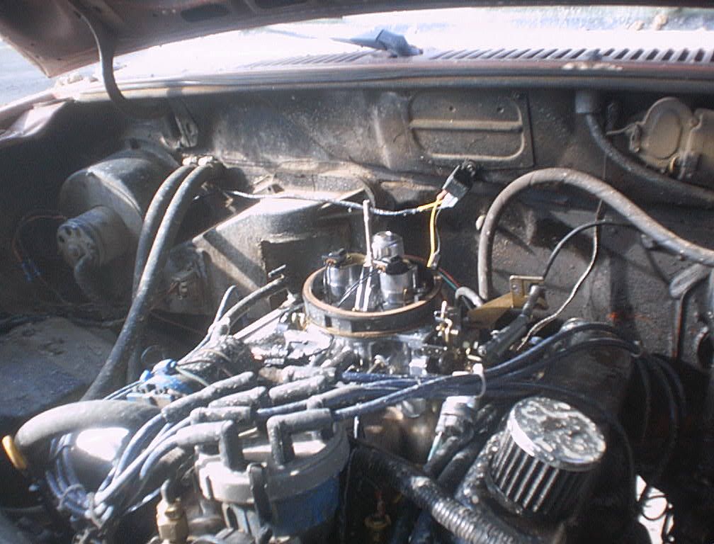

On my 84 I just modified a bracket to hold the throttle linkage at the proper length from the hook up on the carb (pic has the Pro-Jection set up on it, but it worked the same). It did put a slight curl in the line, but it doesnt bind up. You can kinda see the bracket in this pic......
Hope this helps a little....
