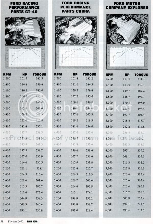

Shane, I have saved a lot of head flow charts but this one really is the best with the added flow %. I'd rep you also but it said I have to wait!

Between that chart and the one on www.carbdford.com - I chose to run the P heads. The chart on carbdford.com use to have (for some reason they removed it) the Explorer GT-40 flow numbers, which actually flow slightly less than the regular GT-40 heads IIRC.
I'm sure you've seen this one before?
http://www.carbdford.com/tech/flowdata.htm
EDIT: I should learn from you and save things like that. I had a rough time finding that again. I also can't find the intake manifold flow chart that compares the Explorer/GT40/Cobra intake manifolds I liked.

I thought that "fencing" question might come up. Dig cylindrical holes in the ground and putting a large square peg in it. The intake info you were looking for is over at AllFordMustangs in their 5.0 sticky tech area. Tell the difference between the styles and years.
http://www.allfordmustangs.com/foru...ficial-explorer-gt40-cobra-intake-thread.html

All those charts are from a book that can be found at your local Barnes & Noble store. I looked thru it just yesterday. :D Don't recall the title but it was something like "Dyno Proven SBF combos"

THAT'S IT!!! Maybe that's where I have it, in a Super Ford mag. Thanks Dave!
