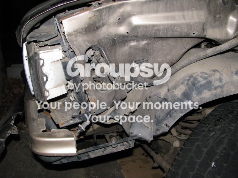

Close-up of the carnage.

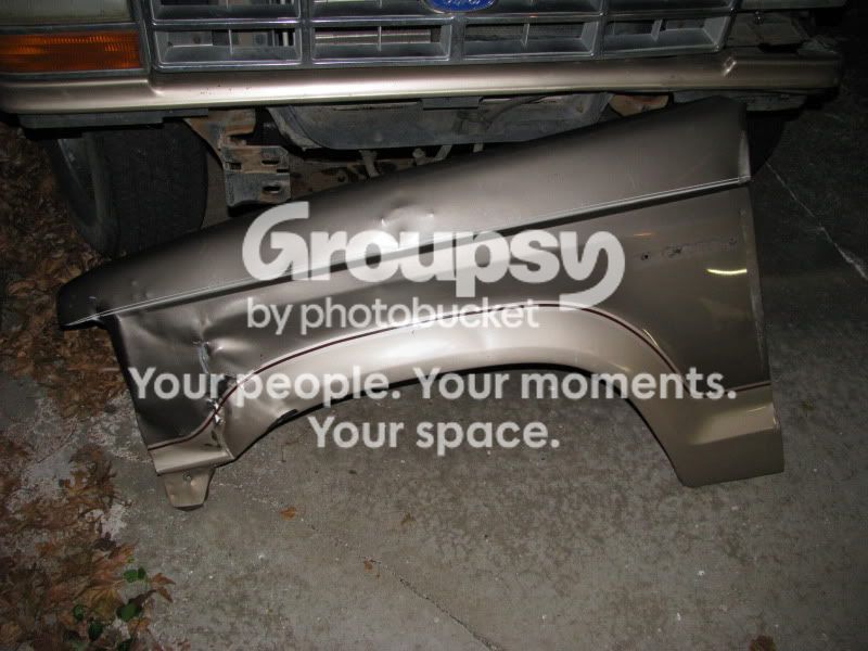

Then I pulled off the front bumper and the left fender. I flattened and hammered it out a bit just to see whether it would be acceptable to put back on rather than replace. With my intention for this truck, I'm ok with this, as long as I can get the door to open and close correctly once it's back on.
The bumper was too solid for me to bend by hand, so I may just leave it off, or bolt it back on and pull it out with a come-a-long against a tree.

The biggest challenge I have yet to deal with is the inner fender and core support. They are both pretty ****ed up, and the metal is heavier gauge than the outer fender so it's not as easy to reshape. There's not much room to get a hammer behind it so I may have to get a slide hammer after it.
