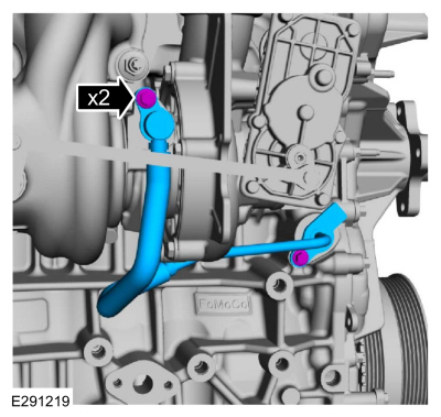

I'd be interested to know how easy/hard it is to access those fittings.
CMOS
This is Why You Never Run Extended Oil Change Intervals on The Ford Ecoboost Engines! - FordTechMakuloco
Passengers side of the motor, picture is more or less the view from through the fender well.
Just one hard line for this engine/turbo?
CMOS
Only one turbo. So it makes sense there would only be one line. I think only the V6 engines have two turbos.
That number2 is a filter screen?
Yes. My impression is that it's built into the oil supply tube for the turbo. Once I get a chance to pull mine, I'll confirm if it is permanently installed or not and if it can be cleaned with brake cleaner or some other cleaner.
