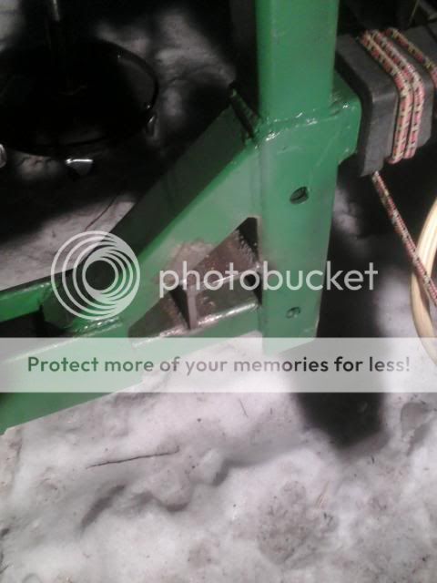

Some pics of welding 1/4" square tube with my flux core lincoln weld pac 100 - first pass, the goober welds up front were not mine and were ground out and rewelded later;
After paint, with afterthought addition. You can see the top where I ground out the goober and rewelded;
