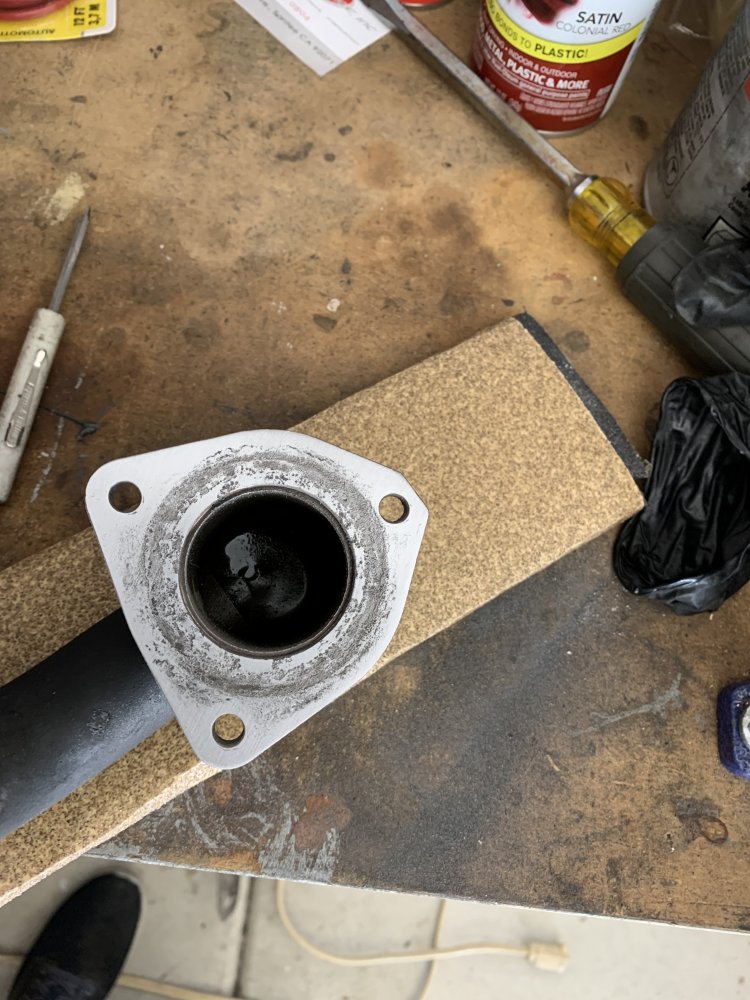

Thank you for the help. I had successfully installed the T-stat today, not without a couple of bumps in the road. I took the outlet cover off and cleaned up both ends where the thermostat sits, started cleaning the outlet cover and noticed how pitted it was

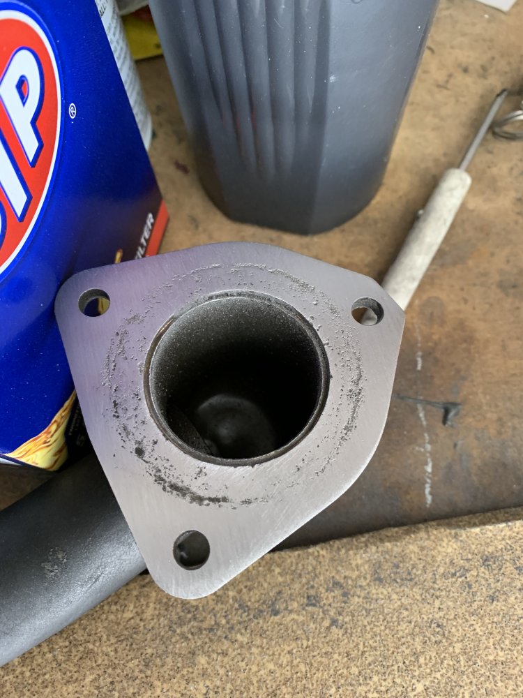

So I had my daughter re surface the old cover while I went back down and returned the kit, picked up the original thermostat I had purchased before and installed it, my daughter did a great job
I have a thick piece of glass that I’ve used many times, then wrap the sand paper around it and it’s a flat surface. It was good enough to make a good seal.

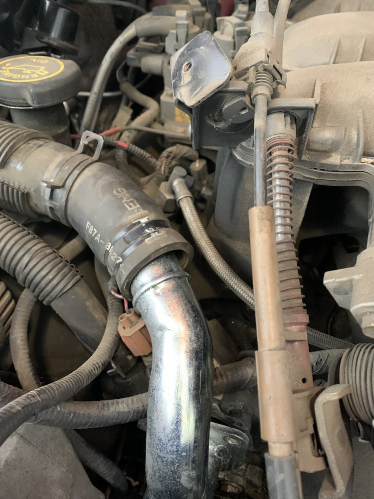

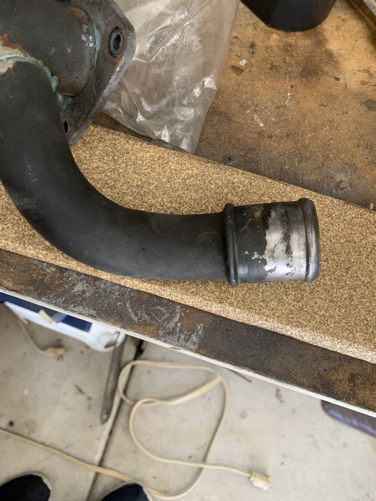

Just be careful with the aftermarket parts, anyone who reads this before replacing the thermostat, great idea and well thought out by the parts industry but make sure it’s the right part. The original steps up to a larger diameter to make the hose connection work
The replacement part didn’t have this as seen in the picture above, just had the same diameter all the way through and was too small. Overall a successful day it just took 6 hours to complete a job that may have taken 2 hours lol
The pitting is from Galvanic corrosion which happens when two dissimilar metals are in contact and there is a fluid present that can transfer electrical current
The t-stat housing is steel, the intake is aluminum
But..........if you change the coolant every 2 years, as spec'ed, this corrosion is minimized
Standard coolant, the Green stuff, has corrosion inhibitors that last about 2 years
You will find the same pitting/corrosion where the aluminum intake and cast iron head's coolant passages meet up
In fact it is a common leak point as this corrosion eats away at this connections gaskets as well as the metal
But as said, change the coolant on time, and no leaks and minimal corrosion

Interesting I didn’t know that about the electrolysis & the 2 year recommendation, good information. It looked extremely nice and clean inside the thermostat housing :)
