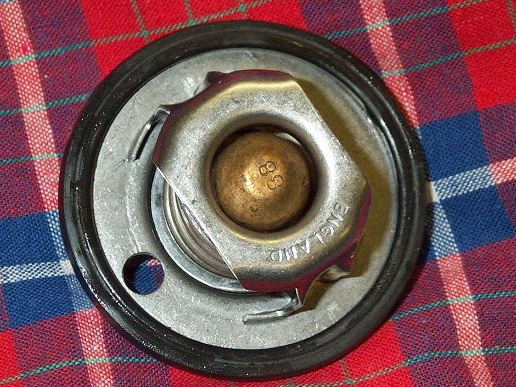

heres a t-stat with a bleed hole from the factory:
Like I said air trappage in the cooling system of the 3.0 engine is not a problem... if it were then Ford would have put a bleeder on the engine.
Trust me on this one - instead of wasting your time drilling holes and what-not, give your new 'stat a couple of weeks to run in, and I think you'll find that it will settle in nicely and will quit causing your temp gauge to fluctuate.
small v-6's are usually kind of a bear to bleed. IIRC, there actually is a bleeder located higher up on the newer engines because ford realized it would help.
t-stats are cheap...its not worth risking a motor on one that could be damaged. id throw a new one in there with a bleed holes and make sure the system burps before you take it for a spin.
