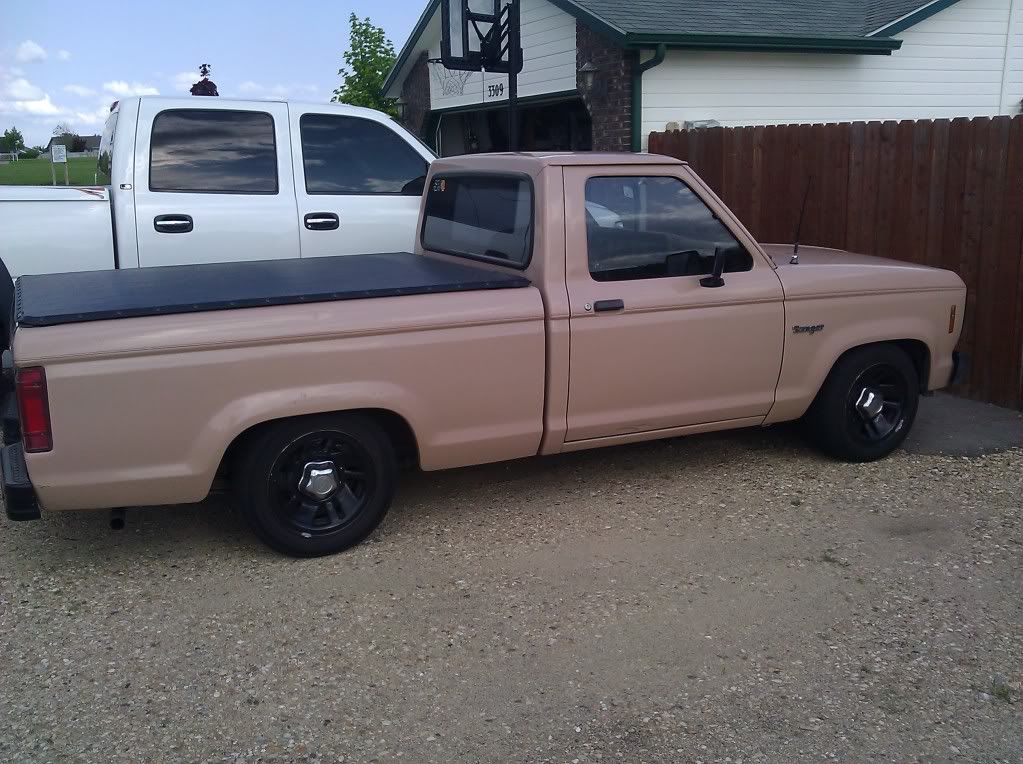

What do you think i should do to drop my truck down an inch or two in the front, should i go with the splash springs or get 2" lowering springs? I want the whole truck to be under the fenders :headbang: lol! Here is a pic of how it currently sits:
So if i go lower in the rear will i need to notch the frame? I installed the DJM 3/4 kit but the rear went about 4 and a half inches so i want the truck to sit even all around. Thanks for your time!
