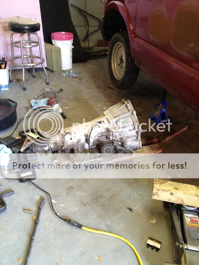

Worked on it again today but didn't get a whole lot done. Couldn't get the tranny crossmember off, couldn't get the flexplate to torque converter bolts loose. Did drain the tranny and took the pan off, fluid looked great and the magnet was clean - really happy about that.

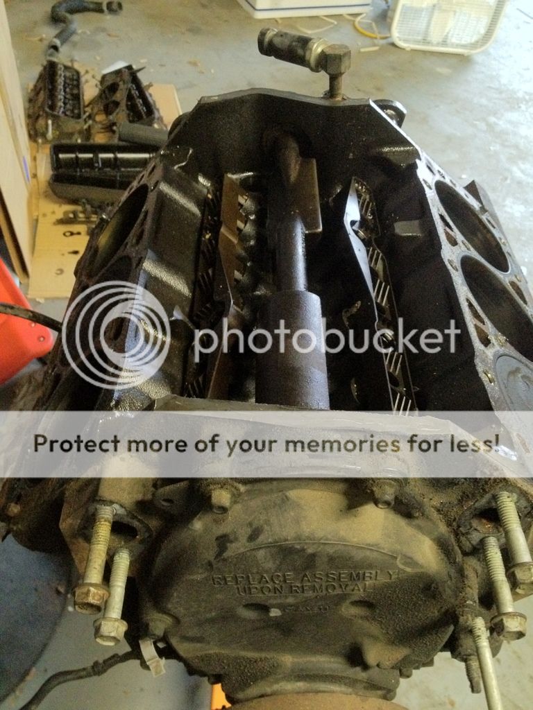

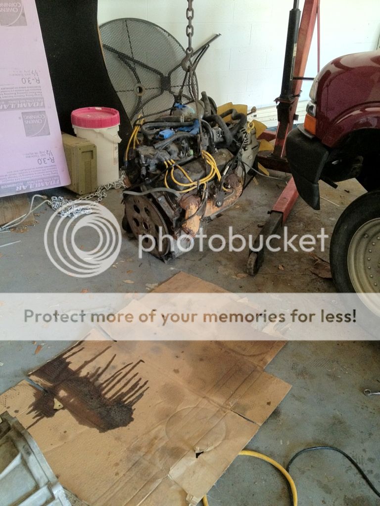

One more chunk out:

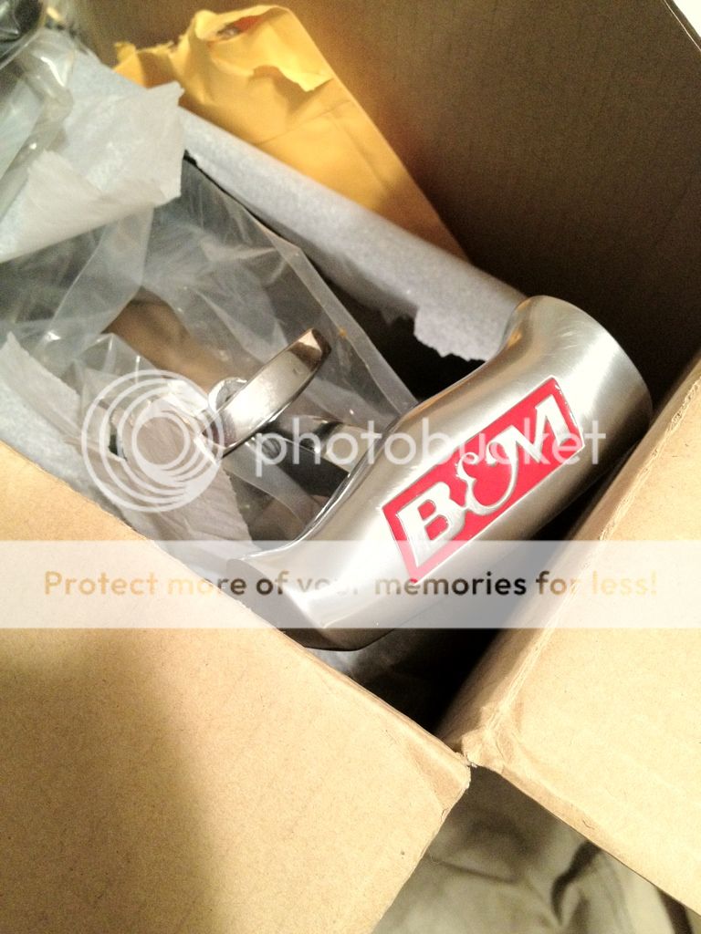

Also got the new shifter on order and the ported throttle body will be here this week.

New shifter... Ooh shiny.

Also mocked up the shifter a little better. Not mounted, mainly because I don't think I can get to the bolts with the tranny in place, but I think this is where it is going to end up.
