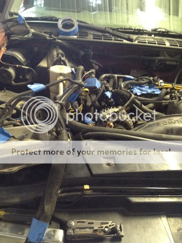

Tagging and bagging:
Basically done with that. Drain the fluids, pull the midpipe, pull the coolant, AC, power steering, and fuel lines, and pull the driveshaft this weekend. At least that's the goal. Then disconnect anything else that's still on the following week, hopefully ready to yank it out by the following weekend.
Also have to flush the dexcool out of this thing. What a stupid idea that was.
Man, you did all that with a Leatherman?? You're one hell of a mechanic! Haha
