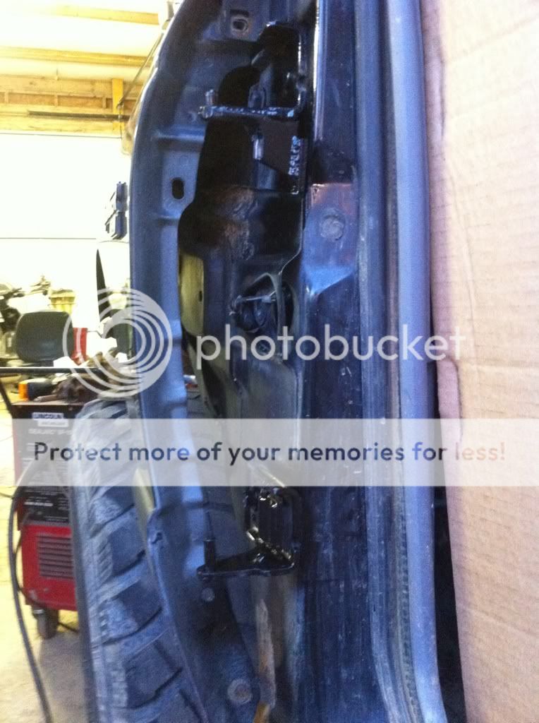

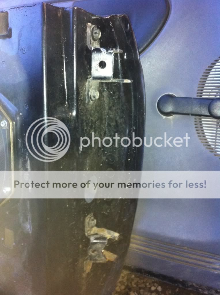

dont have any pics uploaded yet but i got my driver door hinges done tonight, havent tried the full door yet. but i can pull the half door in about 10 seconds easy on easy off its going to be nice
sorry for the shitty pics it was getting dark, i welded a brace to the top hinge to help hold some weight thinking about doing the bottom also
it didnt work exactly like i planned, but it will work. took the truck for a drive no rattles just have to do a little work aligning everything back up and cut up another set of hinges for the full doors
Yup, the bottom pin is longer so that you don't have to line both hinges up perfect just get the bottom in then drop the top down. I'm going to brace the bottom hinge also.
Probably would have been alot quicker to just take out the stock pins and throw in some pull pins but I didn't want the trouble of trying to keep up with them, this way just open the door lift up and it's off
its so much better already, it didnt take me long to switch doors before maybe 10 minutes but it was a pain in the ass trying to hold the 80lb door with my left hand and get a bolt started with my right and trying to re-align them everytime.
and plus the way i did it the only thing i modified was the hinges so if i wanted to go back all i would need is new hinges, the brace on the top just sits against the sheetmetal its not welded
