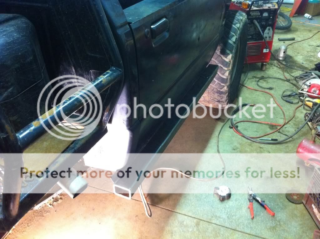

if i do the only sheet metal left of the front will be the hood, and it will probably get cut also.
ill have to cut up the front bumper a little but i think i can make it work
finished up the passenger side until i decide how im going to tie them into the bed

Like the sliders. That what I want to do with mine once I get around to it. Need to bring them up and in, but I'll be keeping the round tube as apposed to square.
I don't think that was a good idea welding the tube to the rockers....Now the tube is part of the body, only the tube is welded to the frame=solid mount...and the body is mounted to the frame on rubber mounts=movement during flex...Something is gonna give and break...Other than that I like how you have it tucked up nice and high :icon_thumby:
SVT

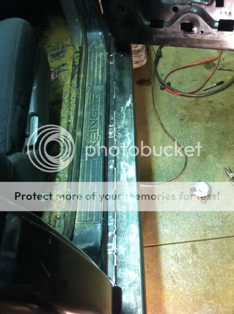

they arent welded to the body, its still all seperate...there is just flat bar welded inside of the 2x3 to keep mud out from under the door
there will be some tube stand off's from the square tube to pivit off of and the square will be good for sliding over the rocks.
they are pretty solid, im gunna see how they hold up to the hi-lift tomorrow
i have seriously gotta make some stronger sliders. think i'm gonna do something like the trailgear 4runner sliders with hoop.. just seems to offer the best overall protection for underneath and the tube for protection of the curve of the body.
Ahhhh, okay...Good thinking :icon_thumby:
