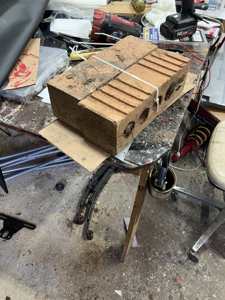

And in case anybody’s wondering how you get them to turn out flat:

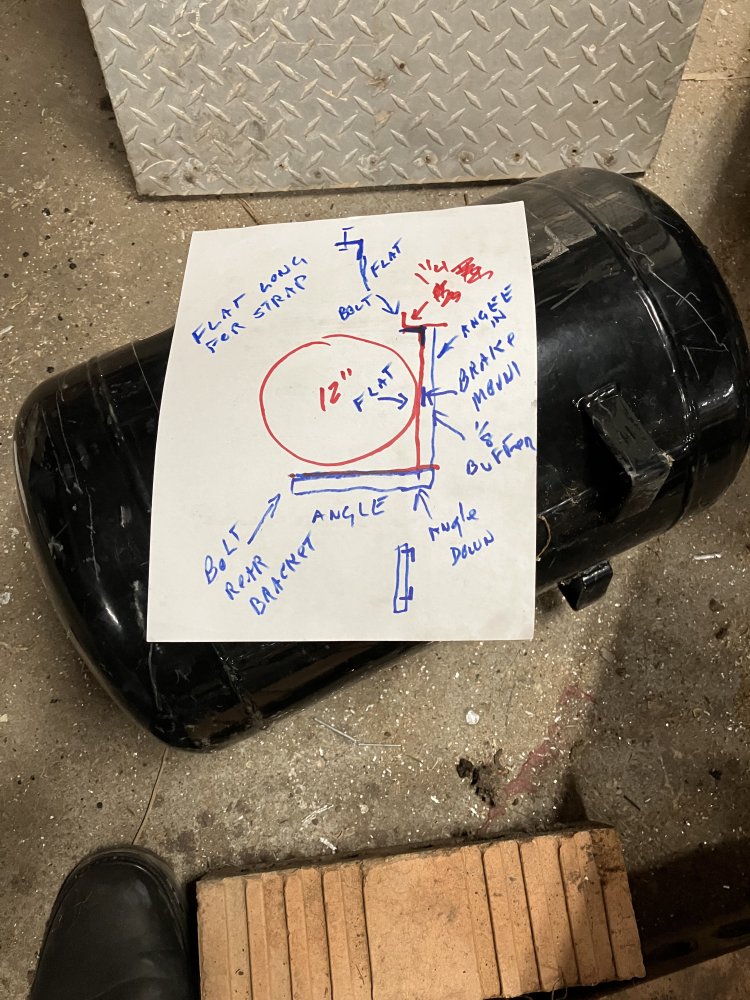

I wasn’t ready to quit, so I started to figure out how I’m going to hang the air tank (that will look like a gas tank) just behind the drivers door. I don’t know if I ever shared one of my proprietary blue prints with you guys before. I struggled over this one five or six minutes:
The Road Ranger.  1997 SEMI
The diamond plate in the picture is the second lid of the toolbox that I’ve been cutting up for two years. I’m going to make it a hinged top over the tank.

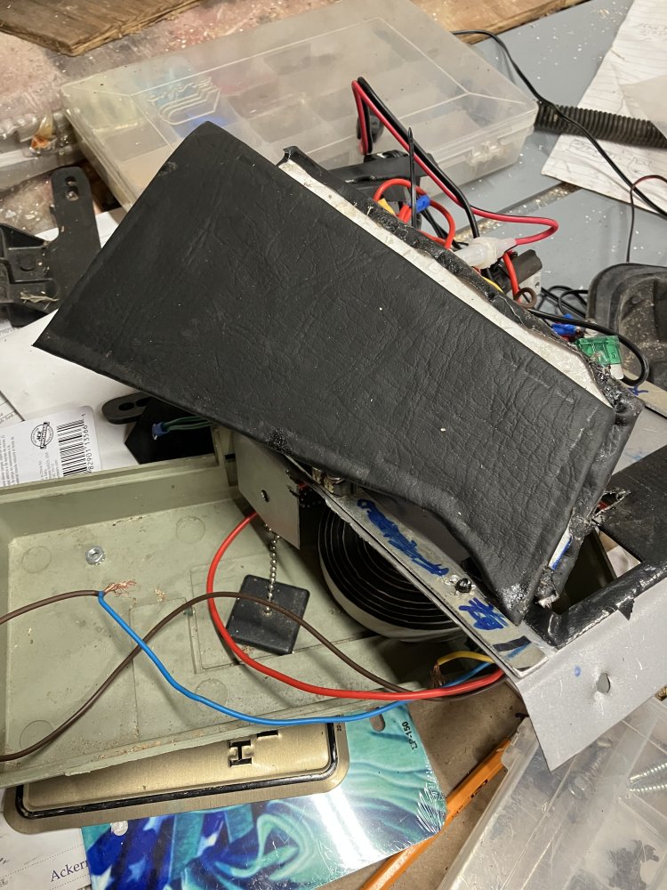

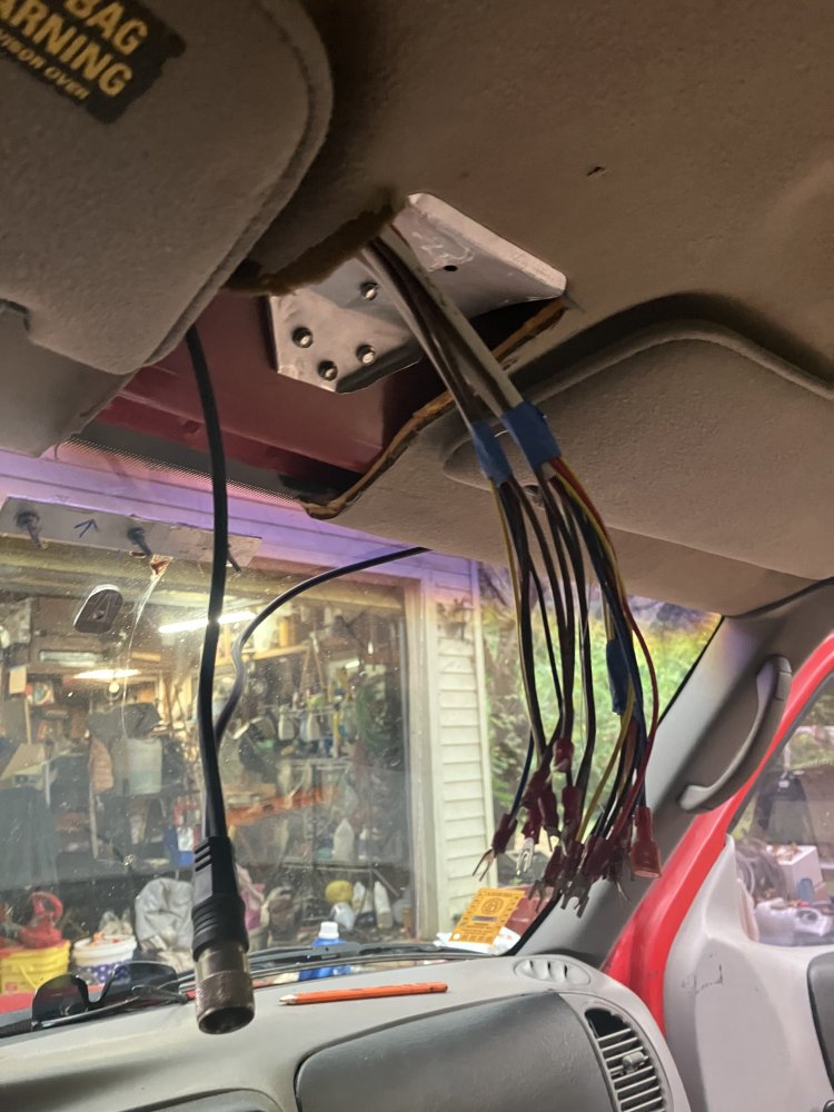

Well, I thought I had it all down perfect, but when I was doing a test mount of everything, the CB was hanging down to low, so I couldn’t adjust the rearview mirror. I actually discovered that a couple days ago. I thought long and hard over the solutions. I didn’t want to cut the middle of the headliner out. The whole time I’ve been doing this, it’s been like working with a fragile antique, every time I touched the headliner (which is near perfect) it crumbled.
I thought of mounting a new windshield clip, but then the mirror would be too low and right in my line of sight. So I finally sliced out the middle of the headliner, about an eighth of an inch of time, so everything was snug up in there. I had to flatten out the back part of my new mount that bolts to the windshield, and put that fold further up so it would all sit further up. It’s still very close.

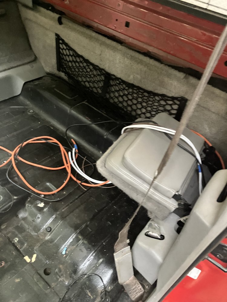

Today I took the seats out, and the whole left side of the cab apart, to route the wires. I pretty much had it roughed in a couple years ago, but as I got more exotic, I needed about five more wires, and then some spares. The goal was to get it from the CB location and down the side of the windshield in the front, and run it over my head, an out under the jump seat behind me, ready to poke a hole somewhere to carry it backwards. I also crimped terminals on all the overhead wires.
I ran out of sunlight, and I was creeping up on a Halloween party, so that’s where I had to leave it for today.
Now I just have to lay down on my back upside down and backwards, and screw all the terminals down.
I have new carpet, and there’s a couple of other things I want to do while the interior is out, and then I have seat covers also. I think I can finish the wiring in a day, but it’s probably going to take a few days to get the rest of the interior where I want it. and it’s still coupled to the trailer, I wanted that, so when I finish up the wiring behind the cab, I can test everything at one time.
But hey, it’s progress.!
(and yes, that is a piece of a 16/3 extension cord. Of course it was in the shed of miracles, and have you checked out the price of wire lately?)

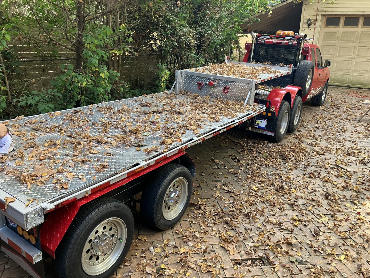

Yesterday, when I went out, the first thing I had to do was blow the leaves off everything. Here we are less than 24 hours later:

I didn’t have it in me to do it again just for an hour or two, so I just sat at the workbench a little bit.

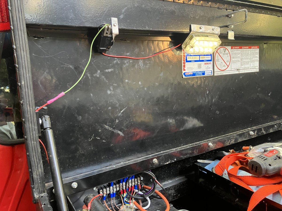

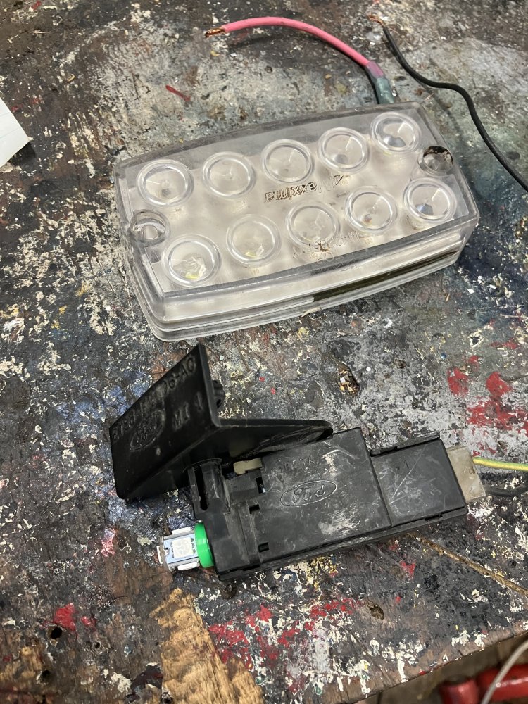

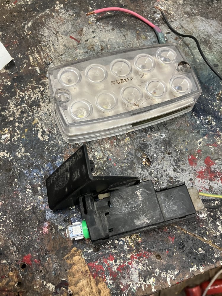

I dug up a 10 LED light that was in one of the weather guard truck boxes when I got it, and I got a mercury switch from under the hood of a town car in the scrapyard a zillion years ago. I had to take the switch completely apart and clean everything and put it back together, but when I did it worked like a charm.
Then I made a little bracket for the light, so when the lid is up, it will actually shine down at a 45° angle. The LEDs are focused, so if it’s flat under the lid, when you open the lid, it points at the guy behind you.
To make the mercury switch work, I just took the bulb out, and I used a female bayonet connector to stick in where the bulb was. The light is grounded, so I will only run the hot wire through the switch.
I also cleaned off the workbench so I can see what the hell I’m doing next.

I checked it out later after dark when I walked Lincoln. Doesn’t light worth a damn (if you think about digging in the toolbox on the side of the road when you’re broken down and pissed off). Switch works great. When I catch up on everything else, I’ll probably swap it for some LED strips under the edges. If I got paid $2/hr, I could’ve bought 15 flashlights….
I’ll clean up the wiring so you can’t see it with some cable tie stickers before I finish…

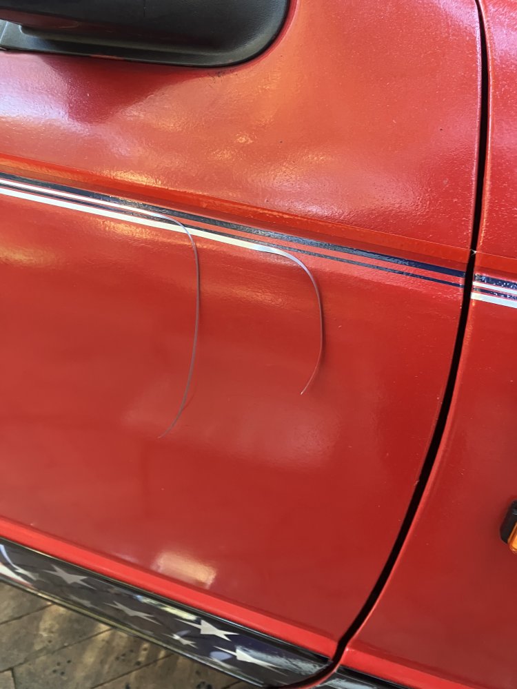

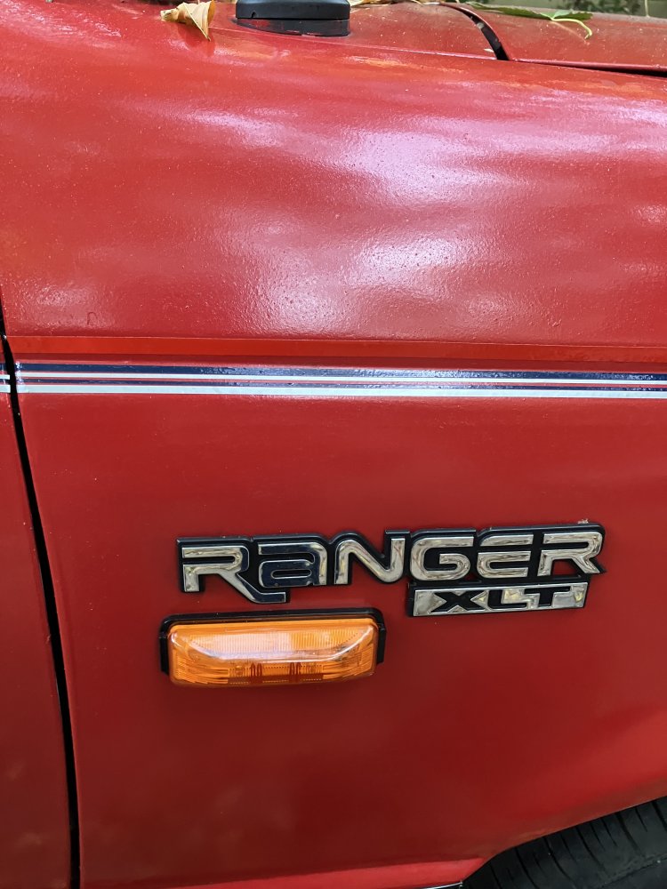

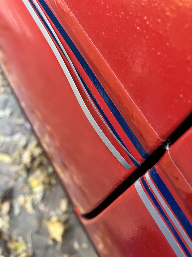

I think I finally got the pinstripe where I like it, now, the damn thing won’t stick!

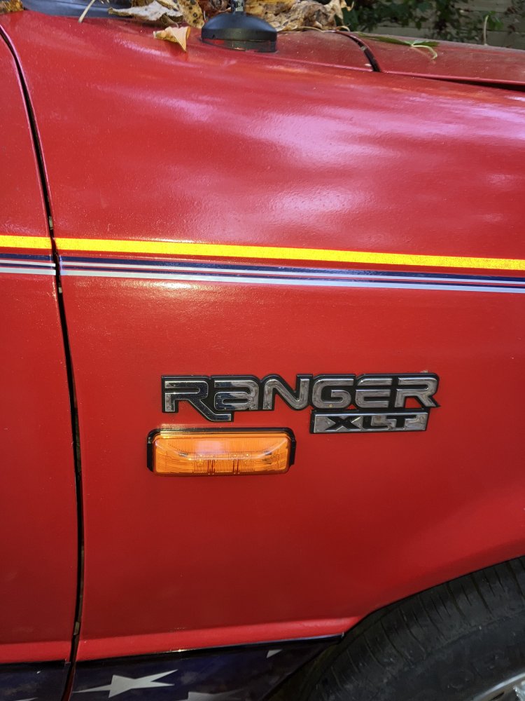

I wanted a red, white and blue reflective, and I had the 3M tape. When I put it on, the white was really bright white, and the white in the flag decal is actually almost gray. Ditto on the blue, just didn’t match. I finally came up with this.
I used the classic double pinstripe where one is a little bit wider, put the blue on, and then I inverted the silver. I overlapped them, so the wider stripes are top and bottom, and the skinny stripes are in the middle, but they alternate. And if you look close, there is a red reflective stripe just above the blue and silver. The red just about disappears in the daytime, but it shows well at night.
It looks yellow in the picture (from the flash), but it’s actually a bright red and the right color.
I’m still having a problem with the silver sticking on the front 6 inches of the passenger door. I cleaned the door with 409, I cleaned the door with alcohol, and I changed the tape twice. I’m going to try warming it up with the heat gun tomorrow, and if that doesn’t work, I’m gonna try some different kind of solvent like Acetone. If that doesn’t work, I’ll use pop rivets.
I’m stumped.
Won’t stick on that 10” of passenger door…
You ever use silicone spray on anything near it? I've heard NOTHING sticks to it and also nothing washes it off...
That is a stumper.
Does the tape still feel "sticky"? The only thing that I can think of, like scotts90ranger, is that something like silicone got on that area.
I'm wondering if you can mask a strip where the tape will, and carefully sand that strip with very fine sandpaper, lay new tape then come back with a little wax to gloss up any exposed paint (like between the stripes).
I don't know if any good solvent, like Acrysol, would remove whatever it is that's killing the pin stripe adhesion. It may be worth a try.
I pushed the loose stuff back on, and then I warmed the tape and the fender with a heat gun, hoping to activate the glue. All that happened was the tape shrunk like a heat shrink tube.
So I cleaned it with 97% isopropyl alcohol (which should remove any silicone), heated the spot on the truck with a heat gun, and stuck new tape down while it was warm.
Damnest thing I’ve ever seen. But I will not be defeated.
I pulled the tape off, cleaned that spot with alcohol again. Then I cleaned it with acetone (very lightly, since it actually started to take the red paint off). I was going to wrap a tiny piece of emery paper over the tip of the screwdriver and etch the track, but since the acetone removed some of the paint, I figured whatever was on it was gone to.
I heated it up with the heat gun, and I put new tape on it. Then I put the tiniest bit of superglue on the forward end of the tape at the edge of the door.
More to follow. (I could’ve built another truck by now.)
That's really odd; it looks like the blue is doing OK.
