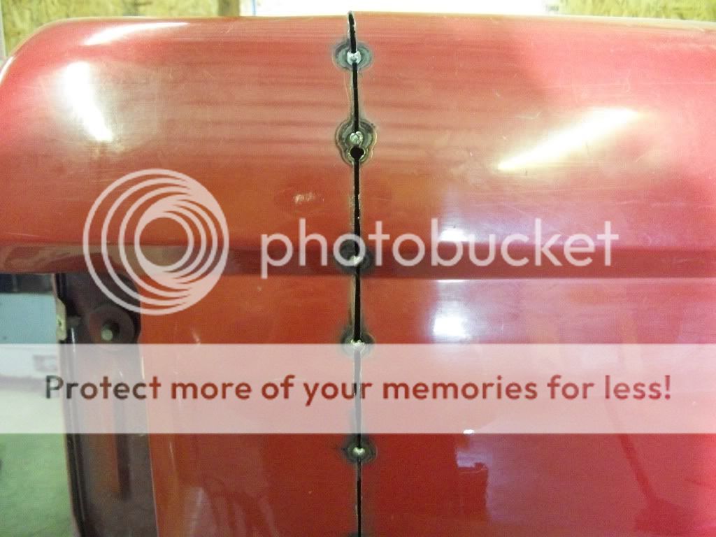

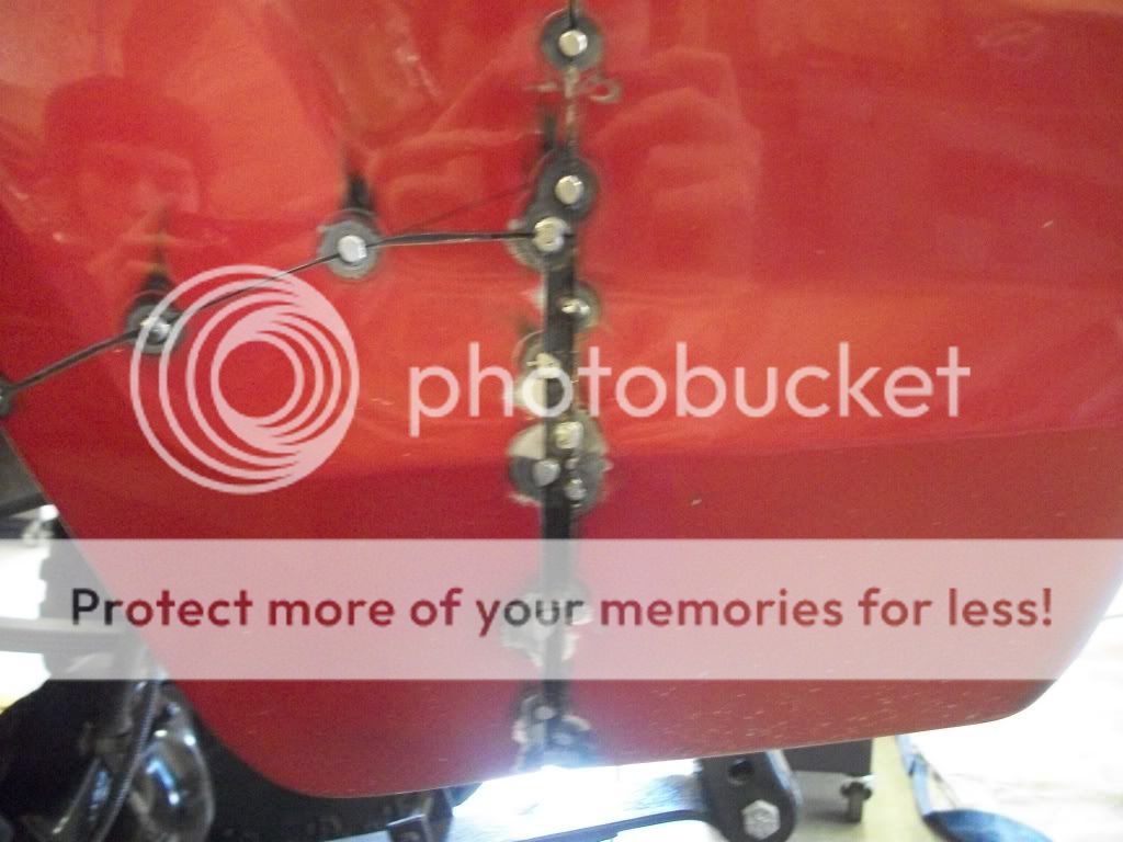

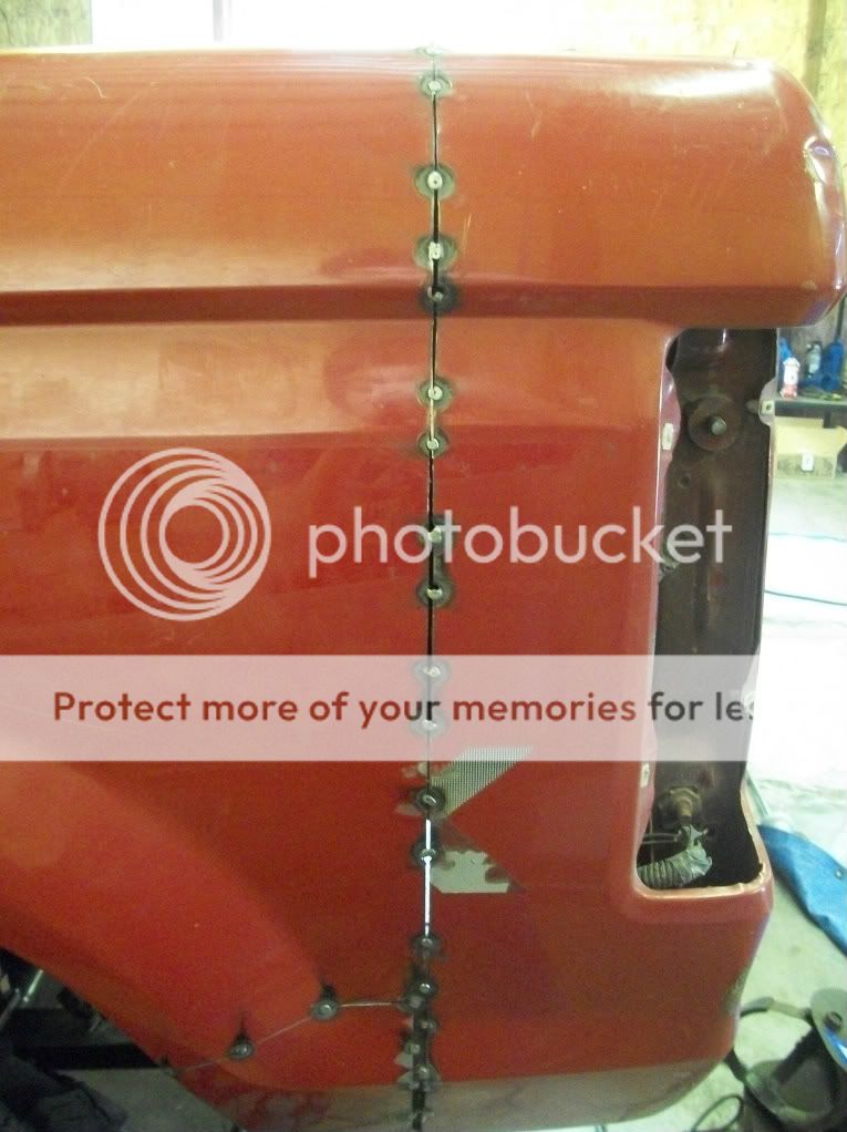

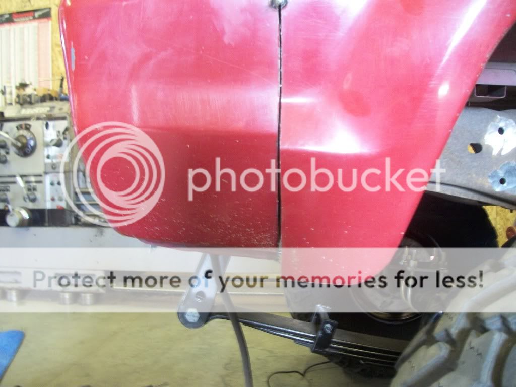

The bed was the main priority this weekend.
We were worried about the lines on the bottom of the bed.
So, a chunk of the bottom came off to move the lines so they line up. It turned out pretty well. Yes, I see me in the reflection too. :icon_rofl:
The top line lined up perfectly.

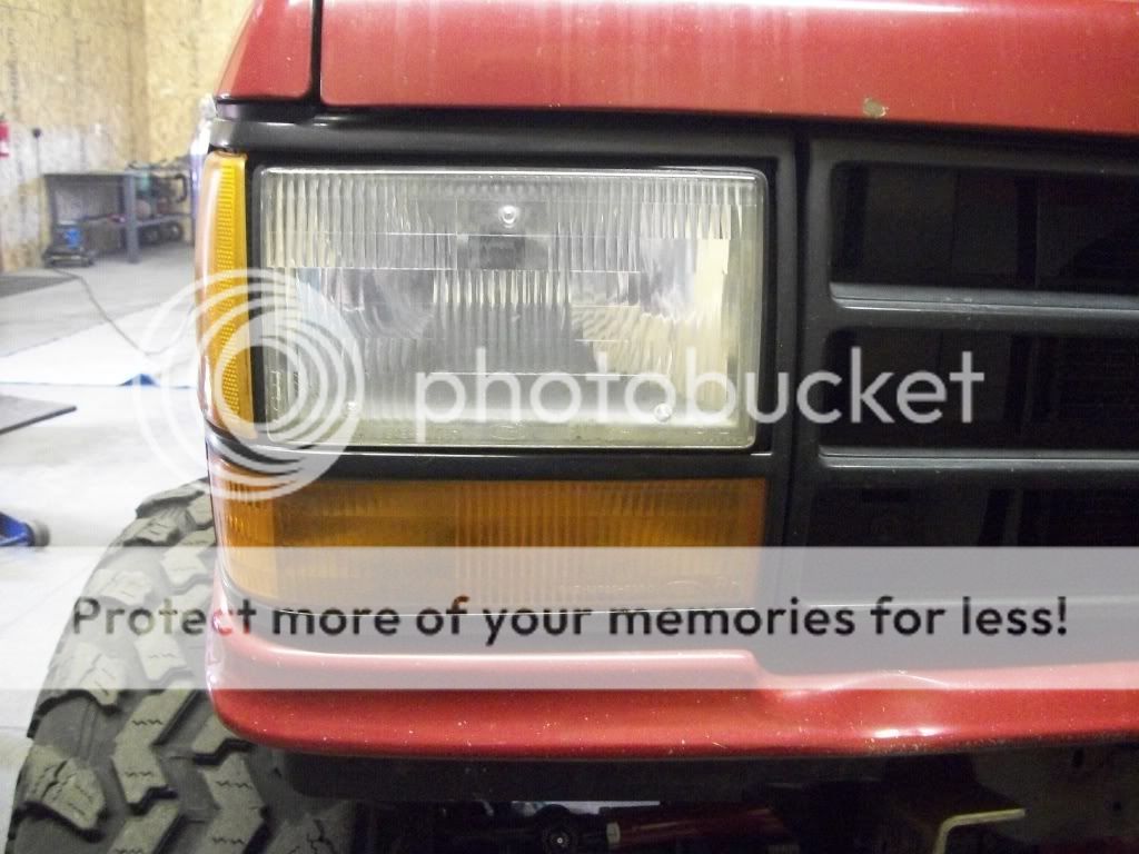

Also, just a misc thing, got the healights polished and cleaned because they were really yellow.

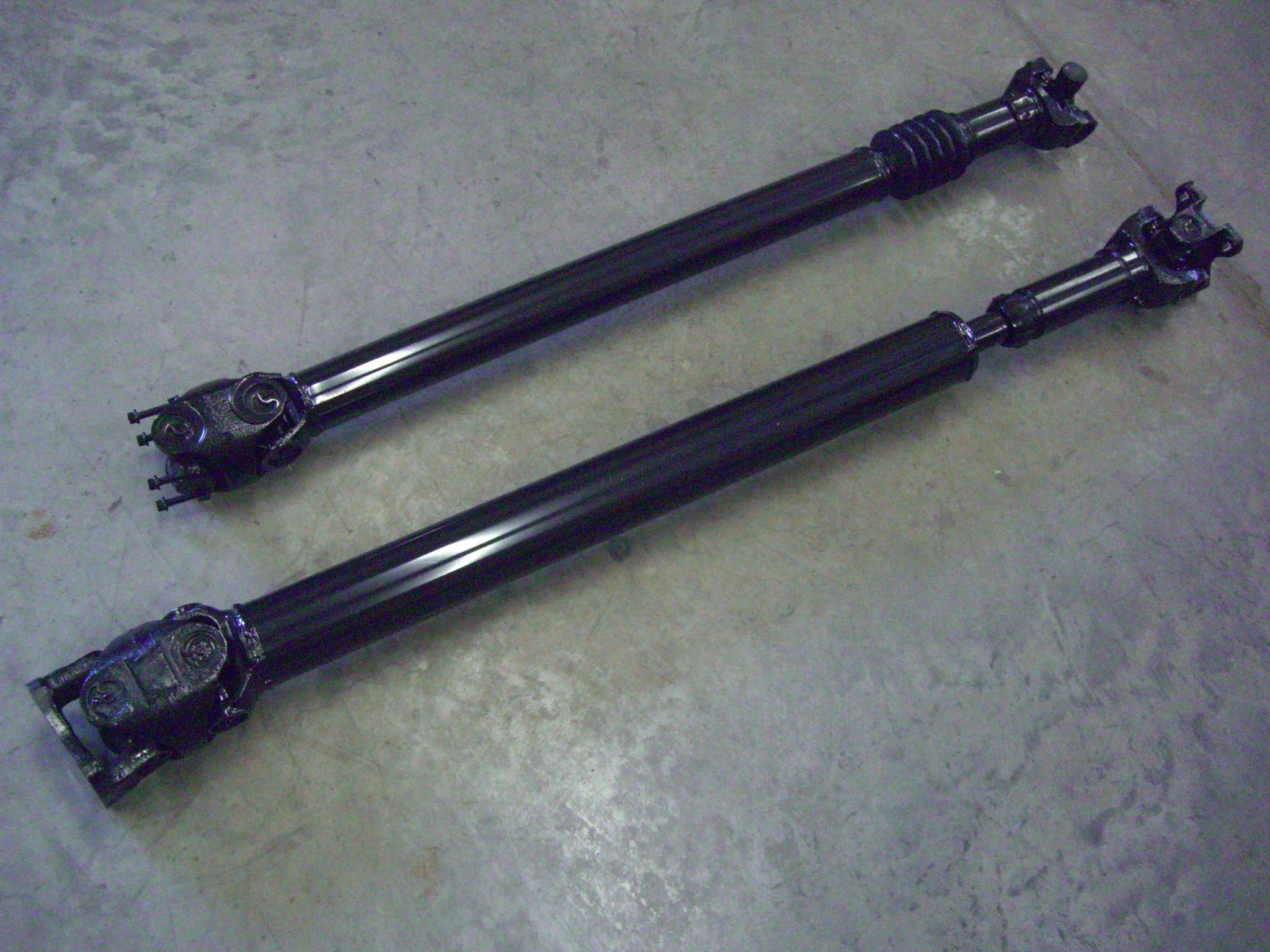

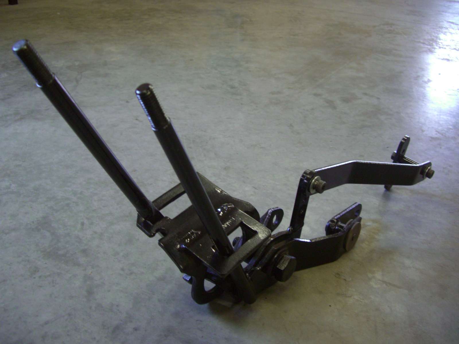

Drivelines are done and ready to go in. 1310 joints on all but the case end of the front. I hope to upgrade it when I can gather the parts.

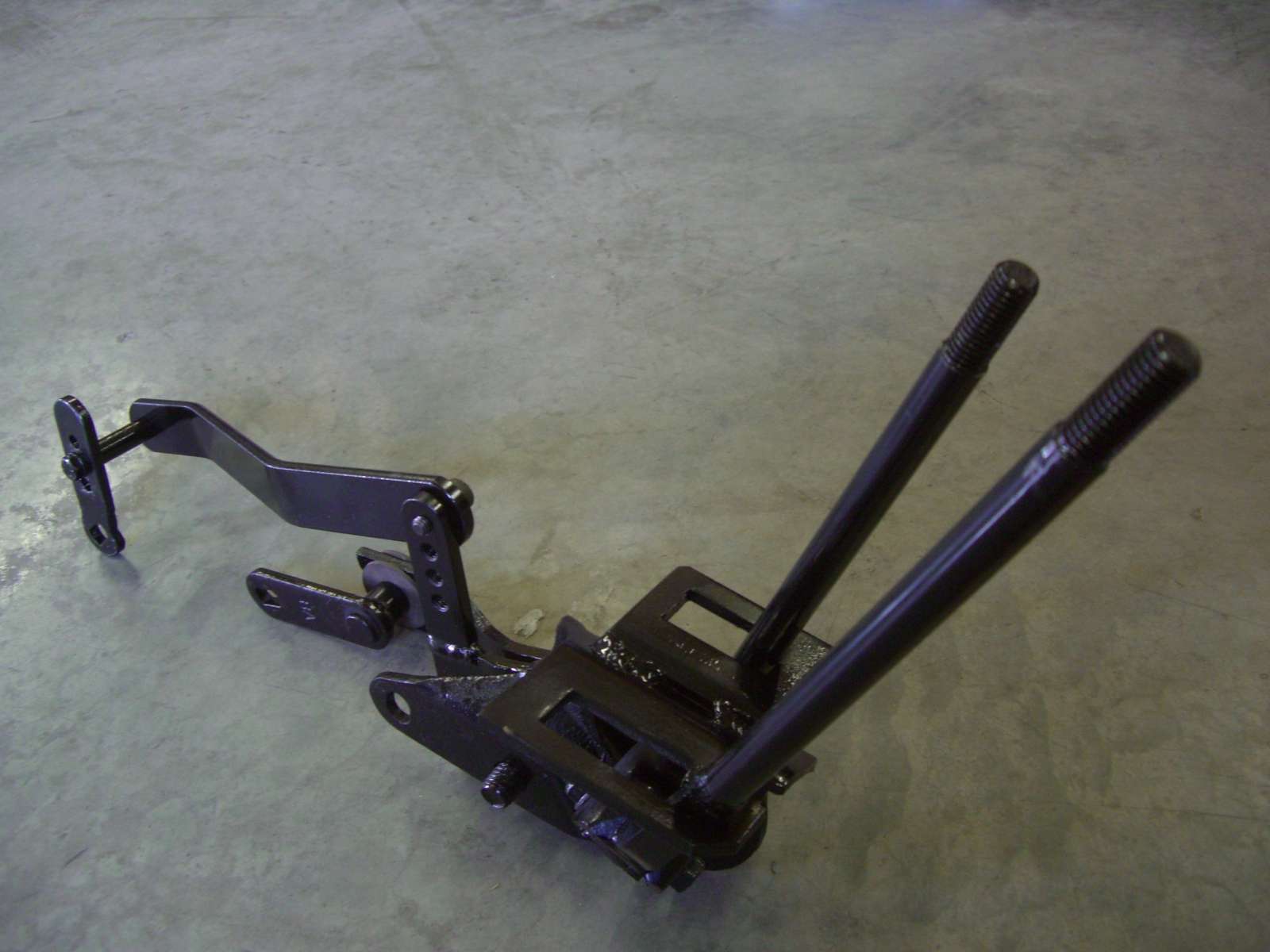

Custom made TC shifters for the stock case and doubler. I combined parts from 2 stock shifters using 1 stock pivot point. They will tuck in nicely to each other and use a Jeep type twinstick boot.
