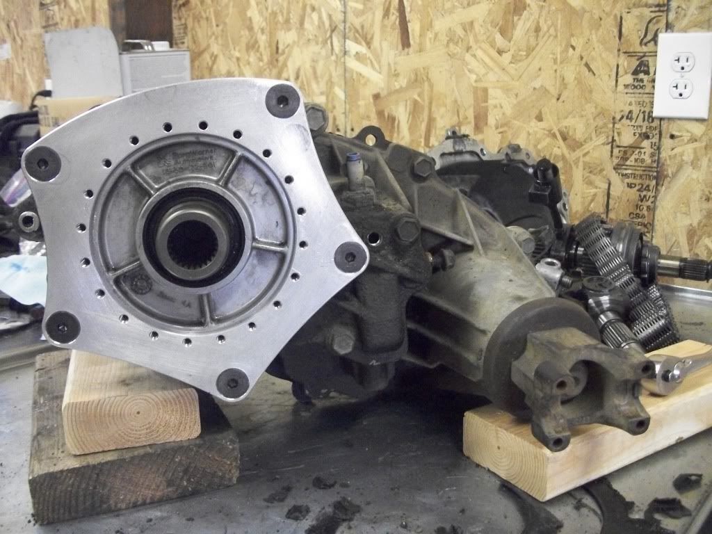

Today we were working on the doubler and rear axle.
We got the rear all put together, shafts in, brakes and outers on, gears in, springs hung, all that's left to do is figure out the angle of the drive line and we can weld the spring pads onto the housing.
Dad had a good idea of putting some supports where the spring hangers go, so they have no way of folding the frame up.
Also got the tansfer case out and got one of the adapter plates put on.
Looks like some sort of snake, alien thing starin' atcha don't it? :shok::thefinger:

Update 3/25/12
Update 3/25/12

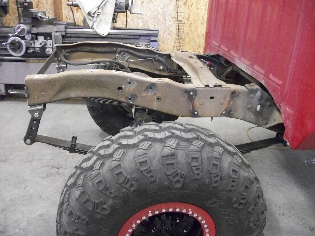

Hacked the rest of the frame off.
Got the bed bobbed in the back.
Drum roll please....... :icon_welder:
Mocked up. Whatcha guys think? Tall enough, bed short enough? :thefinger:
