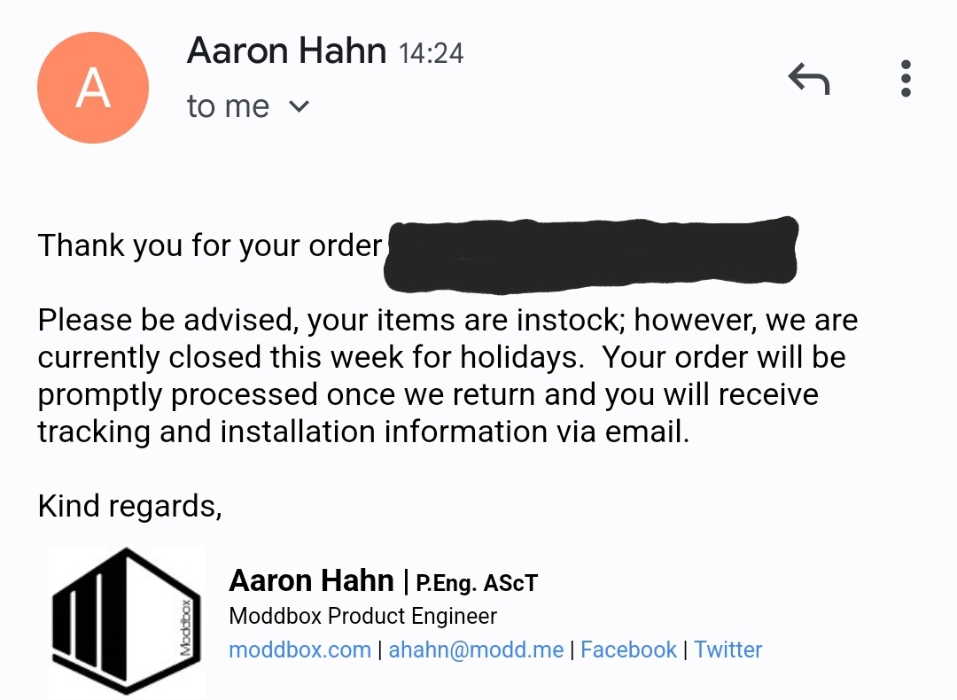

July 1st, Canada Day, although a week off...............nice place to work, lol
Like 4th of July in the states
Today was actually "Bring your 2.9l to work day"
But the "to work" part was the problem, so its being changed to "Bring your 2.9l to work-on day"
Just makes more sense
Sounds like it's a very small operation, like the one I work for. The boss was on holidays for the last week but myself and one and a half other guys worked. Perhaps it's even smaller and it's a one man operation.
