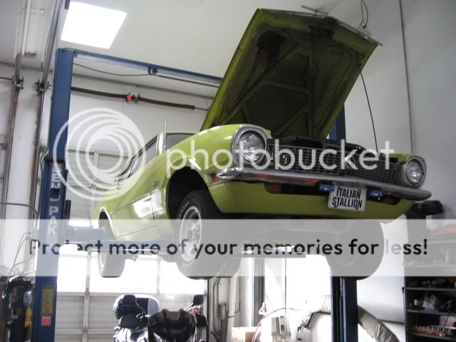

How it sits as of yesterday, stripped of motor and tranny.

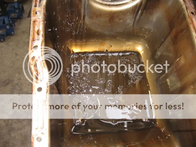

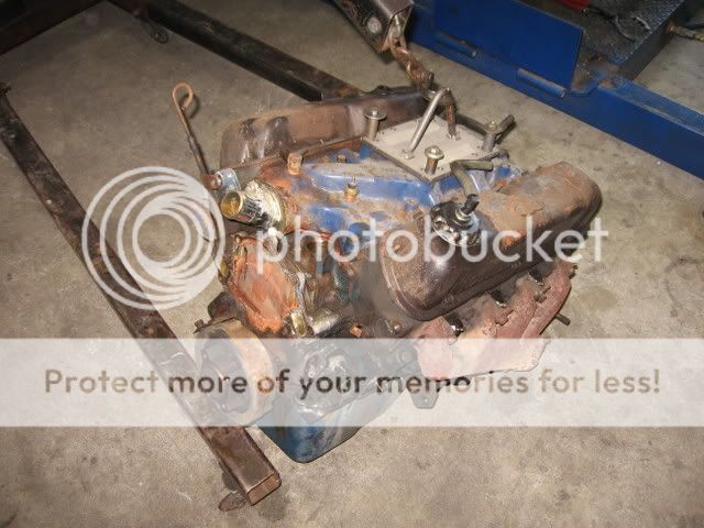

The stock offending oil-burning small block removed.
Why it burnt so much oil.

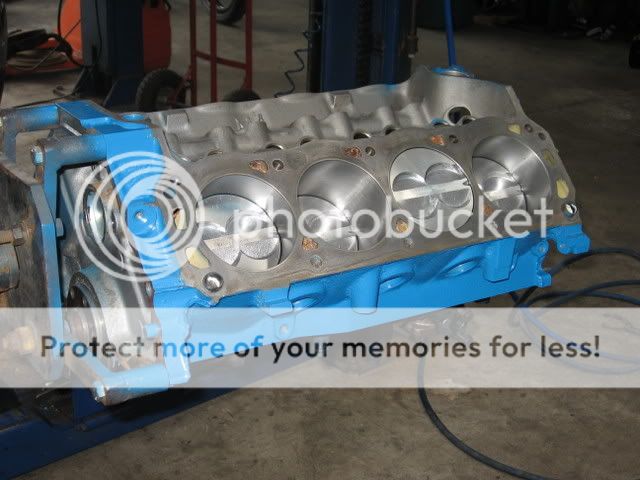

Rebuilt short block ready for some goodies.

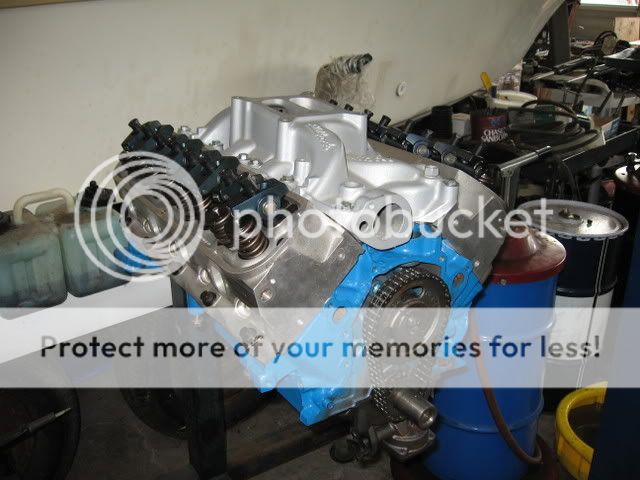

Mostly assembled longblock waiting on pushrods and few other small things.

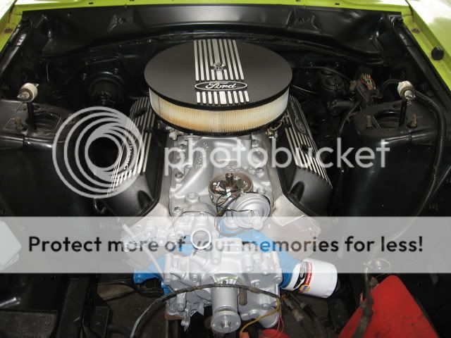

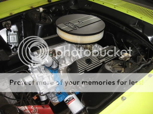

A little update. I broke my ankle and wasn't able to work on it for some time. I'm back on it now. Almost finished with it. Just have to bolt up the drive accesories, drop in the radiator, install the new shifter, add fluids, and a few other very minor things. Should be up and running in no time. :3gears:

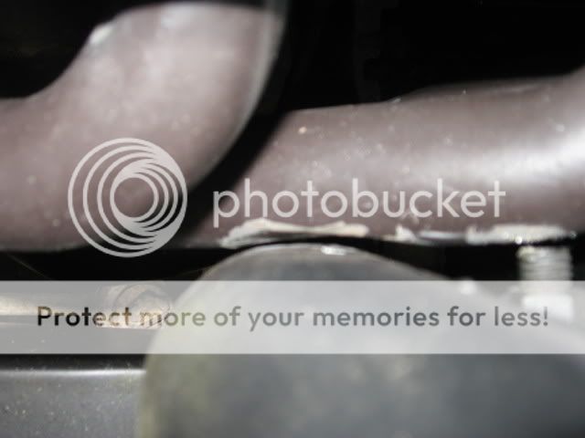

Cheap ass Summit headers needed a few swift hits with a hammer to fit correctly
WOW man, love the car,
I am insanely jealous of the lack of rust. My 75' Nova SS has cancerous rust of the underbelly.
I am also jealous/impressed at how clean under the hood is. jood gob!!
Digging the front liscene plate, hehe
Ha! That's the same block? Cleaned up nice Maverick!
Did you do anything (bumping up compression, head/rods, etc) with the motor?
Oh, and nice shavings. I guess the oil felt a lonely there in the pan!
No, it's not the same block. Here are the specs on it:
93 5.0 roller block
balanced rotating assembly
ARP rod bolts
Cloyes double roller timing set
TFS Twisted Wedge aluminum heads w/screw in studs and guideplates
Ford Motorsport 1.6 roller rockers
chromoly pushrods
Comp Cams XE262 grind 351W cam
Speed-Pro hypereutectic teflon coated pistons
Edelbrock Performer RPM intake w/600 CFM carb
I had the trans rebuilt (C4) with a shift kit and it has some where between a 2200-2400 RPM stall. The compression ratio is about a point lower than I would like (around 8.8-8.9:1) because the short block was built for a milder application with different heads. I still think it'll run pretty damn strong though, it's a fairly light car. Can't wait to drive it :headbang:
