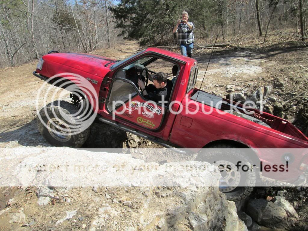

After Lunch, Bray D arrived at the park. His day hadn't started out well, and unfortunately, it didn't end well either. On the way down, he managed to lose a wiper blade during the rain storm, which delayed them quite a bit as they went looking for a replacement. It was nice to finally see the truck up close since it was his truck that inspired my build:
Group Shot:

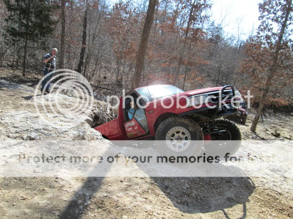

We left the entrance and ran part of Hill and Gully to the waterfall. Unfortunately, this is where Bray managed to frag a shaft and bend up his bed side pretty good (less than 45 minutes on the trails at this point). Made for some pretty shots though:
We all heard the nasty POP when the shaft went, but he was still able to crawl out of it (You hear the pieces of the U joint fall out in this vid):

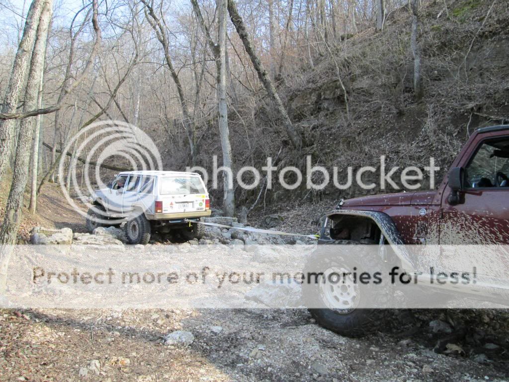

Hmmm I think you're stuck there bud:
Yup, he was! (only strap used today):

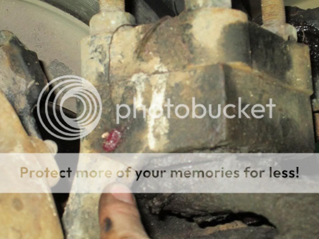

-And the biggie:
That's a massive crack on my drivers side knuckle (the picture makes it look like a rusty crack, I assure you its fresh). Apparently I drove 2.5 hours home on curvy back roads and interstate with the thing cracked like that.
Yikes!
So it looks like it’s possible to crack the Ford knuckles without hydro assist on them. I am still surprised at that since I don’t believe that I hit that side hard enough to damage it like I have. I’ve got a set of Reid Knuckles on the way so I hope to be back in business soon.
