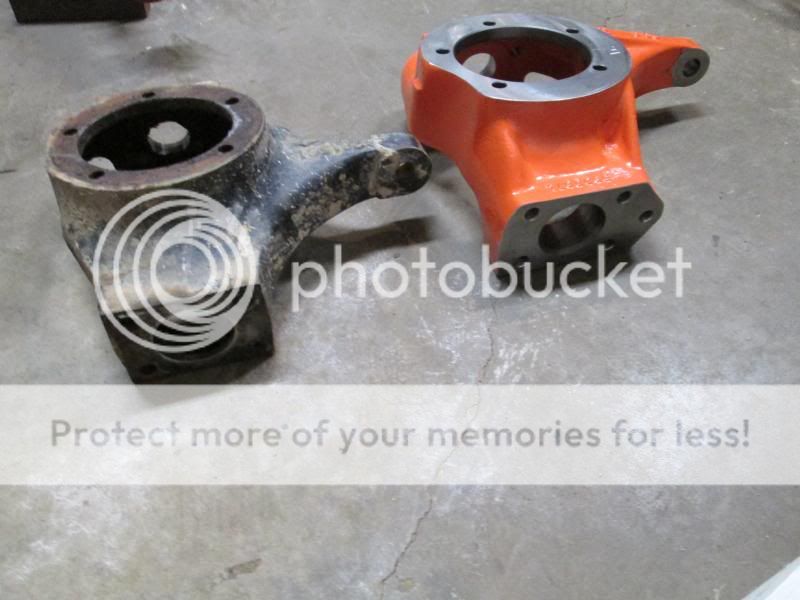

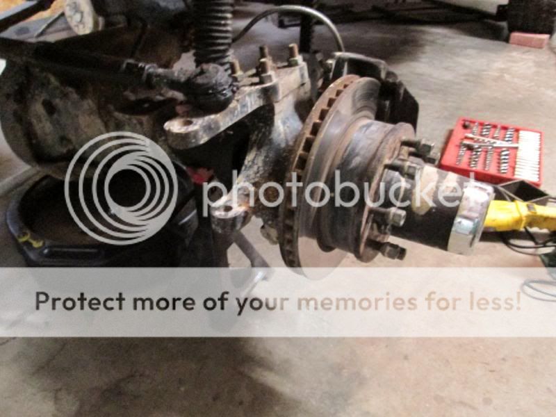

Reid Knuckle Upgrade:
After doing this to the stock Ford Knuckle:

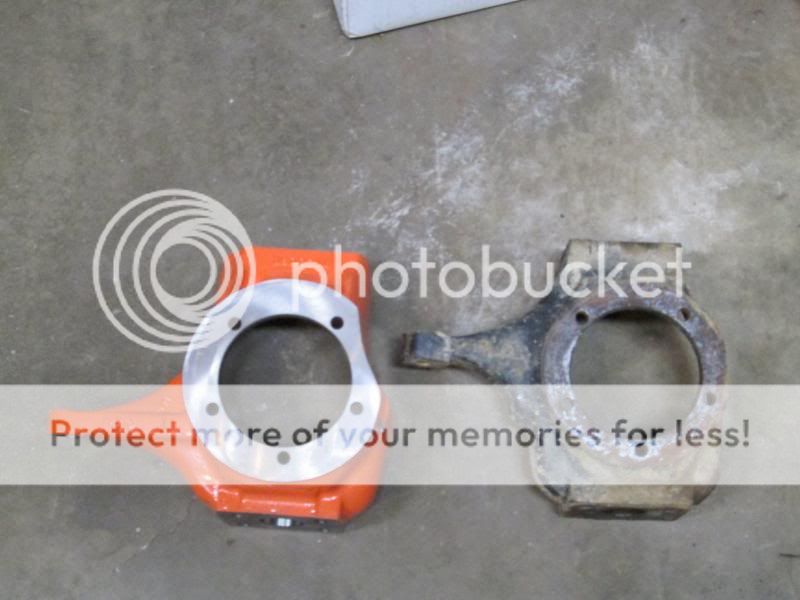

So I pulled this off:

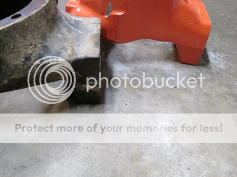

Slapped it next to the new knuckles (quite a bit more beefy):

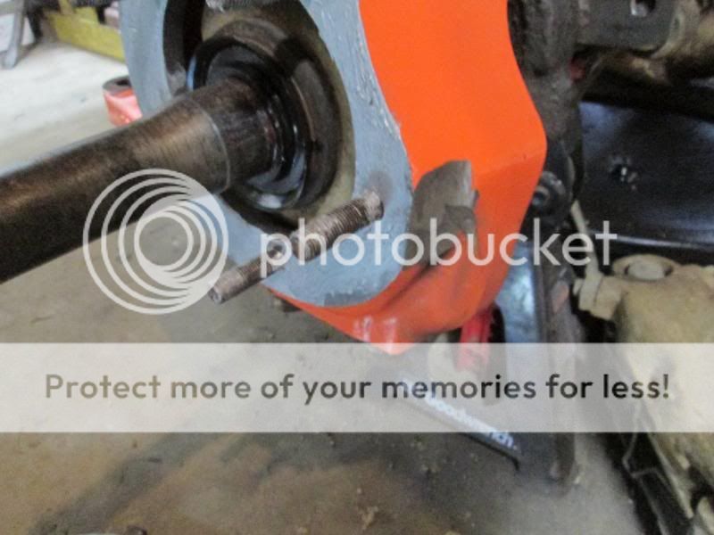

I wound up having to grind on my new knuckle to make the brake bracket fit correctly. Kind of disappointed that I had to do that, but not a big deal to get it done:
One side done:
Now everything is much happier! The Reid knuckles use a lower point for where the tie rod sits (stock Chevy location) which will make it much easier to get the hydro assist done now (once I have the cash to do so).
Its hard to tell, but I think the Reid's also correct the camber issue that the Ford knuckles had. I haven't measured it, but by the eye, it looks like it might have corrected the 2° camber I had with the stock knuckles. All and all, I'm happy with them and expect them to last a long time.

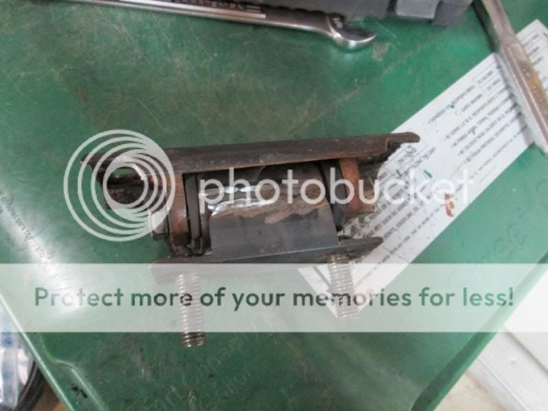

On the last trip out, I managed to kill another transmission mount. This mount was a hacked up stock mount with poly bushing in place of the stock rubber. Since I might have been a wee bit drunk when I made this mount died, it help up for quite a long time, so in keeping with the theme....
Dead mount:

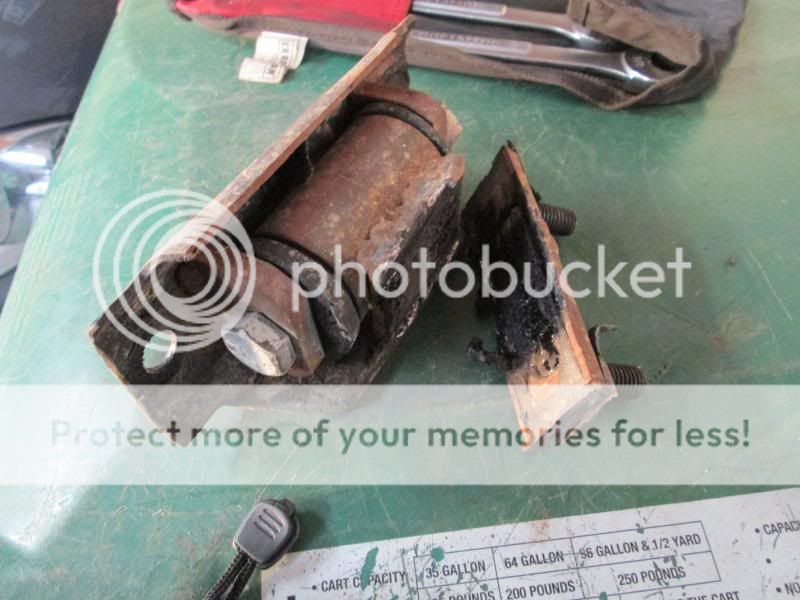

Version 3.0:
I've got a feeling this one will hold up a bit longer

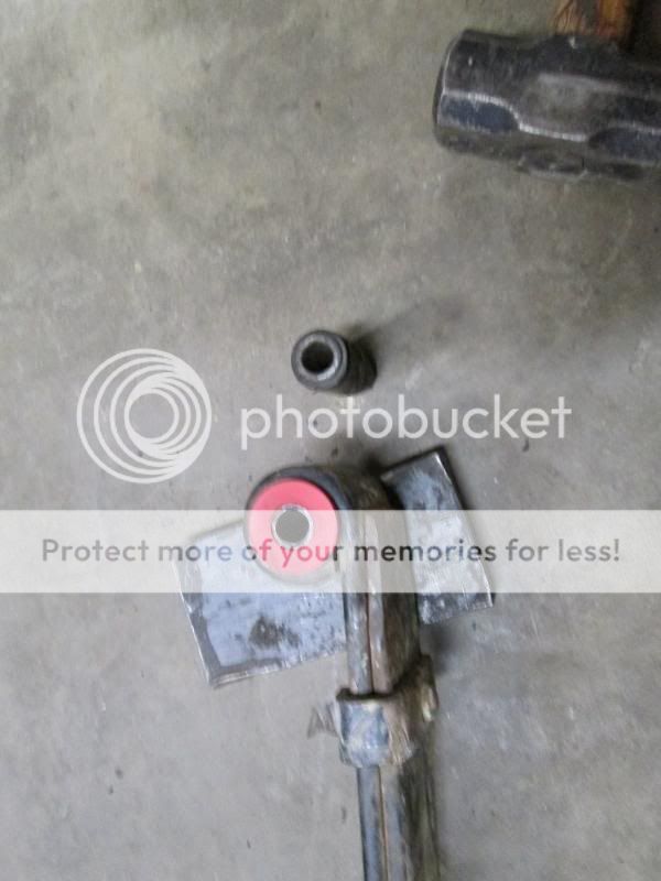

In other news, I got the front bushing swapped out for new Poly bushings:
The rubber bushings were so shot that I was able to push the rubber bits out with my fingers. There is a definitely improvement in ride and steering feel now. I am bummed that the new bushings started squeaking on day 2 of driving on them, even though I greased the crap out of them.
