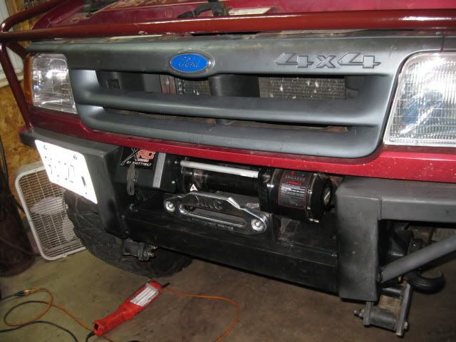

Winch Mounting
I’ve been wheeling for some time without a winch now, never really thought I needed one (probably still don’t). But the last time I rode along at Interlake gave me a new perspective. Long story short, it was very wet from melting snow, throw in a very sideways XJ (leaning in an alarming direction), and you have yourself the makings of a situation where using a Highlift/come-a-long to recover some one just isn’t a good answer. Thankfully, there was one winch there that saved the day.
After that experience, I didn’t really have to think twice about how useful a winch can be on occasion. :icon_twisted:
So from the very git-go, I made sure that there was a space for a winch in the front of the Ranger. While not a high zoot one, I’ve heard quite a few good things about the Smitty Built winches, and the people that run them out here don’t seem to have any problems with them. If it dies on me, I’ll just swap it out for something better as it has the standard winch mounting pattern.

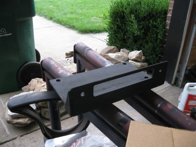

Because of how I compacted everything together, I had to get creative on how to get a fairlead mount in there. While skimming through a magazine, there were ads for those receiver mounted winch plates. I took that idea (less the receiver mount) and applied it to my own application.
Playing with the iron worker/mill at work got me the base parts to work with:
Test fit:
Welded/Painted:
Sandwich that fairlead mount between the winch and the winch mount got me this:
All bolted down:
And under cover:
This project was way over due, I was getting very tired of moving that stupid winch all around the garage as I worked on things..
Really simple yet a really good job, its nice and tucked up in there
now just need to post some pics using it (or wheelin in general).
i like it.
next bumper i build is gonna be a tight hidden winch build. but i love my bumper now on the b2. on a newer ranger like yours, i like the tight tucked look
i like it.
Thanks! I thought about tucking it up further (cutting out the front facia and grill) but it didn't really gain me any more clearance with those long shackels haning out there. It should be safe sitting there, especially after I get the stinger stuck on.

I really like the idea for the fairlead mount. I may have to steal that. I was just pondering what I was going to do to mount my fairlead, since I wouldn't be able to get my winch in place if I had a permanent mount. Nice work.
the mulch has been in the bed throughout the rain? i bet thats a wee heavy back there.
i also want to see more wheeling pics.
4.88's. the differences are so minimal on road. its like 300-500 rpm differences at 65 mph i think.. so why would you not want the lower gears????
Steal away! I farted around with a few different designs which mostly revolved around a removable plate that you would pull out to get the winch out. This simplified everything.

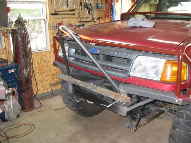

Stinger
I finally got around to finishing up the front bumper with the addition of a stinger. This took a little longer than I though it would to get it to look right, but I’m happy with the overall results.
Bent up a hoop and played around with the placement of it:
So much for being able to walk around the truck with the garage door closed (and it only fits in the garage one way now):
It was a little high, so I dropped it down some more and angled it back some:
Happy with that result, I started burning things on:
Painted up:
View from the drivers seat:
I’m pretty happy with how it turned out!
