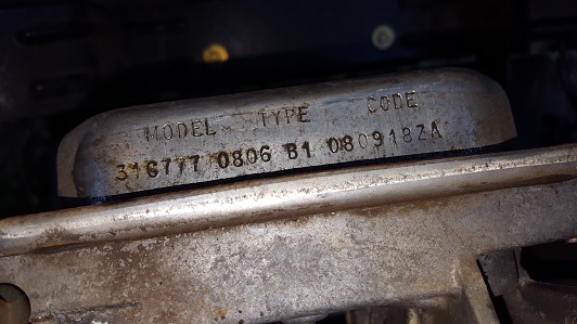

Should be Model Type and Code numbers on the fan housing. Pretty much all Briggs have them, might be actually stamped into the cover, might be on a tag/sticker.

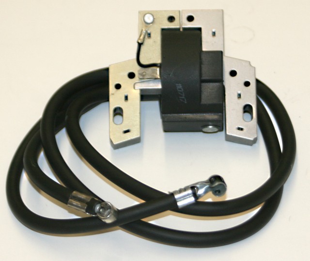

Most small engines have the plug wire(s) attached to the ignition model so to replace a wire you have to change the module. And there is a certain air gap you have to maintain between the flywheel and the module too.

will replacing the solenoid give me spark. just curious as to why they would stock those and not plug wires
Plug wires are part of the ignition module, just about every engine uses a different one.
There are only 3-4 popular solenoids, usually they cause no crank. You can jump them with a screwdriver to mow in a pinch but usually they don't effect running.

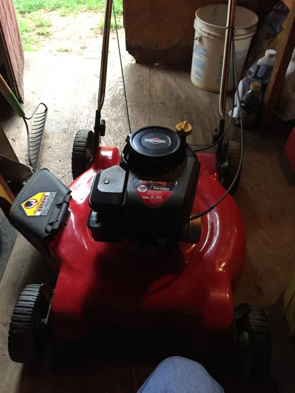

Here’s my mower... I replaced the original handle bar with a chrome one from an 80’s MTD mower. That added a throttle adjustment. I also added a taller oil dipstick.

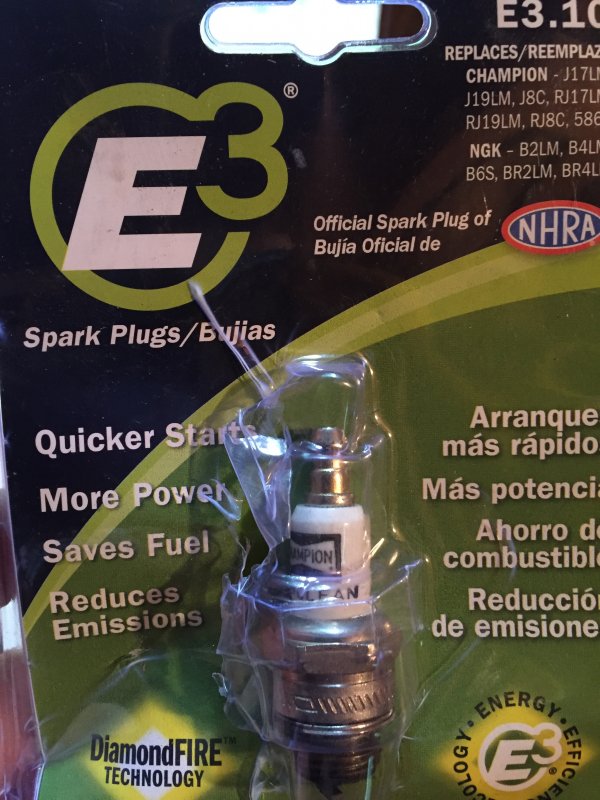

I put one of these spark plugs in and call me crazy, but the spark feels more aggressive to me. More power?? I put the old spark plug in the package. I always keep one spare.

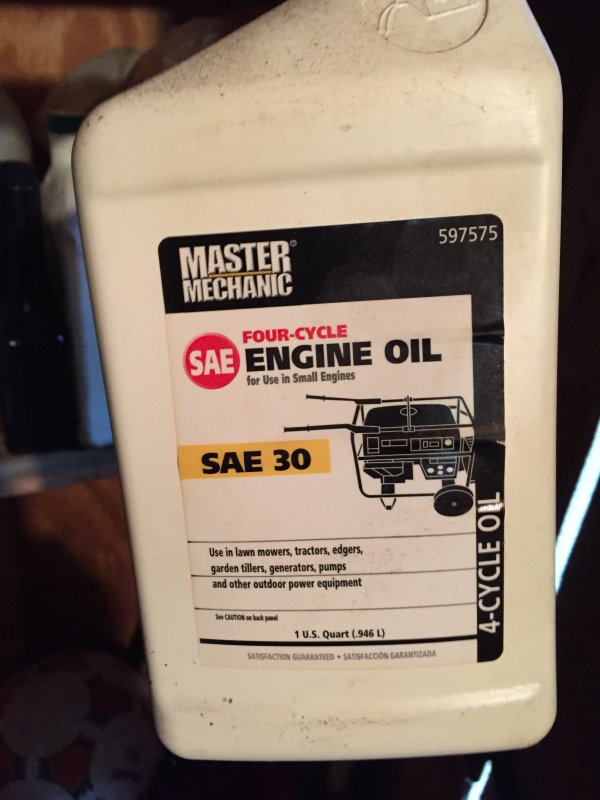

When I change the oil, I use this oil and a splash of zmax. I want to put a drain plug with a magnet in it, on this engine. But I don’t know where to get one this size. Anyone have a link to one?

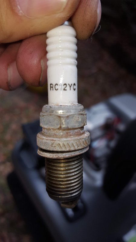

This was the original plug as far as I know, it was replaced back in Feb. with the exact brand and model. "RC12YC"

yes. no spark. like i posted. i could not find a replacement coil wire, only a generic solenoid from HD.
Intek 17.5hp
8BSXS.
build date 09 08
Is this enough info
As 85 said. Get the model and serial number from there. Usually run coil to flywheel gap around .009"
