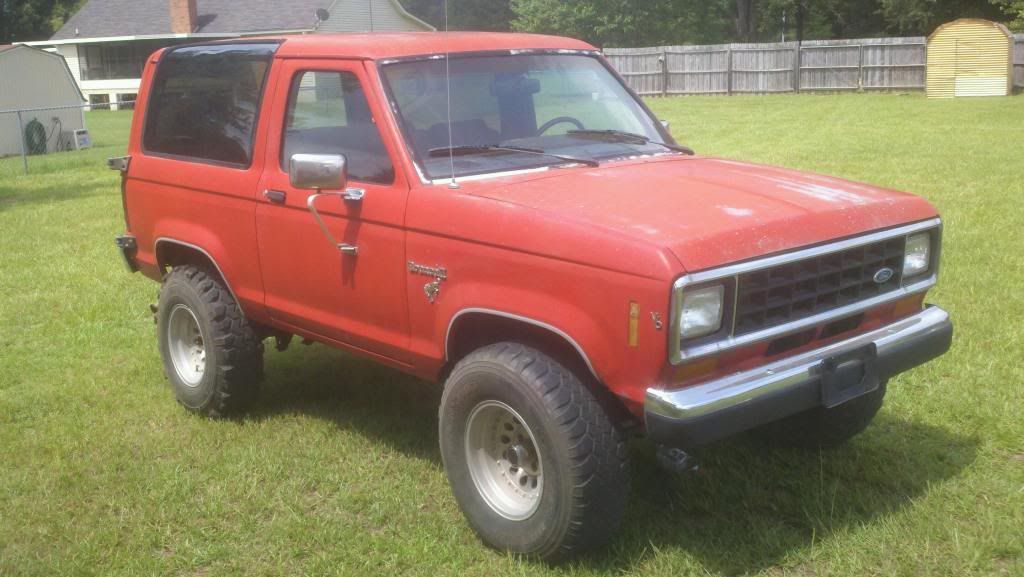

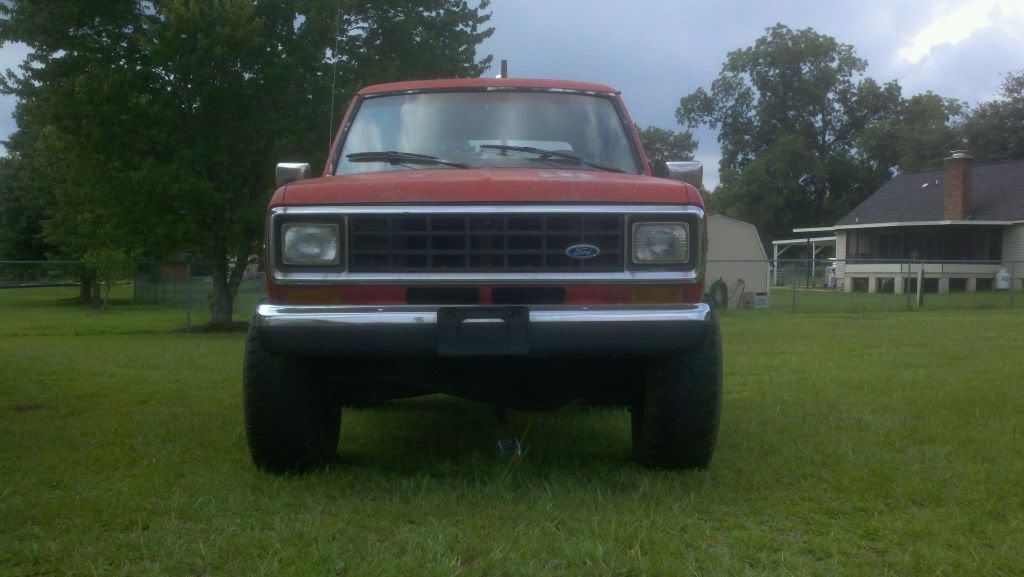

Well figured it was time to start one of these.
what i have to work with-
1986 Bronco II
2.9L v6
5-speed trans
ES transfer case
stock gears
stock axels
lifted by the PO

Once upon a hot as hell day in south GA July, I traded a Honda Recon that i snorkeled for this truck.
Reviving the Juice Box
PO brought it to the house and the next day i was screwing with the transfer case shift motor. It will turn when the low range button is pushed, I dont know about 4hi bc that button does not work, and i had no 2wd. Did i mention the truck wont move at all? Well i grew tired of messing with that and decided to try to turn the shaft manually. VISE GRIPS :icon_thumby: but the transfer case would not click into gear. it felt like the shaft was sprung. when i would turn it then let go, it would spin itself back to the original position.
i already really did not like the fact it was push button 4x4 and With all the searches I had done and everything i read i grew to dislike it even more. I decided to search for a manual t-case.
after calling every Junk Yard in my phone book (i believe there's about 12), I only found 3 that had 80's model B2's and rangers. and only 2 of the 3 had a manual transfer case. and only 1 of the two had everything i needed to do the swap. he wanted a little too much for my pocket and i decided to check the all expansive interweb.
Found a member on here who is parting out his truck, The_Dealer. Meeting up monday to get a t-case and everything i need to do the swap, 2 doors with all the guts and both panels, and a rear hatch with the glass that opens.
tuesday i should have the case in and be able to drive the truck for the first time. also i will start on those half doors. hopefully will have at least one of the half doors done by the next week.
well that's where i stand at the moment.
